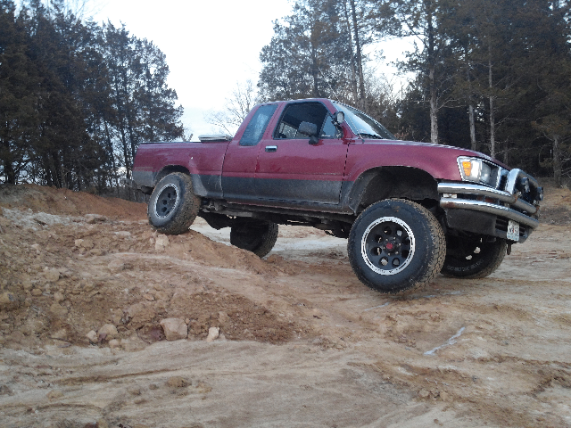

Mine are apparently 200lbs per inch, I just looked em up. It rides rough unloaded, but it done squat too far even with a heavy load. I actually had to spread my springs to get them in even with spring compressors, however my stock leaves were very worn and sagged. Here's some pics. As you can see its nowhere near the bump stops.

Still flexes halfway decent too tho
