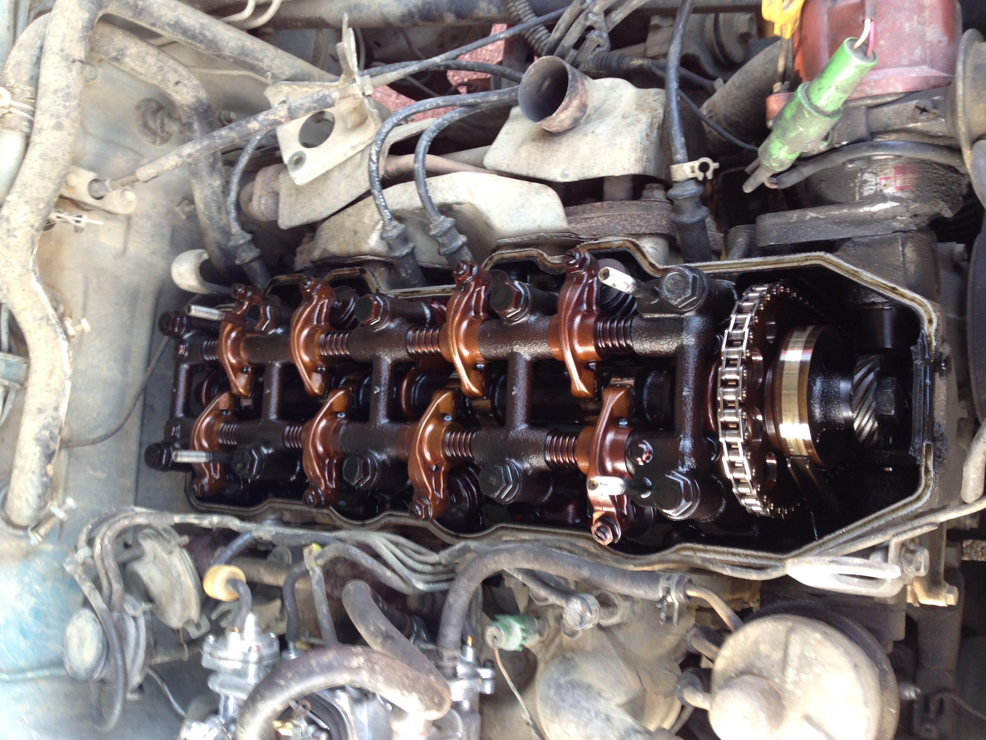

You can use the stock cam if its in good shape. If any doubt. Post a picture.

Two days ago I took off the valve/rocker cover to do an inspection, and to my surprise I found everything to be in (What I believe) to be great condition for never being touched.
Does everything look good to everyone else?

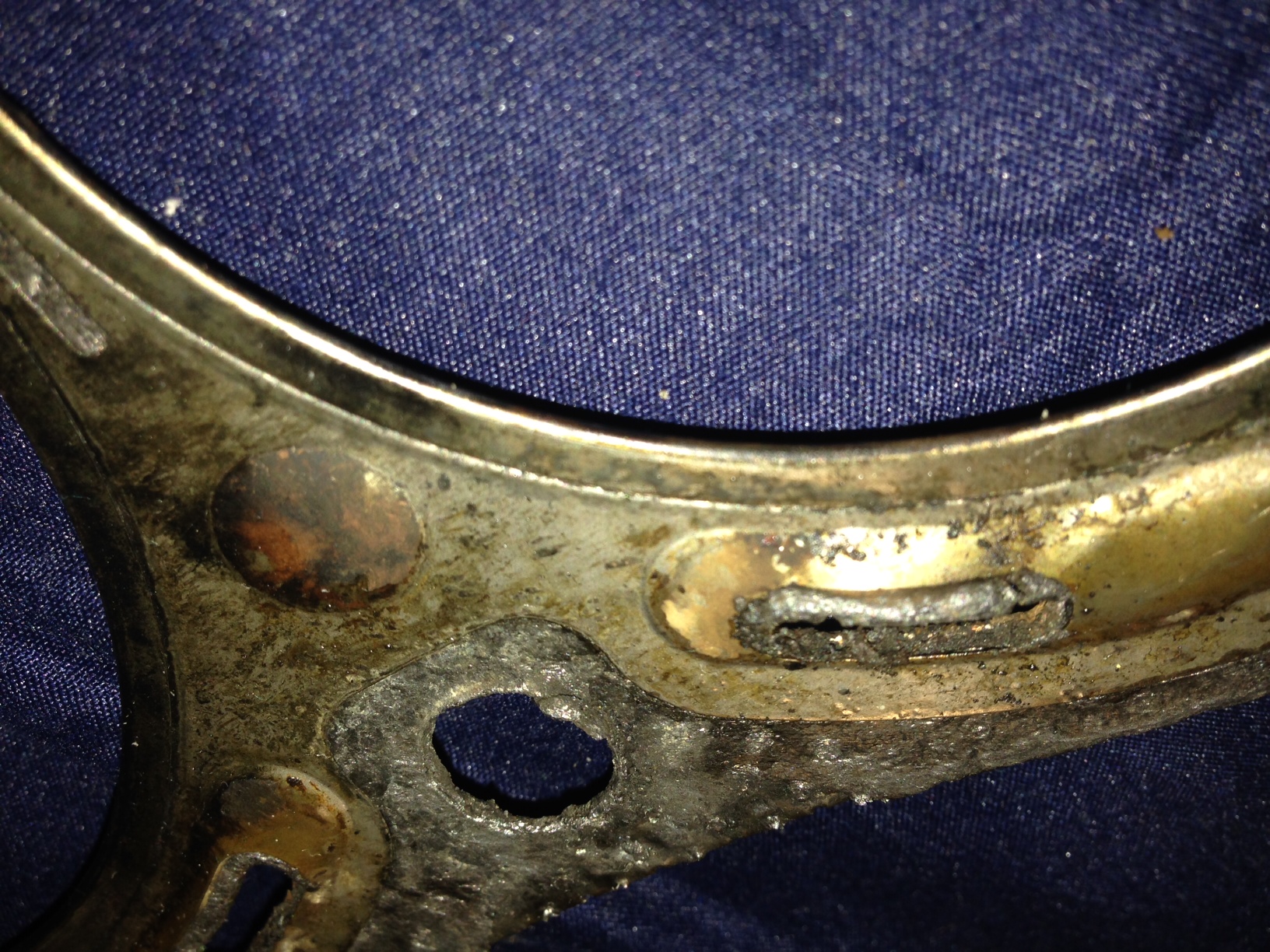

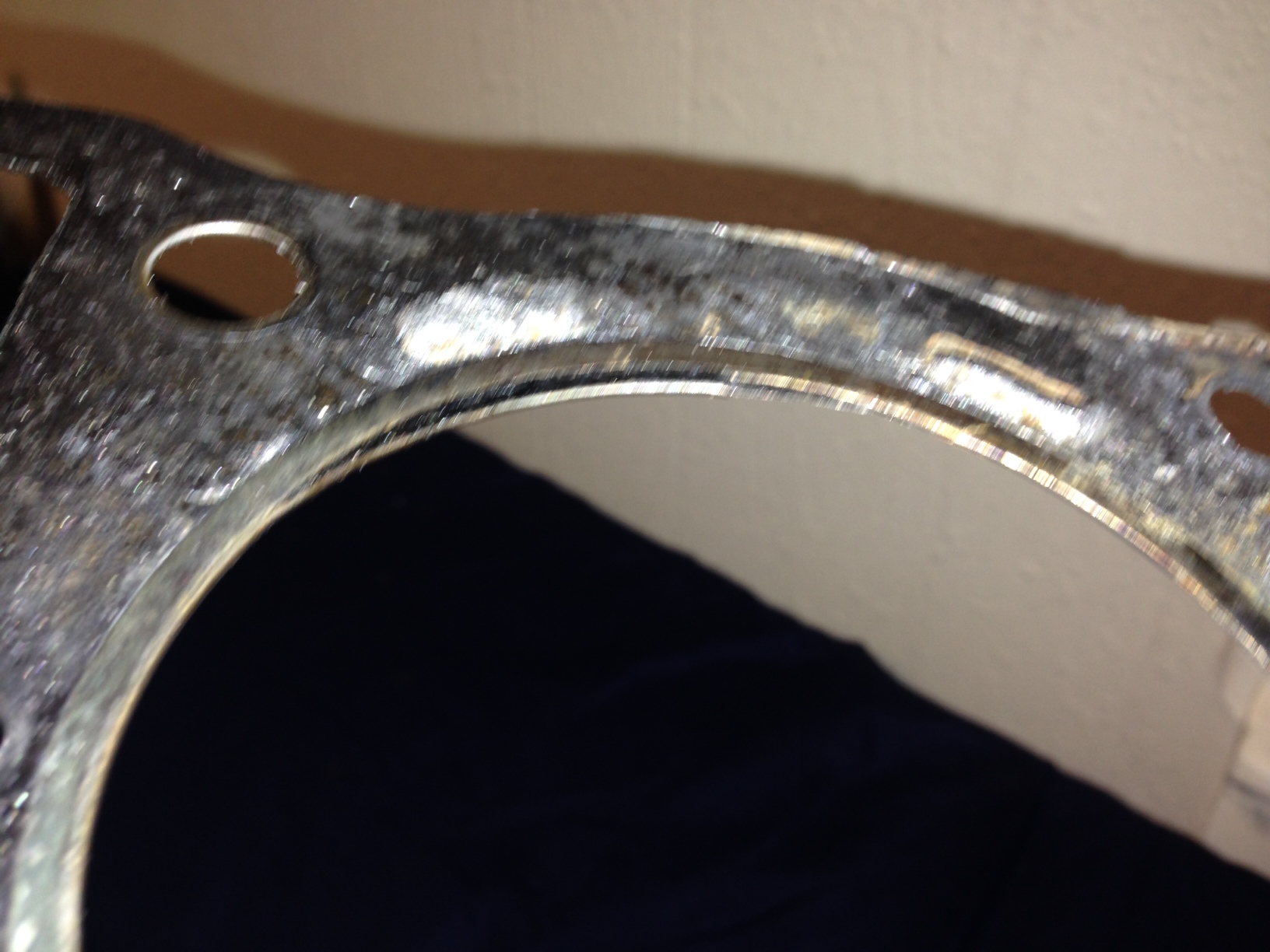

Alright so I got my head taken off and looking at my head gasket it is pretty ****ed up. I am wondering mainly what caused the bulges on the gasket. and if that one break (Around the piston hole) could be the causes of my exhaust air getting in my radiator
#36
Good on you for changing the head gasket. Bad on you for not running coolant. Its much more than expensive, funny coloured water and could be the reason this happened in the first place.
The coolant provides corrosion protection for the bare metal of the cooling system, lubrication for the water pump and seals/gaskets along with providing higher boiling points and freezing points.
I'm going to reccommend you change your water pump while your in there as those bearings are probally bad by this point.
