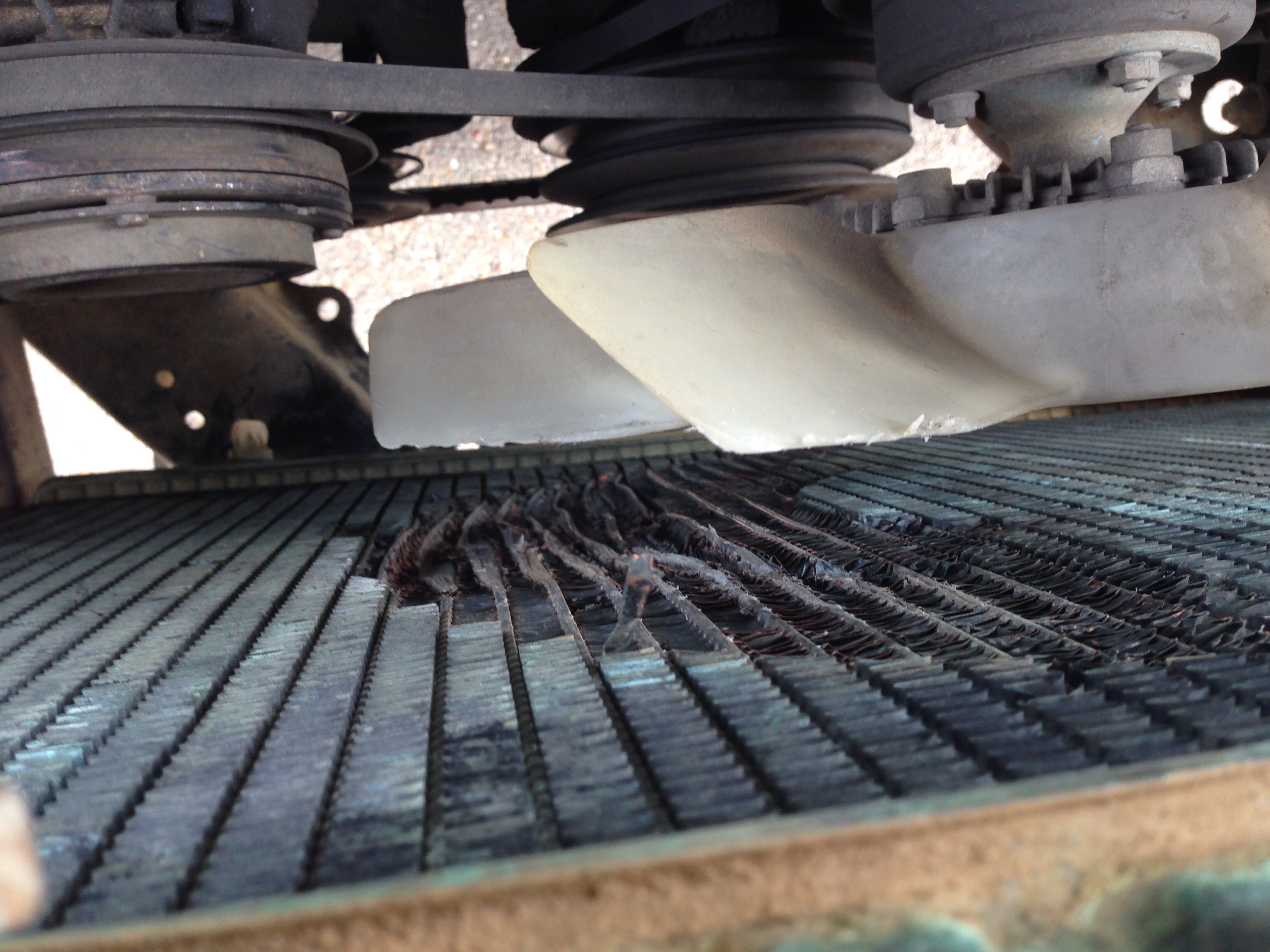

Well I found my problem, but I don't want to run it. I took the spark plugs out and of corse they were showing signs. Do these vehicles have a safety shut off?

no they don't have a safety shut off. they will go until something stops them.
pull oil cap look for chocolate milk. check rad for coolant, is it milky or oily? check along the head to block mating surfaces. anything coming out that shouldn't be?
your rad looks a little damaged, if u lost all your coolant you will overheat with a quickness. you might get lucky and just over heated because of the coolant loss and not done any other damage.

why did the fan kiss the radiator? is the radiator loose? water pump wobbly?

check engine mounts and tranny mount. if a mount breaks you can end up hitting the rad. also the fan clutch/water pump could have come loose or been improperly installed. u can fire the truck up for about 30 seconds/minute without doing any damage. i wouldn't run it any longer than that tho, doesn't take long to warm up

First, find out how your fan took out your radiator.
Then proceed from there...

A couple bolts came off the radiator allowing it to fly back, I got the truck started and it runs fine. I just can't let it run long at all. My next step is to see if I blew a head gasket or not
