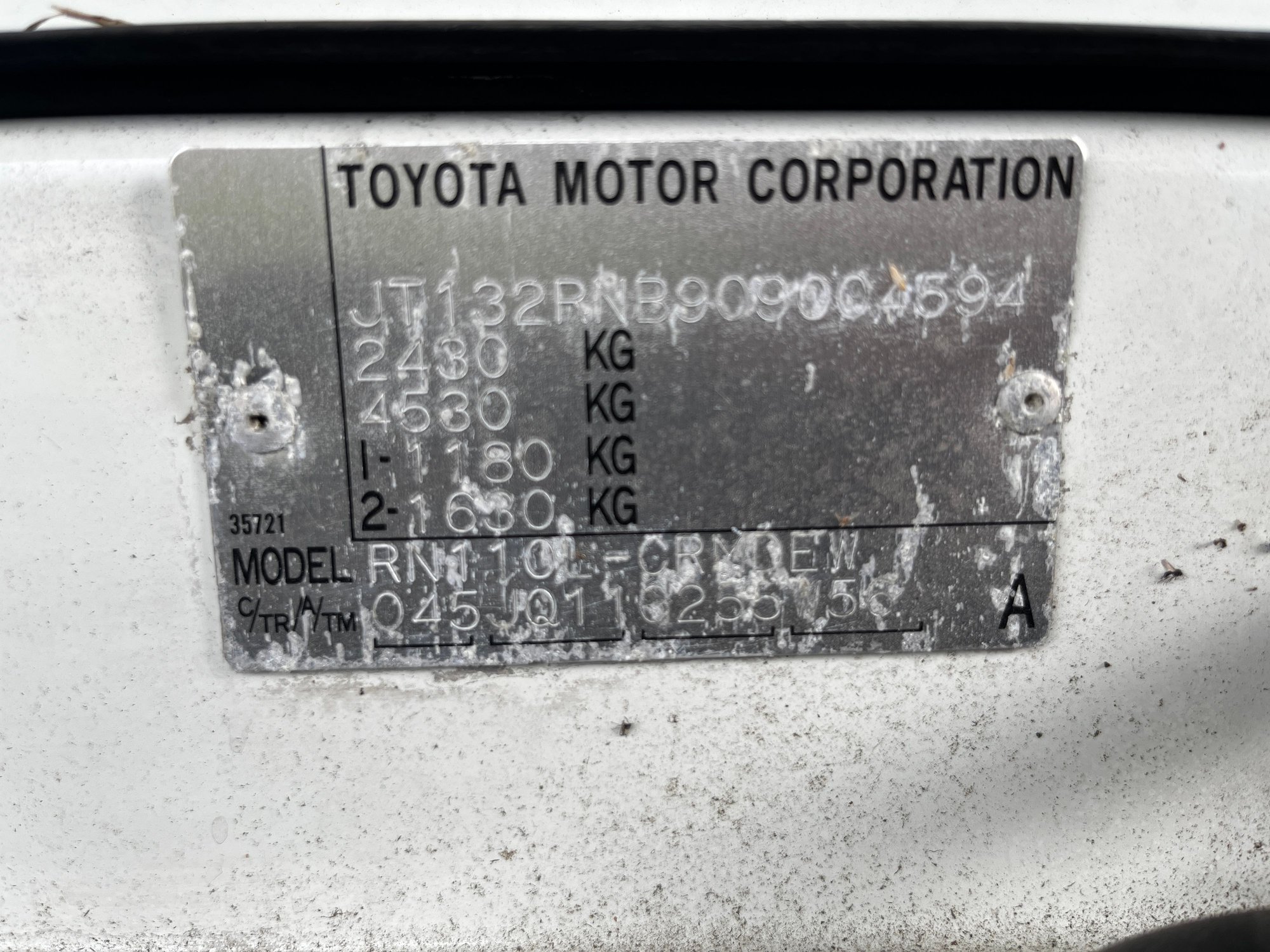

If you post the model # off that plate on the firewall, along with the production date off the door jam vin plate I can post schematics of the systems

The model# should be enough for now (Rn110L-CRMDEW). That’s useful to have, I’d record it somewhere.

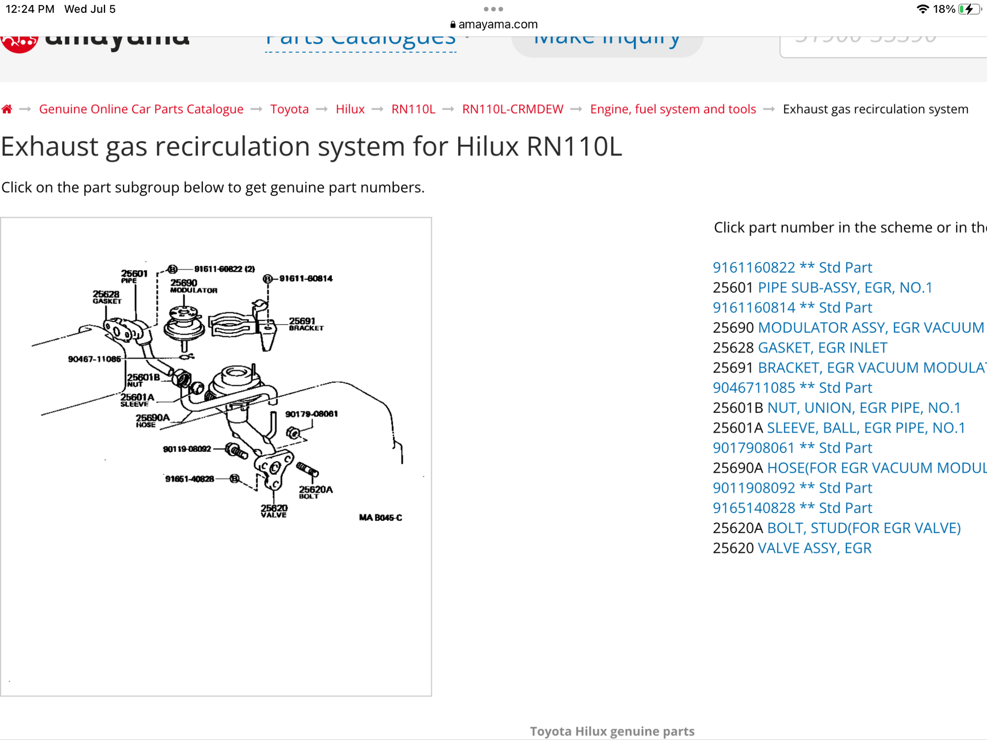

The first image is the EGR valve and modulator
Rhe second picture is the vacuum tubing, BVSV valve, and vacuum switches. The one part, 17630, goes to the power steering pump. It has nothing to do with EGR.

The vacuum tubing is easy, as long as you’re patient and methodical.
if you look at the vacuum ports on the throttle body you’ll see letters stamped next to each one. Now go look at your EGR modulator valve. You’ll see the same letters. So plug the one port from the throttle body into the rail. Follow that one rail to the end, then plug the mod valve with the matching letter.

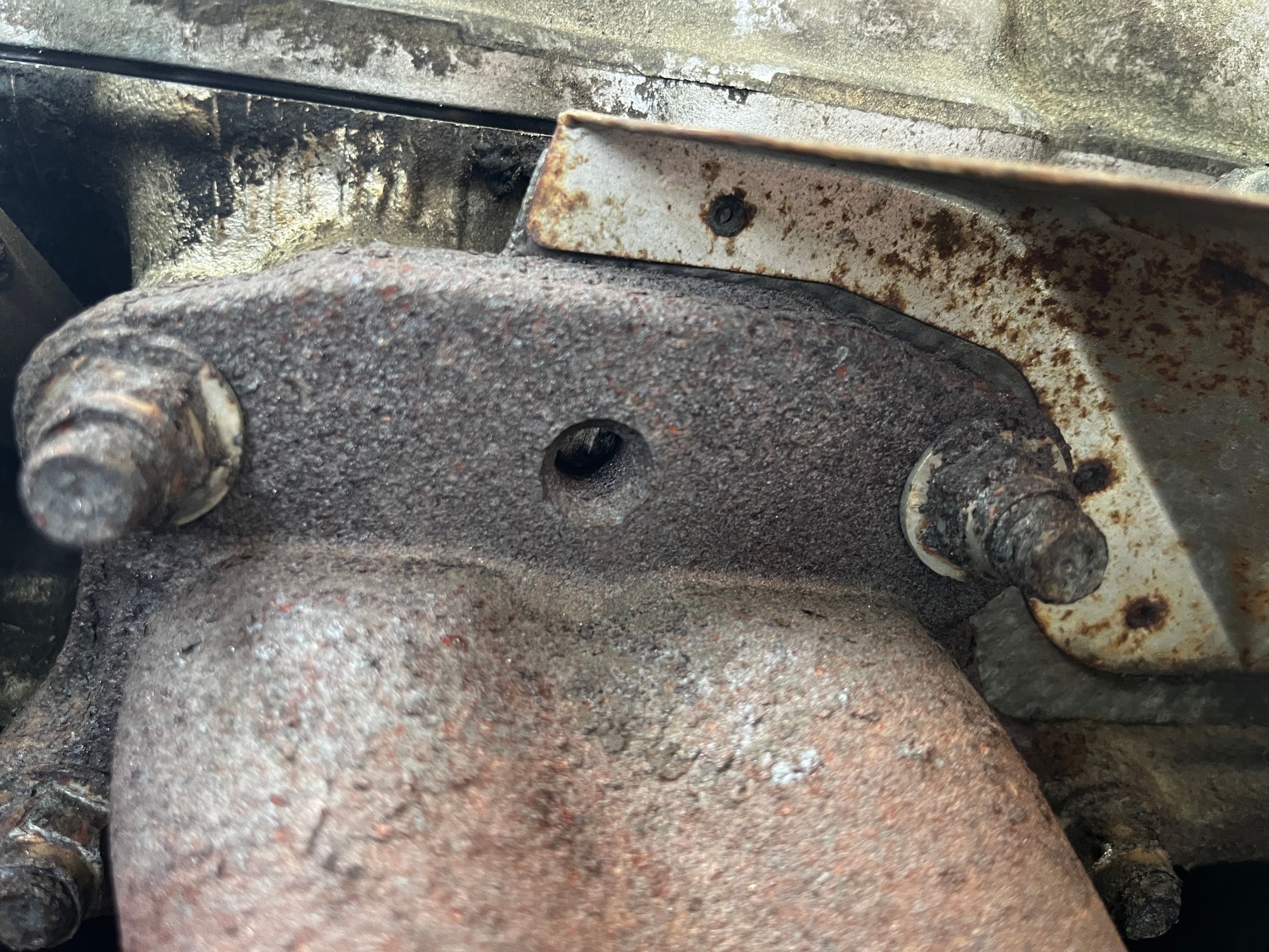

but by looking at my exhaust manifold, it doesn’t seem to have any holes for the air injection? Also if you look at the egr valve up to the far left it does not have the electronic contact that i have seen other people remove in videos when doing a delete…? Could my truck had been delivered without the air injection? The back plate for the egr is still present…🤔 the hole for the suction tube exists but it looks almost factory plugged, all though you can se that the tube is clearly missing below the air intake…

I show no air injection after 1994 for the 22RE

You can hook a vacuum pump up to the egr valve and see if it holds vacuum. The EGR valve was prone to get clogged with carbon. Soaking it with brake cleaner, then cleaning the passage with a pipe cleaner usually does the trick.

Thank you for the help! Got it confirmed by a mechanic that the 22re engines they used for the 95-97 hilux are slightly different and redesigned, and so the air suction system is removed✌🏻

There are a few sites that give very good parts diagrams like the ones I sent earlier. EPC-data.com and Amayama.com. Both are worth exploring. When searching for a part, if you have the oem part number you'll have much better search results; both in quantity and quality. Both use the model# to determine your application.
