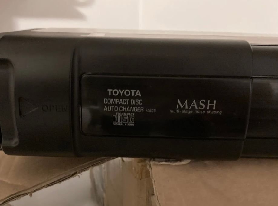

I got a NOS CD changer that was available as a dealer installed équipement for my 1993 Xtracab pickup. All the brackets and installation hardware is included but I can't find the mounting templates online (there's no installation manual included). I guess it either mounts under a seat or in the driver side storage under the backseat but I'd like to mount it in the most convenient place!

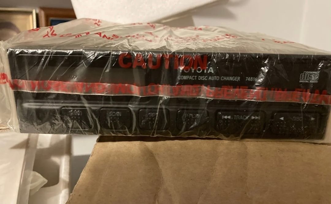

I used to have an aftermarket radio but when it failed I went back to the factory style radio with a working tape player (!) and a single CD player under it. It plays just as good or better than the aftermarket Clarion I had but it lacks the Bluetooth I was used to have... So at least I'll be able to play multiple CDs again as I did 20+ years ago!
The control unit in the picture above will replace the single CD player I currently have.

we use to install them on the back wall , or if it was an extra cab , in the cubby under the seat .

It's the Xtracab version. I was wondering exactly where it should be mounted? I guess it's not vertically as there's not enough space for that! There are many brackets and spacers included but I can't figure which ones should be used! I guess until I figured it, I'll just leave it on a piece of foam!

I managed to install it and I needed to remove a lot of stuff from that storage compartment. I found things that I thought I had lost in there I won't be able to leave them back in the same spot anymore!
It works great! And the sound quality is decent considering it has the factory 4 speaker setup with the odd-shaped 4" 1/2 rear speakers.
