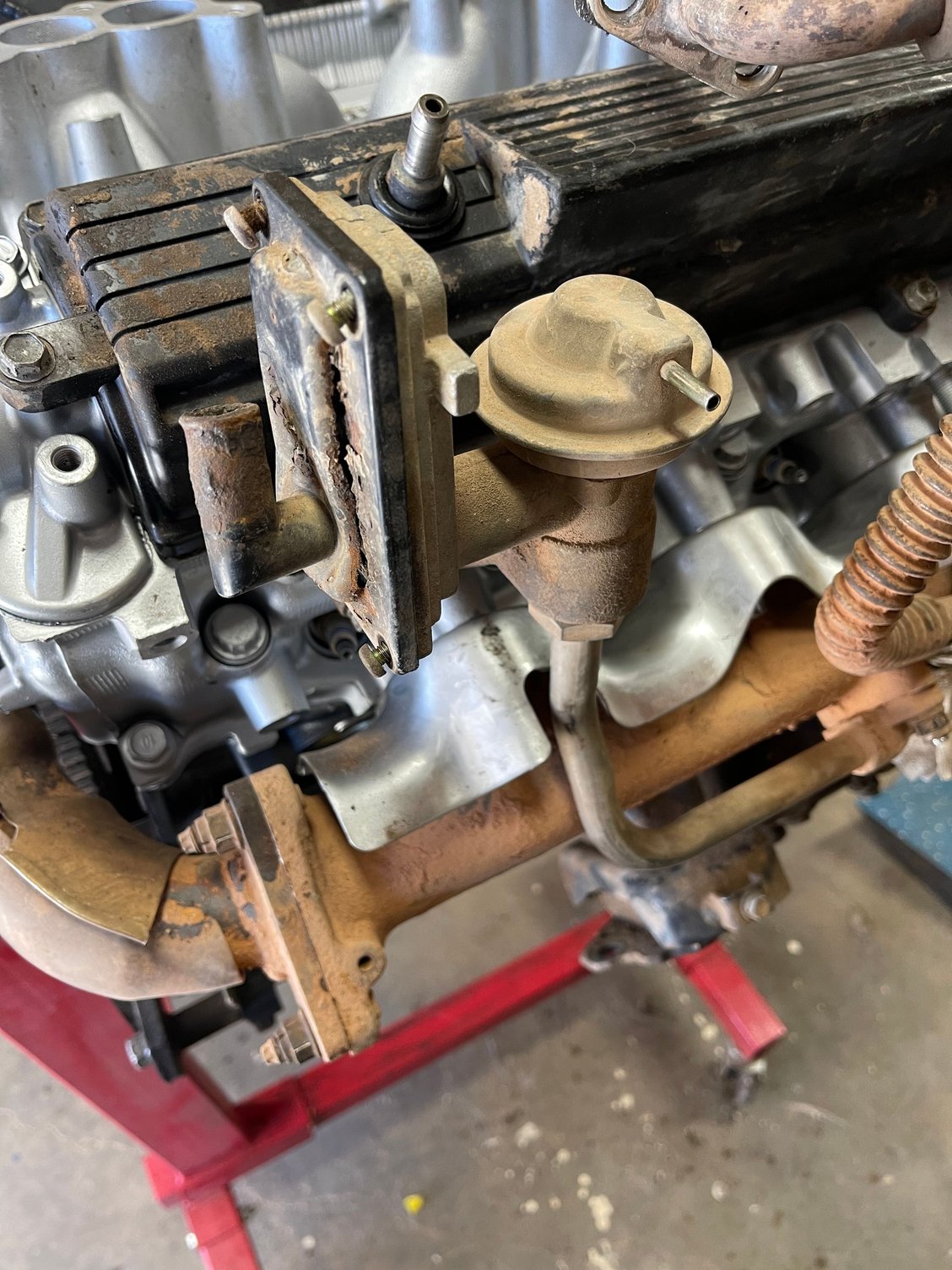

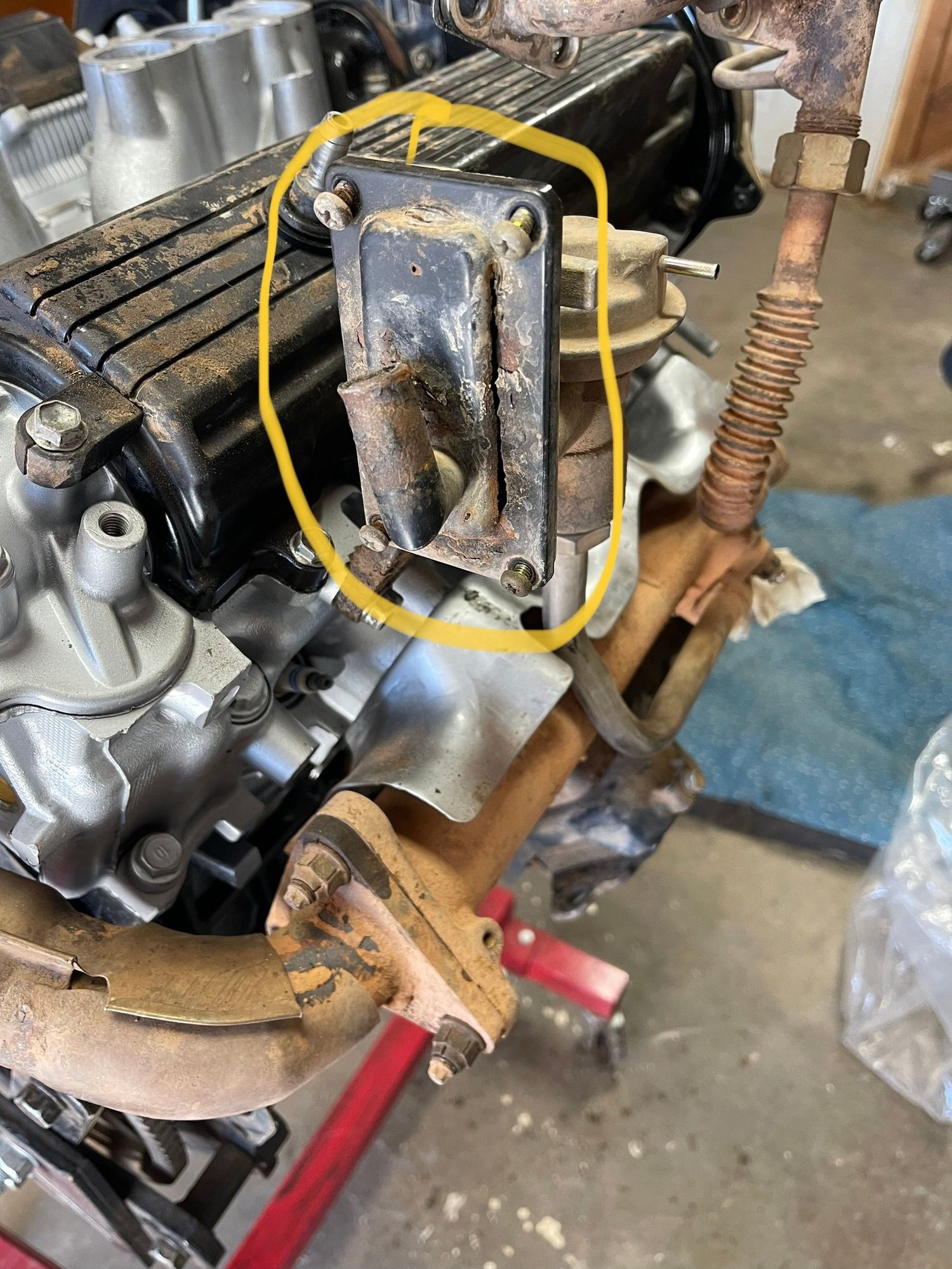

Can any help me identify this part? What is it called and what is it’s purpose?

Reed valve for PAIR system.
Pulsed air injection system is a completely passive scheme that introduces air into the exhaust at low engine RPMs to aid the CAT in combusting excess hydrocarbons,
Nothing PAIR does hurts engine performance.

Or Manifold Air Injection System. https://parts.lakelandtoyota.com/sho...rimLevel=18380
Millball (as usual) is correct in the description.

Thank you! I went ahead and bought an EGR delete kit which I believe will eliminate this all together.

Don't know what you bought, but this has nothing to do with the EGR
