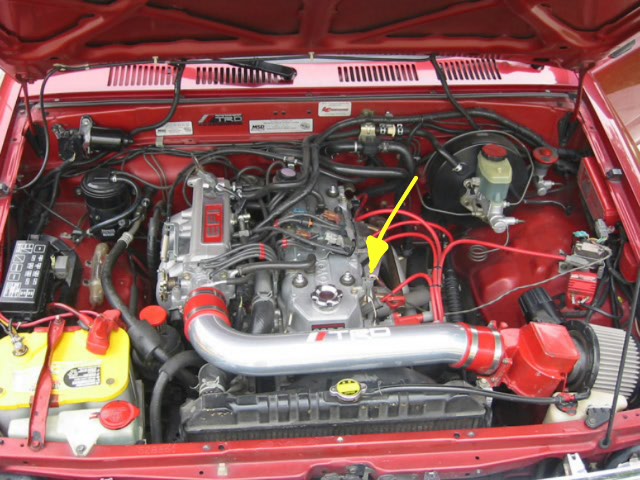

Oh wait I see what you're talking about...
Stolen pic from web
That one? I don't have that on my 87. I would just splice it as others have suggested.

Originally Posted by scope103
If want you want is just the connector, I am told (by someone on this site) that the last 5 digits of the part number are actually molded into the connector body.
That is correct. If the part he wants is the one that Jennygirl pointed out in the picture above, then the part numbers are...
90980-11038 (male)
90980-11137 (female)
The male part is available for around $3. The female part may be harder to come by, but it is available if you order the ignition pickup it is attached to.
If you need the female side, I would do as suggested and just use a weatherpack to fix it.
