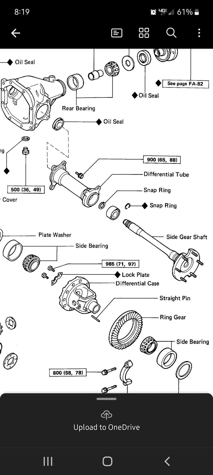

Diff question
87 pickup 4x4 IFS front.
Is there a bearing in the outer end of the side differential tube? I can't find a definitive answer. My service manual pic shows something but has no identifying label for it and the assembly instructions don't mention anything about a bearing....

There is a bearing there. Sealed type. Toyota part number
Either 90369-36008 or 90369-36009
Looks like the 009 number crosses to SKF BR3610

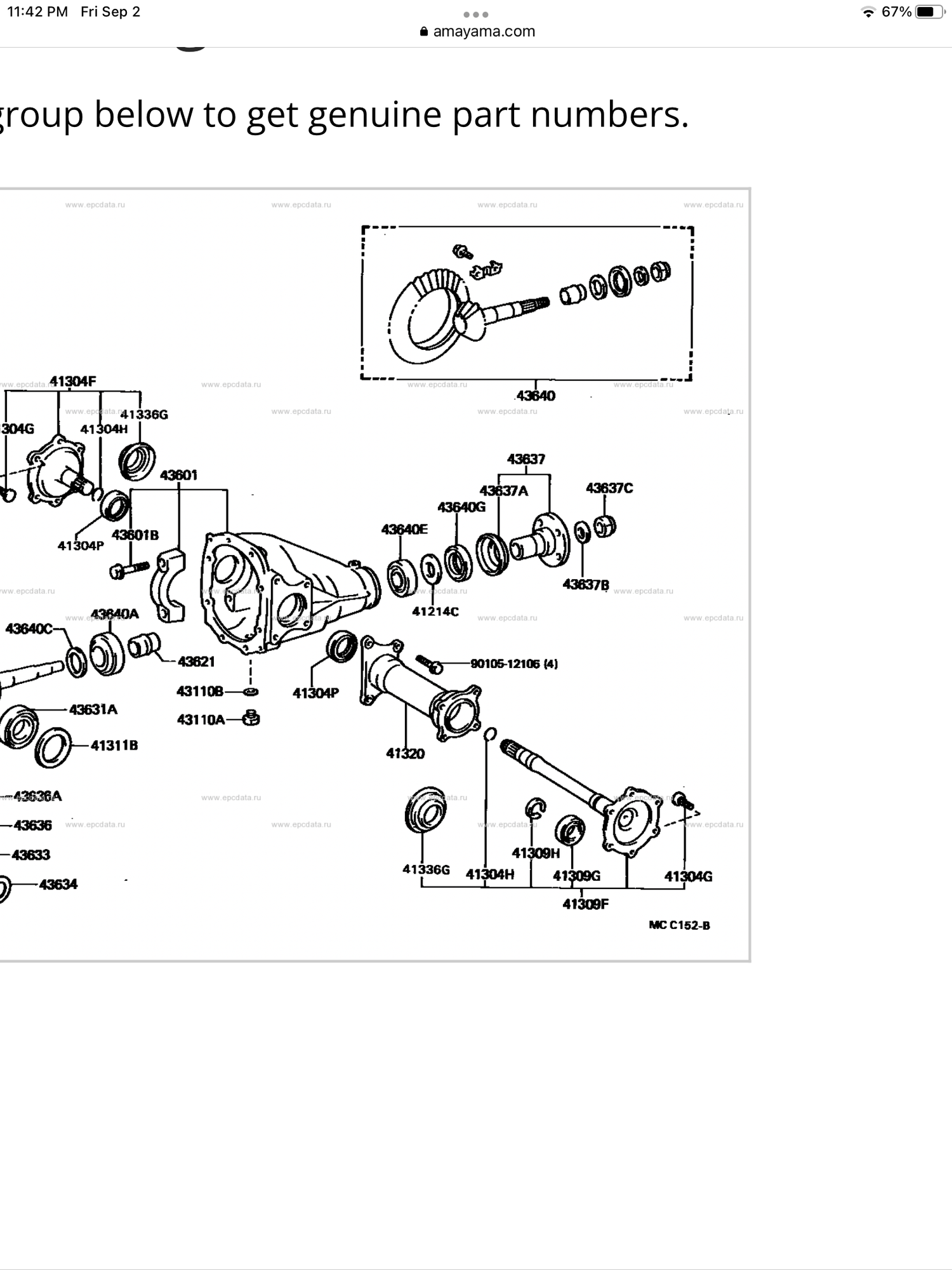

Millball, yes I saw your part numbers the first time and I thank you for them. Can't seem to find it at any of the regular places. It's like it doesn't exist. My FSM just pretends it doesn't exist also, see pic. Lol.
Expensive little guy.
Old Sep 2, 2022 | 07:36 PM
millball's Avatar
Joined: Aug 2013
Posts: 4,264
Likes: 683
From: Southern Arizona
Cheapest one on EBAY is here>> https://www.ebay.com/itm/37420221151...ta=enc%3AAQAHA

Old Sep 2, 2022 | 10:46 PM

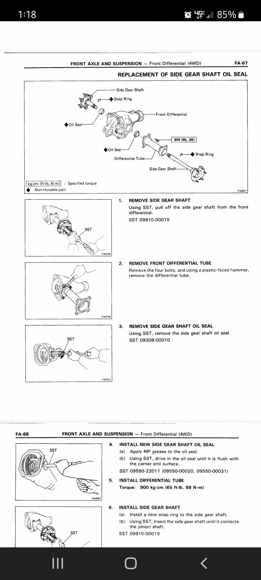

Jimkola's Avatar
YT Community Team
5 Year Member
Joined: Jan 2020
Posts: 2,253
Likes: 1,005
The factory manual sometimes makes it fun to find info, like torque specs, but it’s usually all there.
look in section FA(front axle), page 67 in the FSM. that should have the extension tube

Old Sep 3, 2022 | 12:19 PM
K5BEAST's Avatar
Joined: Jul 2021
Posts: 85
From: North Idaho
FA 67 Doesn't even show a bearing. Lol.
Old Sep 25, 2022 | 12:36 PM
K5BEAST's Avatar
Joined: Jul 2021
Posts: 85
From: North Idaho
Got a skf bearing. Anyone got a part number for the accompanying dust shield? Like the bearing, nobody sees it or lists it. Thanx in advance.
Old Sep 25, 2022 | 12:43 PM
millball's Avatar
Joined: Aug 2013
Posts: 4,264
Likes: 683
Dust cover>>> 41336-35010
Likely gonna be a dealer only part.
Don't know what's wrong with the font color>> Dusr cover 41336-35010
