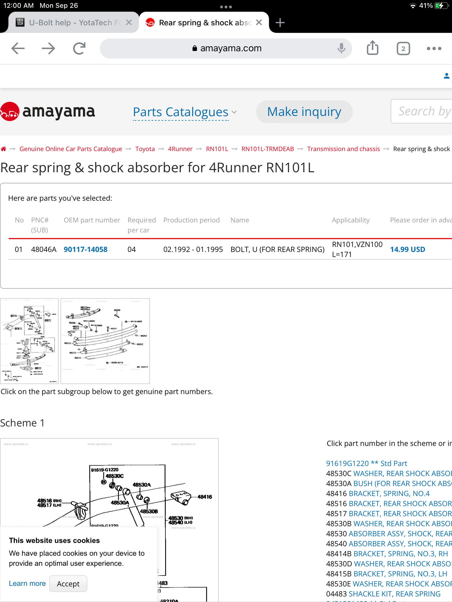

Mine were to narrow. What’s your model# and production date? Both are on the door jam vin plate
Old Sep 25, 2022 | 05:03 PM
Steady7's Avatar
Joined: Aug 2022
Posts: 10
Model: RN101L-TRMDEAB
Date: 11/93
Old Sep 25, 2022 | 11:08 PM
Jimkola's Avatar
YT Community Team
5 Year Member
Joined: Jan 2020
Posts: 2,253
Likes: 1,005
For that model# I show only one choice 90117-14058
