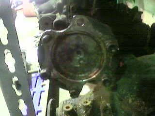

this?

yeah tried i think that's what he's talking about.

The other end..if the wheel were on the ground, it would be a non issue..IF the shaft wasn't broken on the outer end. Ardent supplied a GREAT idea that should work prefectly. Thanks for such quick replies fellas.
<edit> I'll wedge a piece of 2x4 in one of those flange indents/notches and go to the ground with it. Perfect!
