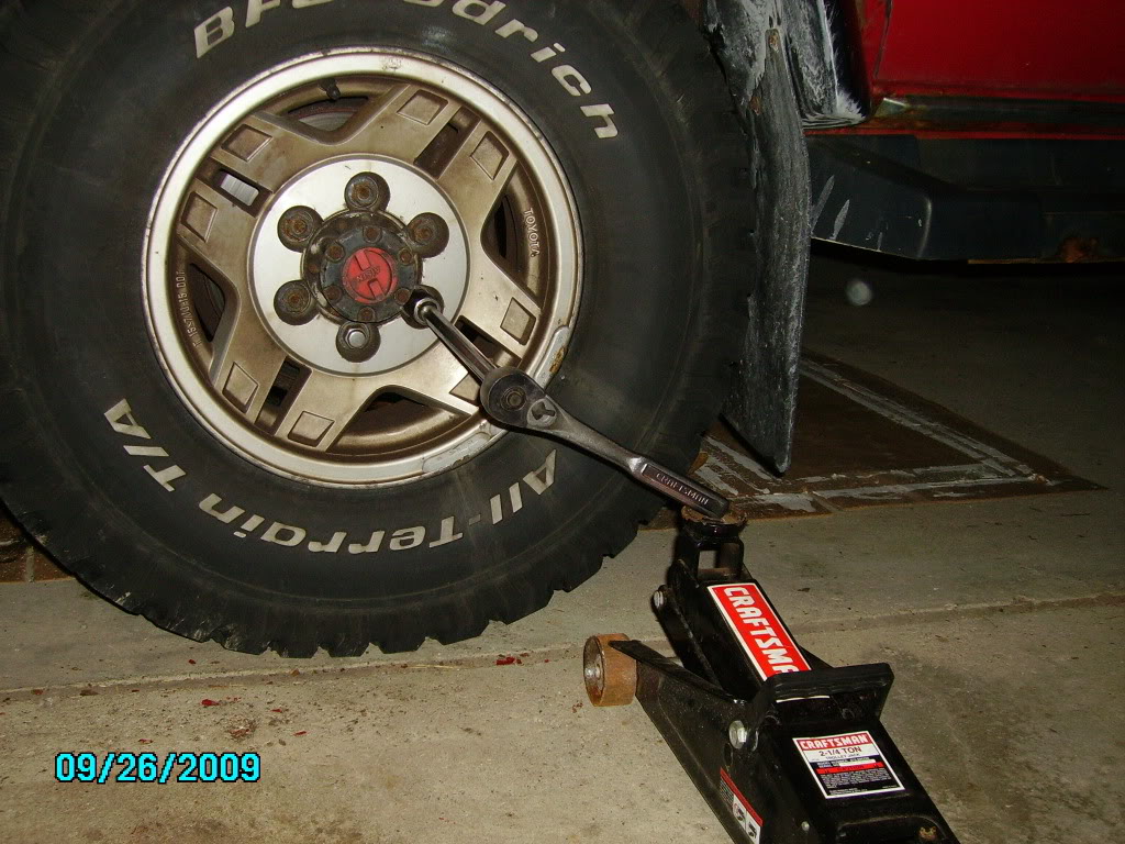

another trick is one i used to get a stuck lug nut loose once. it might work for the crank bolt too. put on the breaker bar/ratchet with the bar off to the right, put a jack underneath the bar. lift the jack. the bar goes up with the jack, forcing the bolt counter-clockwise with a lot more force than your bicep could give. you're gonna have to have it in gear with someone stomping on the brakes for this. i can take a picture of you don't follow what i'm saying.

maybe i misunderstood your problem, but i took it to mean that you just can't get the crank pulley bolt broken loose so you can remove your pulley. the method i described was not for a crank pulley bolt, but it MIGHT work. i mean, a stuck bolt/nut is a stuck bolt/nut. so this is what i did one time with a stuck lug nut. i just used the power of a hydraulic jack to force the bolt/nut to turn instead of using muscle power. in the case of a crank pulley bolt, on any engine where the crankshaft isn't locked up, doing this will easily turn over the entire engine before loosening the bolt. which is why i said to put the trans into 5th gear (assuming stick shift) and have someone hold the brake pedal so nothing can turn except the bolt. good luck. if you have any other questions, PM me, cuz i might not see that you asked otherwise.

yeah my bad i was answering the ORIGINAL question of the thread, not your question about the stripped bolt. upon re-reading it, i noticed that this thread is 2 years old. hahaha, why are we still talking about it? as for you, i'd recommend starting your own thread. sorry i can't help more.
