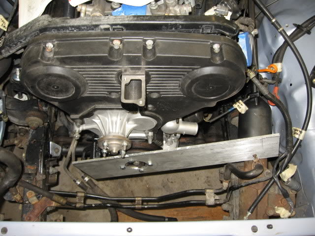

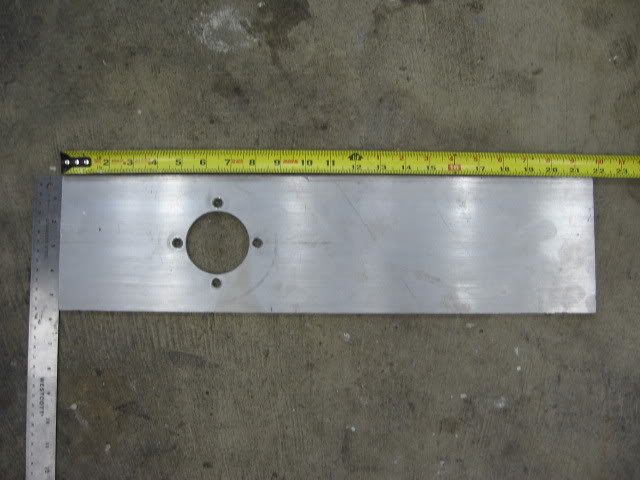

OutlawMike's Avatar
Joined: Dec 2007
Posts: 710
From: Santa Rosa, CA
I like the chain idea, why didn't I think of that?
I did a pretty simple tool from a plate of aluminum scrap I had laying around.
One large hole in the middle to clear the pilot features on the balancer and 4 holes to put bolts into the balancer.
The end of it rests on the frame rail on either side, torque away!!
