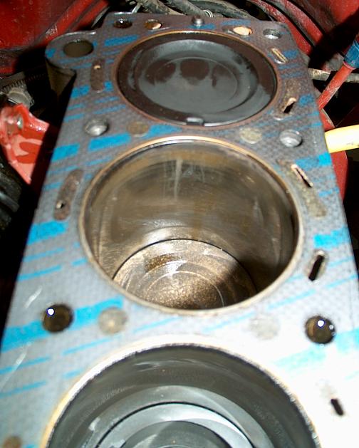

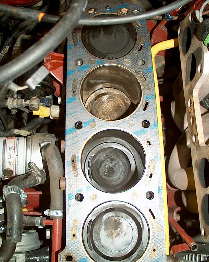

Less than 3K on my $1,914 "Remanufactured" Long Block from "JER". When I called the # on my invoice I got "ATK", after several calls to them they denied any link to JER and refused to warranty the product.
Opinions on these photos?

I initially thought I had caused the HG leak by removing the head bolts while installing a new cam, so I had the head checked for warpage and pressure tested, results were good, I replaced the HG with a Cometic MLS gasket and installed ARP Studs, nuts torqued to 90lbs as per Rep. w/ ARP. Fired her up and within ten minutes the temp was about 198 at idle in the garage with a steady flow of bubbles, just like before, after "burping" my baby, which had, and still does not, ever end.
The colored fluid test at the radiator fill neck confirmed I still had an issue with exhaust gas entering the coolant system, somewhere... Hmmmmn...

>>>*This is a situation I have run into before. The company doesn't actually "build" engines, or at best does so only partially or rarely. Rather, they purchase from an outside source.
The actual supplier, in this case JER would be the company to contact.
So even if ATK did build and supply the engine, you are not their customer, JER is. It's a bummer, plus difficult to deal with over a long distance.
Blocks for the turbo are rare, expensive, but one solution is just to drill the extra hole for the turbo application in a 22RE engine block and change over the parts. That is the only difference in the two engine blocks.
You might consider replacing the rings and bearings, you will need the gaskets anyway so a kit will do it and they are reasonably cheap.
The other option would be to sleeve the block you have, any good machine shop can do this and it's maybe $100-150 or so that way. Probably even less cost than replacing the block and boring it, etc.
Check to be sure the leak is in the cylinder wall itself. I got the pics open finally, not easy on dialup but I was curious. The head shows no sign of a crack, there is normally "washing" present so I suspect she has a pressure break in that obvious bore. We see that sometimes when a driver is wading a stream that gets a taq too deep..Hydraulic lock can pop a bore open it there is a weak spot.
I say a sleeve will probably fix that good as new....*EB
