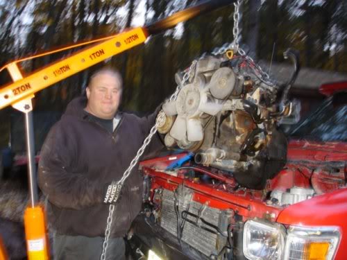

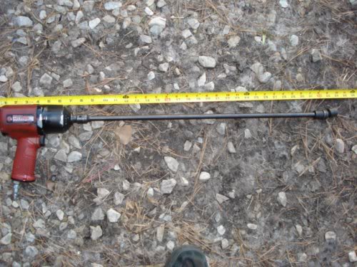

i have a body lift wich made it easy for the tranny bolts
but having the right tools makes the diffrence.

^^That looks like what I used to take off the 3 exhaust manifold to downpipe nuts lol. Laid on my back under the truck with about 3 feet of extensions on my ratchet lol. I have that same picker from Harbor Freight.
Rob

I do beleive that is the largest socket extension i have ever seen before in my life
