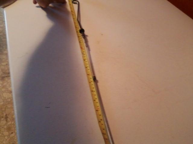

I've got a 22RTE that's been converted to 22RE. She won't show full on the dipstick unless 6 qts are added after oil change with filter (standard size). Measuring on level ground, dipstick is 23.5". Did the 22RTE blocks hold more oil? I understand that they are a little different than the 22RE block.

Everyones measurements could be a little different so here is a picture of a basic 22re. Mine is 23.5 as well. I dont know the 22rte.
This is exactly what my dipstick looks like. And it measures 23.5" from top to bottom. It seats properly all the way down. I'm so confused.
