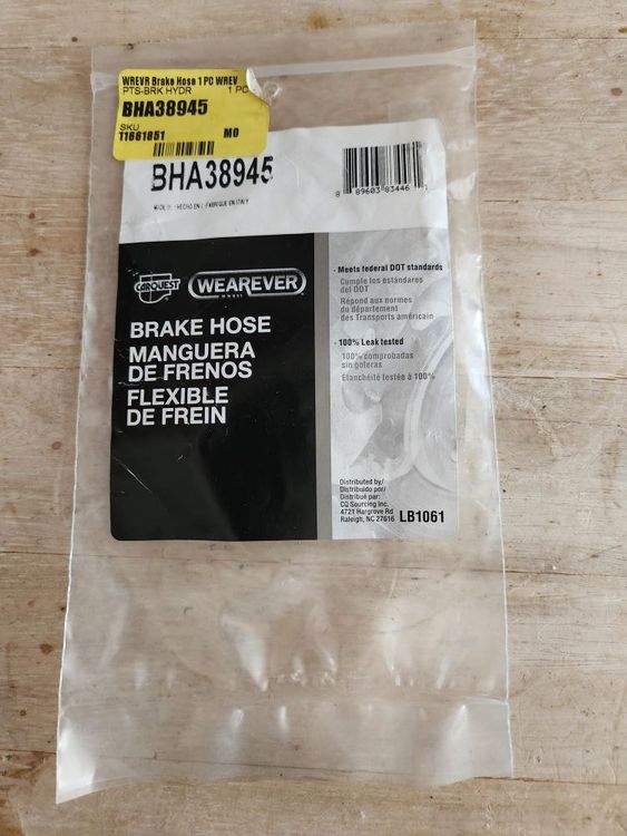

Soft Clutch Line
Here's the part that will eventually need replaced. In my case a hose clamp from another line wore a hole through it causing the failure.
