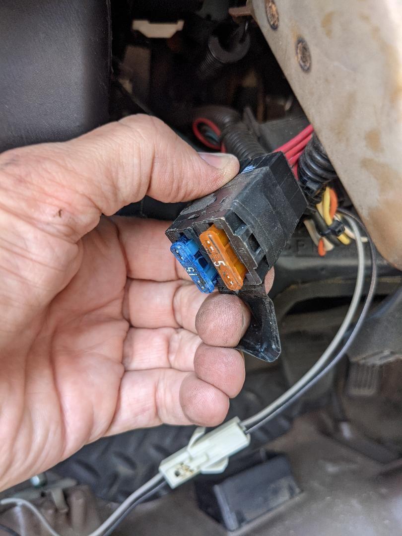

A couple of fuses in the same general area.
Some sort of plug behind where I am holding the fuses

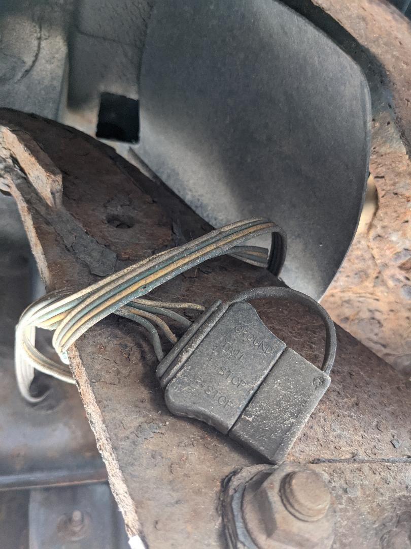

This is by the back bumper. Is this to plug trailer lights into?

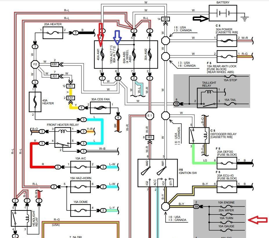

Constantly blinking. As in a steady, even, flashing test light? If there are any breaks in a steady pattern, it's showing a code. Like if it flashes 2 times, a short pause, and 4 flashes, and then repeats, that's a code 24, you see? If it just flashes a steady pulse, no variations, THAT means no code. The trick is to be certain there's never any variation to the pattern over about a minute.
If it does indicate a code, make sure you cleared any old codes out. Either pull the EFI fuse for about a minute, or, as I prefer, pull the battery negative lead off for a minute or more. This makes sure to clear any codes that have been stored in what little memory the ECU has, so you don't end up chasing a problem that's been fixed already.
Make sure to jumper T1-E1 to try and read codes. Turn the key all the way off, put the jumper in, then, with your test light in place, turn the key on. If there are any code they will show as I said above. So many flashes, short pause, then another set of flashes, then a slightly longer pause, then the first number of flashes, pause, second number, pause, etc etc. I use a short piece of wire, with make spade terminals that fit the DLC1 female terminals as a jumper, but many people use a more expensive solution. They use a paperclip bent to fit. Probably a good quarter cent or so. Very expensive
And then as far as testing the "gauges" fuse, I tried setting my multimeter to DC 20, key on, touch the black lead to the frame of the car, and then the red lead to to any of the two metal leads on any fuse and nothing. I must be doing something wrong.
Not necessarily are you doing something wrong. It may be there's no voltage on the Gauges fuse. This tells you something important. It tells you you need to trace the power source for the Gauge fuse back to it's origin. It also means you need to now learn to read a schematic, you lucky dog! A schematic is like a road map, that shows where electricity goes. I won't get into electron vs. hole flow, here. BTW, I'm lousy at drawing thing on pictures, to show visually what's going on. I'm as artistic as a sick tortoise, ok? Bear with me.
Refer to the picture above as I talk, ok? That is a small part of the schematic for your truck.
OK, to trace down what's happening, first, find the Gauges fuse on the picture. Lower right corner. The "S" shape indicates a fuse. You can see a line come out of that grey block with the Gauges fuse in it, marked B-Y. That means the color of the wire is Black, with a Yellow stripe. Notice the line is also colored to help you follow across multiple pages. Most schematics from my day didn't have that feature, but then, most systems I worked on, all the wires were white. We always knew it was the white wire Follow it to the little box it goes to, marked Ignition Switch. That's the key. Note it can connect the far side, little triangle, to ACC, IG1, and ST1. Acc is Accessory, the first switch position. The second is IG1, that's when the key is in RUN, or ON position. ST1 is STArt. Why the 1's? Because the switch has 2 halves. The 1 indicate the first half of the switch.
Imagine the key is ON. The switch would connect to IG1, so keep following the line you were on. Notice it became a White wire, marked W, drawn in white, oddly enough. Follow the white line up the picture. Now it gets a little confusing. The box it goes to is the engine compartment fuse box. It goes through a funny "S" shaped device. Those are fusible links. USUALLY that's a wire of a very specific size. It will burn through at a very specific current load, and normally has an extra thick, soft insulation. This allows the wire to burn, without coming out and burning setting something on fire. In this case it could be with one of what LOOK like fuse, just real big. Marked AM1, AM2, etc. Toyota calls them fusible links , but most of them are really just high current fuses. The ones that are cubical, with a clear top. Some are actually real fusible links, like the wire from the battery to the engine fuse box, or the wire from the high power lead of the alternator.
OK, so now your tracing through a fusuble link. You need to use the screws that attach the wires to it on the back of it. The section of the fuse box with the fusible links in it slides up and out of the fuse box. There's a catch on the side facing the quarter panel. Slide the fusible links up and out, and check them just like you would a fuse. Ohms 20, or ohms2, a lead on each side.
NOTE: PULL BOTH battery leads off before you use your meter to measure ohms. If you don't, the voltage from the battery can, and will, damage the meter. Normally, meters have a small fuse in them to prevent damaging the meter, but why take a chance?
Ok, if AM1, red arrow, reads good, follow your line some more. See it goes to the 100, or 80 Amp fusible link. That's the heavy, white wire from the alternator to the engine fuse block. Check the 100, or 80, whichever it is, fusible link, although you'd have a lot, a LOT, more wrong if it were bad. Chances are, it's the AM1 fusible link, although that should cause other troubles. Once you have FOUND all these items, you can also check the wires between them. Ohms 20, one lead at one end of the wire you want to check, one at the other. You can make an extender out of a piece of regular ol' wire if your leads don't reach. This is often the case in vehicles.
OK, I have to go eat. Today's lesson is now over
Good luck!

Yes, the lack of voltage to ground on either pin of the gauge fuse is an important clue. But before you start trying to trace wires, think. Do your wipers or turn signals work (key-on)? If they do, you know that there is power on the B-Y wire. You don't need to trace the wire back to the ignition switch, or worry about the ignition switch.
So then, check for voltage to ground on the wiper fuse. You know that fuse works and has power, so this checks your measurement technique. Then pull the gauge fuse out, and check for voltage to ground on each connector. It is possible that one of the fuse connectors is so messed up that it no longer makes a good connection to the fuse. Or that it is disconnected inside the fuse block.
Or, if both the wipers and turn signals are out, that's a sign you don't have power to the fuse block on the B-Y. (Again, check your technique by looking for voltage to ground on the fuse pins.) You could have a bad wire, but the most likely culprit is the ignition switch. Back AT the ignition switch, back-probe pin1 (where B-Y) connects to look for voltage with key-on.
Electrical is all about divide and conquer. Figure out where you have power and where you don't, then move in the appropriate direction. Don't start tracing wires that you should know already are working.
And yes, a steady 2-hz blinking on the W line means "no codes." That's good news!
The connector at back is a fairly standard trailer wiring connector. But there is no guaranty it was installed well. Any guess what the switch is for?

Use your test procedure, whatever it is, on something "known good." If the wipers work, the wiper fuse has to have power, so test there. You're looking for battery voltage (in your case around 12.5v) to ground. So the 20 range in DCV is just what you want. (Incidentally, here is where a test light is probably better than multimeter; you're not trying to look at numbers while holding probes.)
The frame is always at ground, but sometimes it's not obvious how to get there. Painted metal usually won't conduct; look for a fastener into the metal. Sheet metal isn't always grounded (e.g., the box of a pickup is mounted on rubber vibration isolators, so the taillights have a wired ground, not to the box.)
