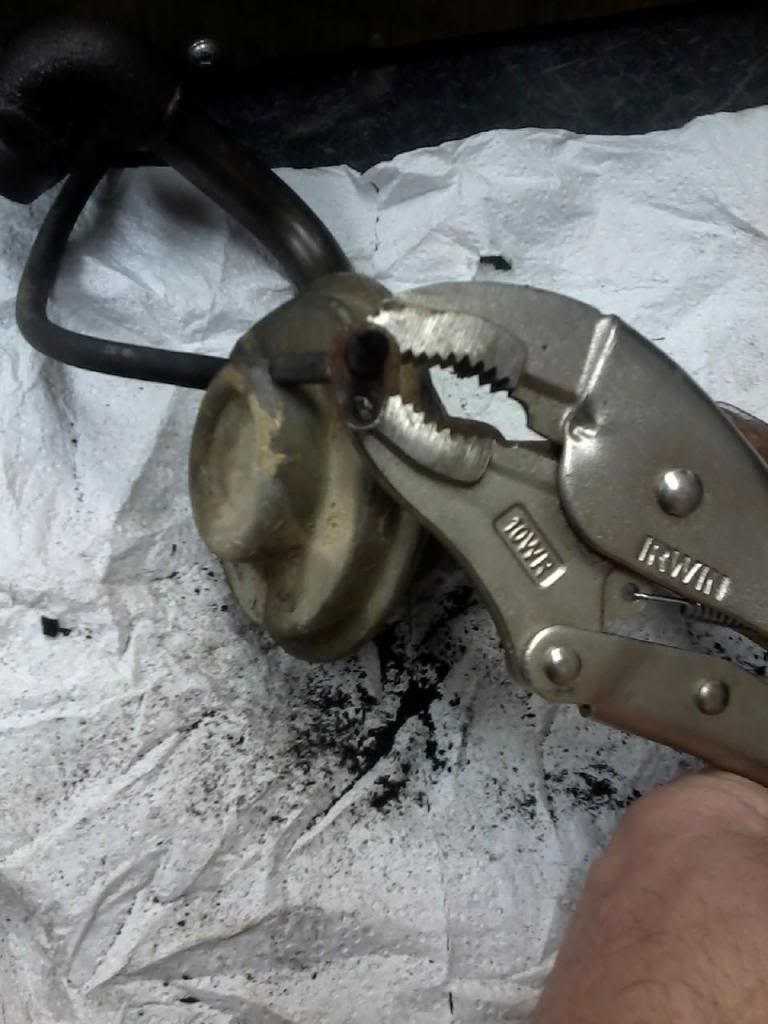

I worked on the EGR. Here is another picture that may look like the wrong way to do this, but the screw will strip if you use a screwdriver. Get a good firm grip, but not so hard to distort the screw.
With the screw out, get another bite on the the pipe to get it out of the EGR. Leave the carbon in the pipe at this time as it will help keep the pipe round. The carbon is hard as concrete. Slowly work back and forth to get the pipe spinning inside the EGR tube and to start breaking it free. Could take up to 10 minutes but just be patient.
Here is me using a drill bit. I have never gotten as screw out with a Phillips screwdriver. Ususally rusted to bad. I use vise grips, then getting the pipe out is another job in itself. Take your time, you have to get this out to get all the carbon out.

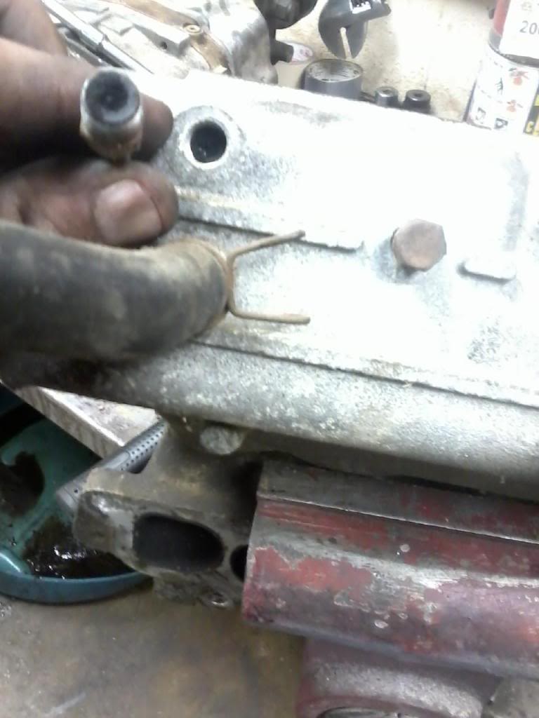

After it is apart, I use a drill bit, screw driver, nail, clothes hanger to get all of the carbon out. It is rock solid in places. You can put vacuum on the hose and see and hear the plunger moving and operating inside the EGR, the goldish part.
If you take the Plenum off, Pull the Throttle Body off and take the Plenum to the carwash. The Thottle Postion Sensor is on the Throttle Body. Dont get it wet with water or cleaner. I just leave it on. You dont want the TPS giving problems. Where the EGR connects on to the Plenum, it will be very dirty. It has tubes that go through the Plenum so you wont be able to see all the way through. I take some kind of cleaner and spray into it to break up the carbon.

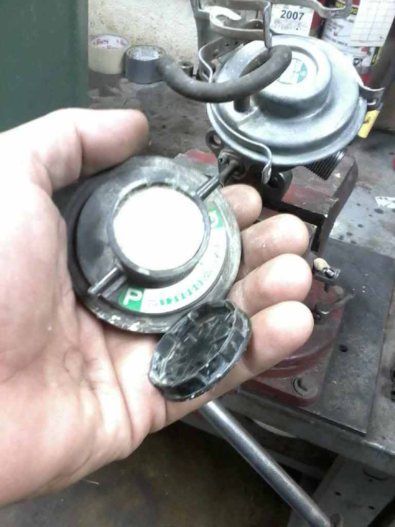

On the Brown Valve, just pop the black cap off and take an air hose and blow the paper filter clean.

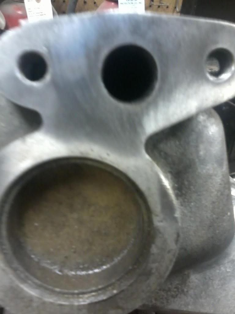

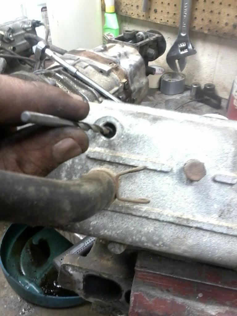

All of the hose connections on the Plenum will more than likely be plugged to. Here to I use a drill bit with my fingers and get it all cleared out. Check the hoses also and make sure there is no carbon blocking them.
Here both the port and line is completely plugged with carbon. There were others plugged as well.
