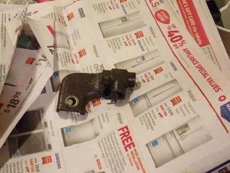

This is what I removed BUT what I find online doesn't hardly look like that!
I just want to get the truck on the rd again so I can sell it to my neighbor.

That's just a T fitting I think, the only proportioning valve is the LSPV or Load Sensing Proportioning Valve, which is above the rear axle. It does exactly what it sounds like, senses your rear load and proportions your braking power accordingly.

That part is just a Tee. Here's the manual page for the LPS&BV . I don't think you'd mistake that for the Tee.
You really ought to include your neighbor in whatever decision you make about fixing this, particularly if you do the repair yourself. If you "fix" the brakes and they fail, neighborhood parties could be a little awkward.
