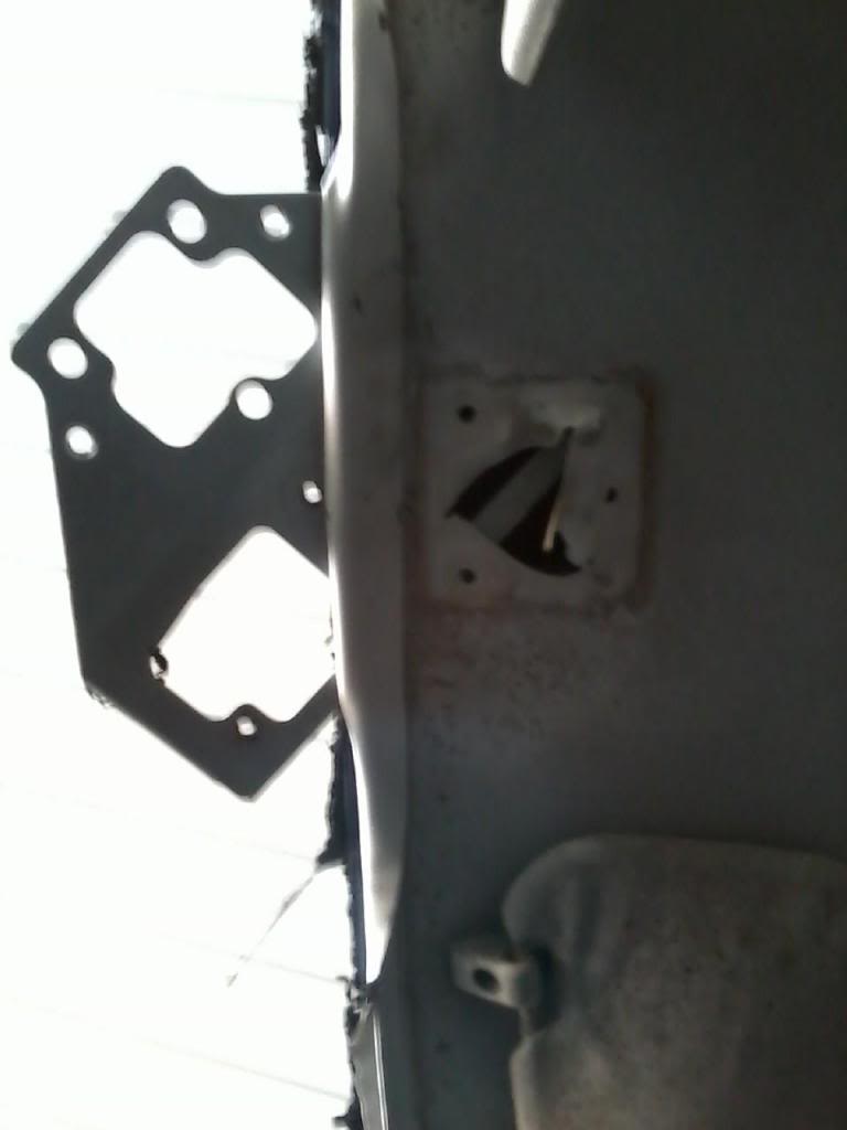

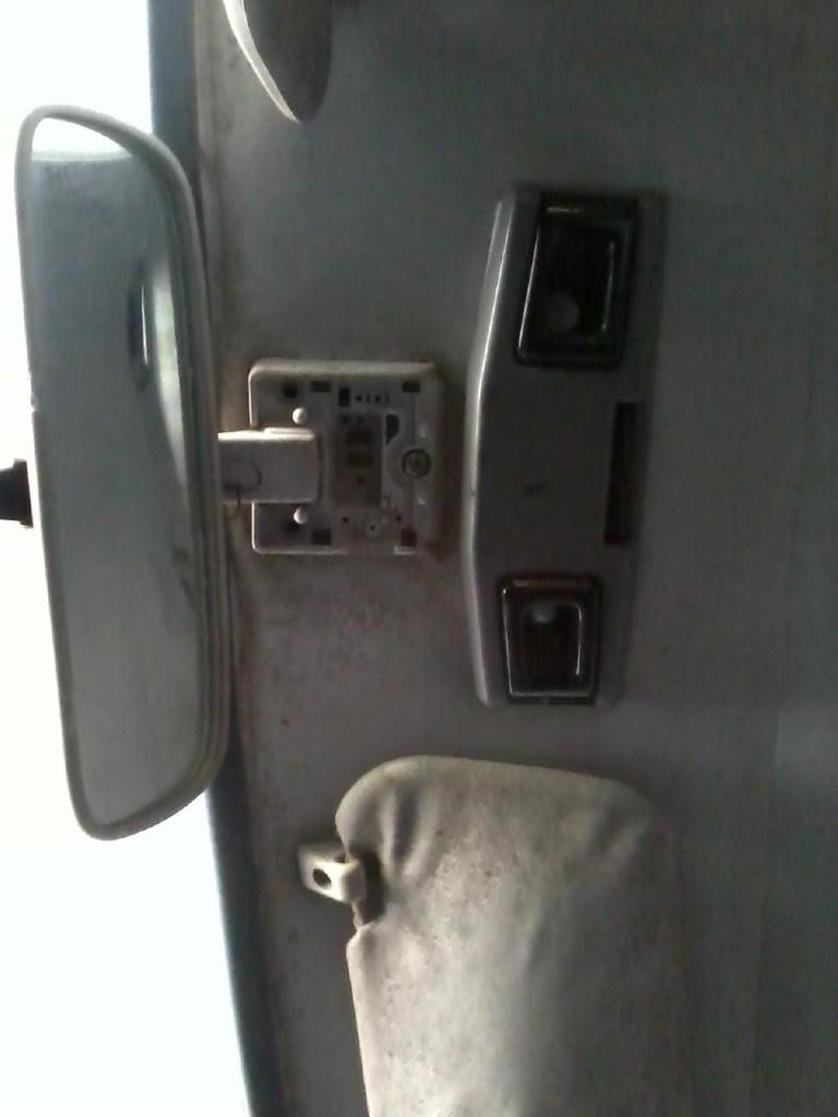

I use a standard cab light for 4Runners and Extended Cabs. The 4 Runners and Extended Cabs have a dummy light that holds the mirror mount. I tap into the wiring at the top left corner of the windshield.
I peeled the headliner back a little and slid it in. Then put the trimming back in to hold the liner back in place.

Then where the mirror goes I usd the mirror screws to hold it so I could cut the liner for the recess for the light assembly.

Here it is mounted. I still need to run the wiring. I have always added a standard cab pick up to my 4runners or extended cab trucks as the light that mounts in the center isnt much use for the driver. I run the wire to the top left corner for electrical. I show this in my 88 Runner build.

I got a dome light out of a Standard cab out of a salvage with the same interior color as my wife truck and mounted it in to where your mirror is. I just drilled a small hole to run wires along the windshield to the driverswindshield post and poped off the trim.
There is 2 wires that run along the post that I tapped into and soldered and taped up. Get the plug to the mirror and about 3 feet of the wire out of the donor truck and screw in. Easy and cheap upgrade. The dome ligh on a extended cab and 4Runner is behind you and doesnt light the floorboard up and that is where I am usually trying to find my things.

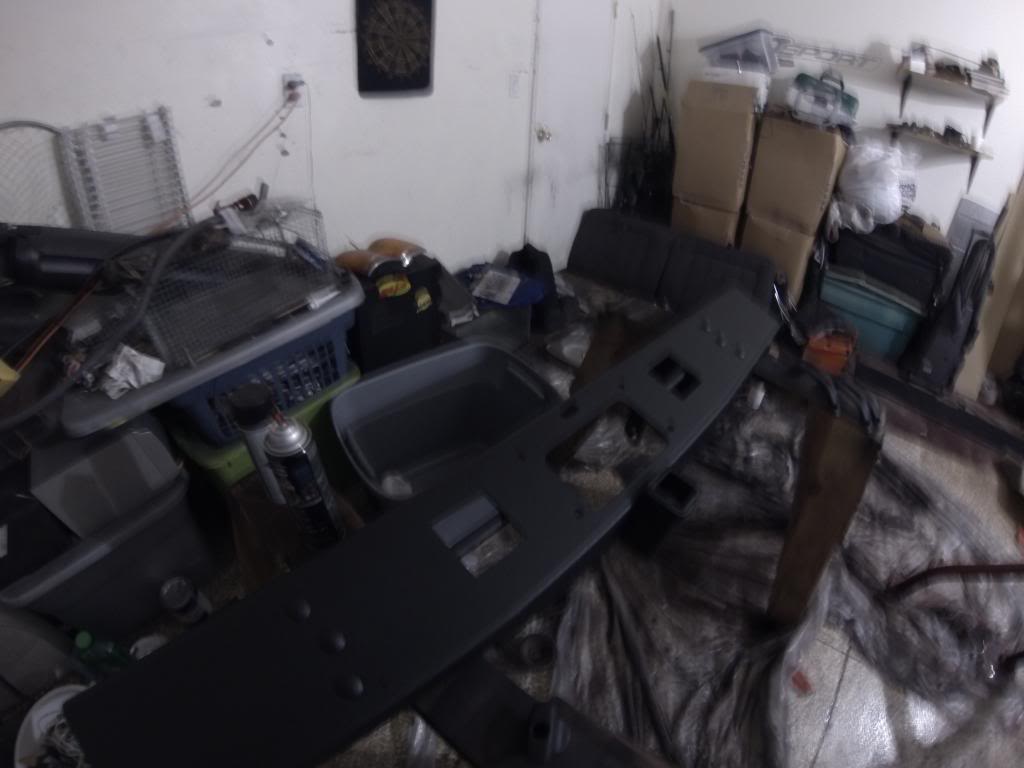

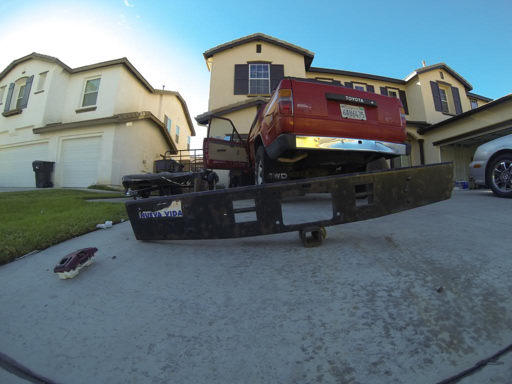

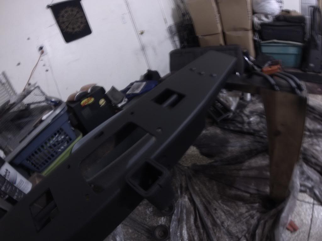

So i found this at the local pick a part it was on a 87 4runner , damn thing was heavy it looks like in the middle theres a winch mount .What yall think??? has anyone seen this bumper before?

Score! How much?

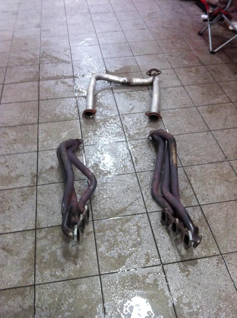

Score of the Century!!!! 60 dollars!!!! and yes that includes the crossover pipe....

$60 any one seen it before

Could you post up pix of it installed. I wanna see how and where the cross over goes. I got mine used and it came with cross over but I don't like how it's routed and wanna see if yours is done better

I will do that when I get them installed. I plan on doing it over Christmas break. To be honest, the crossover looks like it is made from a muffle shop, not the piece that came with the headers. When I saw this set installed on the other truck, Im pretty sure the crossover was tucked close to the transfer case. nicely tucked away too. I will be sure to post pictures when I do it
