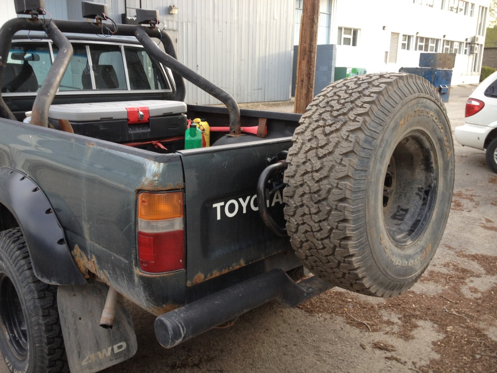

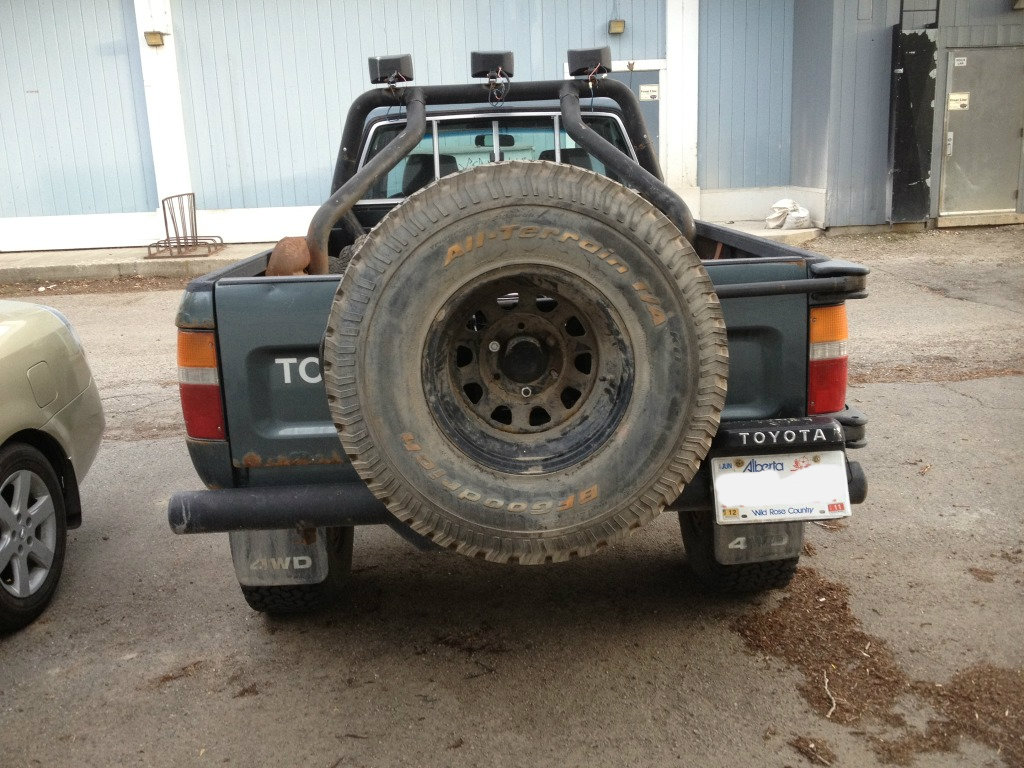

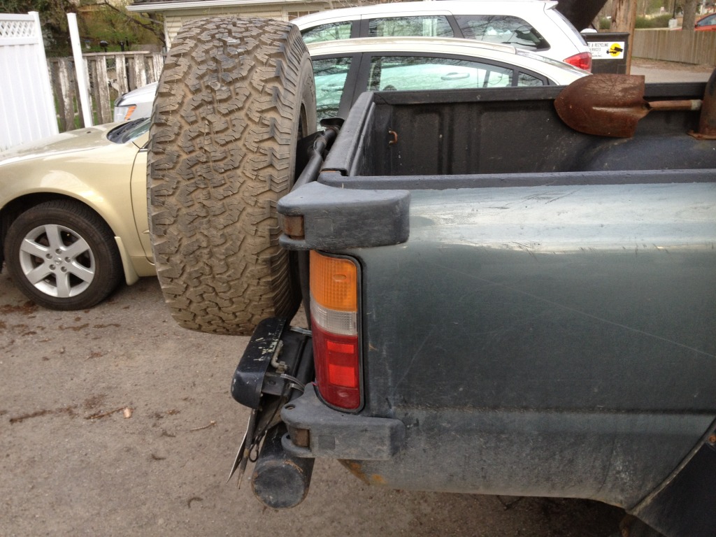

Swing out spare tire carrier:

^^^what did you do to brace it on the inside when installing?

I used the inner bracing bracket that came from the 4Runner.
I had to cut it down quite a bit because the corner on the pickup is completely different than the 4Runner (behind the outer sheetmetal).
