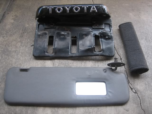

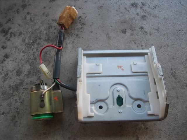

Out of a 90 or 91 4runner for my 92 Dlx pickup. Besides finally finding my grey sr5 seats (in good condition), i grabbed the rear view mirror/dome/map light . Also, didn't realize the passenger visor has a mirror in it so grabbed that. Grabbed the license plate holder from the swing away tire mount (I liked the classic look of it and will somehow mount it to the rear). Got real lucky and scored a sr5 truck center console (the one with two compartments) a wonder that was left lying around. A seat belt shoulder pad???? I dunno if that was an option or was aftermarket, but it matched the fabric on the seats. And someone posted about the lighted ash tray and lighter so grabbed that, but I opened my dash up and don't see any electrical connection for it? maybe someone did a write up on installing it.
Some of the goods...

If you can wait till tomorrow I'll take off my lighted cig and ashtray and take some pics, I did the mod but don't remember everything, I'll post it on here, if I forget PM me!!!!

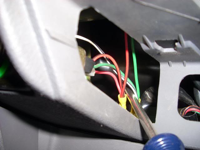

Here is how I wired up a lighted cig lighter and ash tray, cut off the connector off your new used lighted cig lighter and ash tray and strip all the wires back a 1/2 inch, the white wire and 2 green wires are the ground and I used a yellow male connector, the truck had an L shapped connector and where the white wire was at is the ground so plug-in the newly put on yellow connector, now take all the red wires and put them in a male yellow connector and insert it into the other empty place on your trucks L connector and waalaa all done with the wires now put it all back together.

Yes, it helped me, very easy, thanks. I just need to buy some spade connectors so it will plug into the L shaped connector.
