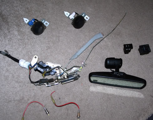

My haul from the local boneyard today. 2 door pin switches, power mirror switch, rear defroster switch, compass/temp/autodim mirror from a 1996 Surburban, 2 headliner rear speakers (mounted above the rear window, behind trim) and a power door lock motor. Not pictured- rear cargo area carpet (floor/back of seats). Total: $22.50.

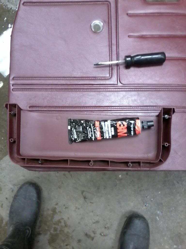

I added front pockets from an 89-95 runner to my 88. Used interior paint as they were tan in color. I used the rubber gasket maker to mark the screw holes and then set it against the panel. Just drilled out the rubber dots and perfect fit.

Added rear pockets from an 89 SR5. Hadnt painted the buckets at this time. Mods are in my 88 build. Come in really handy.
