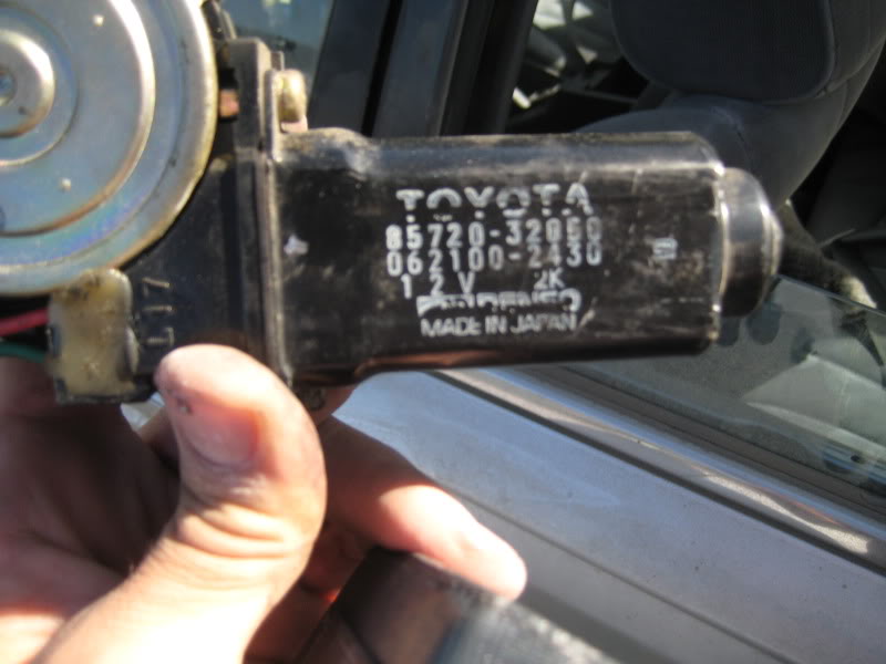

Here is the Camry motor:

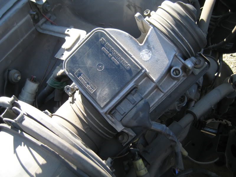

Also, while I was there I spotted a 1983 Supra and it had the AFM still in it:
I've read that the 1982 Supra AFMs are a direct swap for 22REs in our trucks, but does this one fall into that category? Are there any CA SMOG implications for this swap?

Can someone answer my question about window motor compatability?
It seems more and more that these motors among pretty much all 1980s Toyotas are interchangable, even with different part numbers.
Here's an example of an aftermarket replacement motor for a 1987 4runner:
http://www.1aauto.com/1A/WindowMotor...unner/-/-/1987
And here's an example of an aftermarket replacement motor for a 1990 Camry:
http://www.1aauto.com/1A/WindowMotor...83/356011/1990
And...here's an example of an aftermarket replacement motor for a 1984-95 Pickup:
http://www.1aauto.com/1A/WindowMotor...83/356048/1995
They all three have the same part number on this site: 1AWPM00083
All look the same and have 7 teeth on the gear.
I'm pretty confident this same motor was used in all these vehicles from Toyota and are interchangable....can someone confirm for me that it's plug n play?

Phil, you need the 43110 for straight plug and play. thats a 43030, you would have to swap wires to get it to work.
Ask DeathCougar about the motor. He knows that answer for sure.

So, the motors/gears would all work - and the motor mount the same....but the wires would need some work....I can handle that I think
