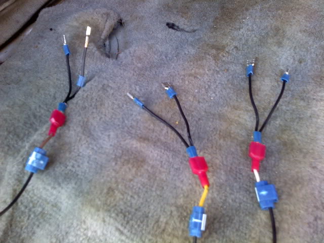

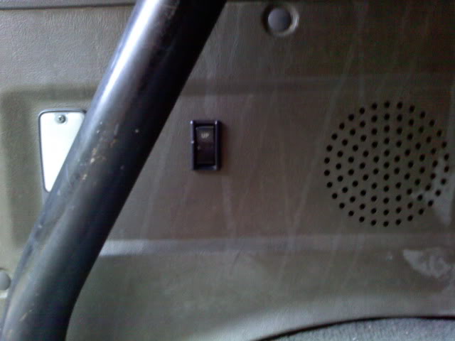

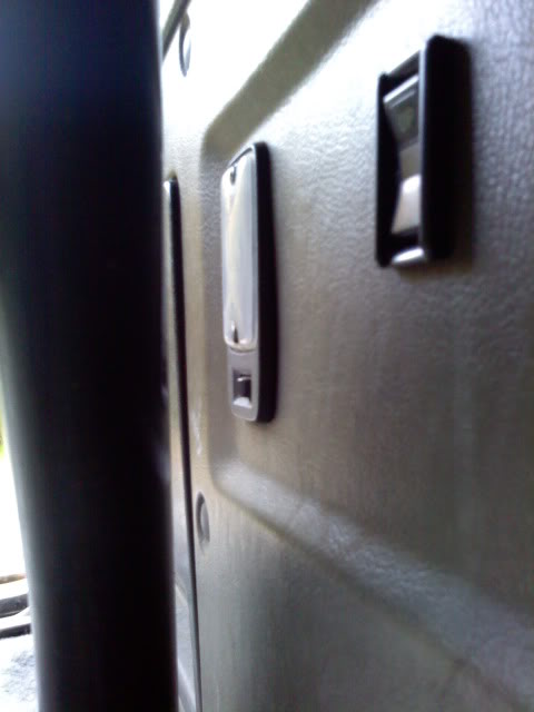

think you might be able to take some pictures or give some 'don't touch the blue wire' type pointers if you think of it? Anyhow, I would love to see how you went about wiring and locating that extra window switch if you get a chance. Thanks.
This was the first mod I did to my 4Runner. The wiring might be a bit different since mine is a 1988, but here it is.
Just pics of how it looks.
I was tired of forgetting my keys and not being able to roll down the rear window, so I made my front switch constant hot too. Each of those 3 wires comes from the main harness inside the panel, and splits towards the new cargo switch and the front switch. (The front switch is a newer mod.)

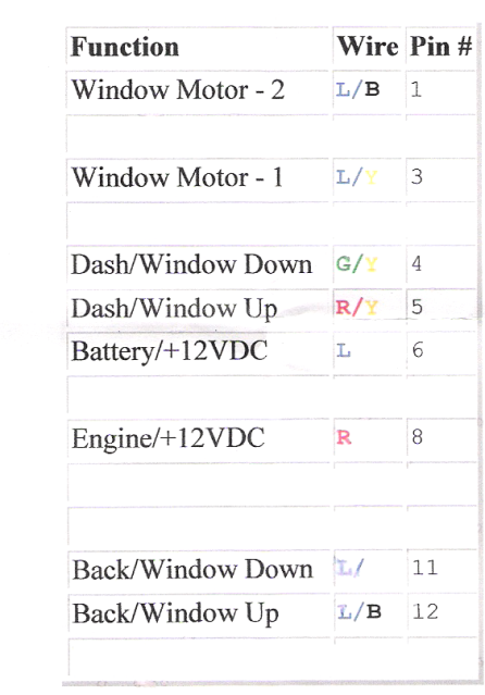

Here is a diagram I found to originally get into the wire harness. (Didn't want to spend a lot of time trying to find it again, so I just scanned mine. Always keep notes! I just wished I marked exactly what wires I used.)
Don't worry about the Pin number, that's referring to the whole relay. I'm just going to use the numbers as a wire reference. (I cut out all wires that are for sure not needed.)
I do not recall if Pins 4 & 5 have corresponding colors on the wires on the switch. But those are the wires that you want to use on the switch. Connect Pin 4 (on switch) to Pin 11 (on harness) and connect Pin 5 (switch) to Pin 12 (harness.) For the main power source, you connect Pin 6 or Pin 8 to the middle wire on the switch, but I'm 99% sure its Pin 6. Be careful not to get Pins 1 & 12 mixed up as they are color coded the exact same way. Pins 1 & 3 are of a slightly thicker gauge and you do not want to mess with them.
I hope I helped. Good luck!
**EDIT: Notice that Pin 6's wire is "L" and Pin 11's is "L/." First of, realize that "L" stands for blue, (just incase the color didn't tell you that,) since "B" is already taken for black. And second, (Pin 11 is the only visible case shown here,) I came to find that the people who made the chart failed to realize that white doesn't show up on white. Pin 11 is really "L/W," as I came to learn for myself. The wires that only have one letter and no slash are just solidly that color. These are just a couple things I was confused on myself until I dug into the harness. Also, for this mod, it seems as though most everyone who does it doesnt realize that the harness is right there and they run the wires all the way from inside the tailgate and find a way into the body. The harness is right there. And lastly, I saw some one's write-up where he just used a simple generic double-throw switch from Kragen or somewhere. And he placed it right next to the tailgate handle. I thought it was very clever. It would not fit my tastes in my truck, simply because I like my way better, but it definately looked good.
Size:  153.1 KB[/QUOTE]
Thanks for posting this. I have the switch on my workbench and had been looking through the wiring diagrams to try to figure out which wires to tap into on the harness. This gives me a much better place to start from.

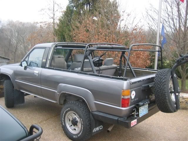

So.....I saw Haston's rear tire carrier and it looks like it's a toyota OEM one from a different SUV. I sent him a PM recently but haven't heard back.
Wondering if you guys have found, for 1st gen 4runners, a swinging rear tire carrier (and even a bumper that it's attached to maybe?) that works on my truck? I don't weld so I'm looking for bolt on options, if they're out there....
