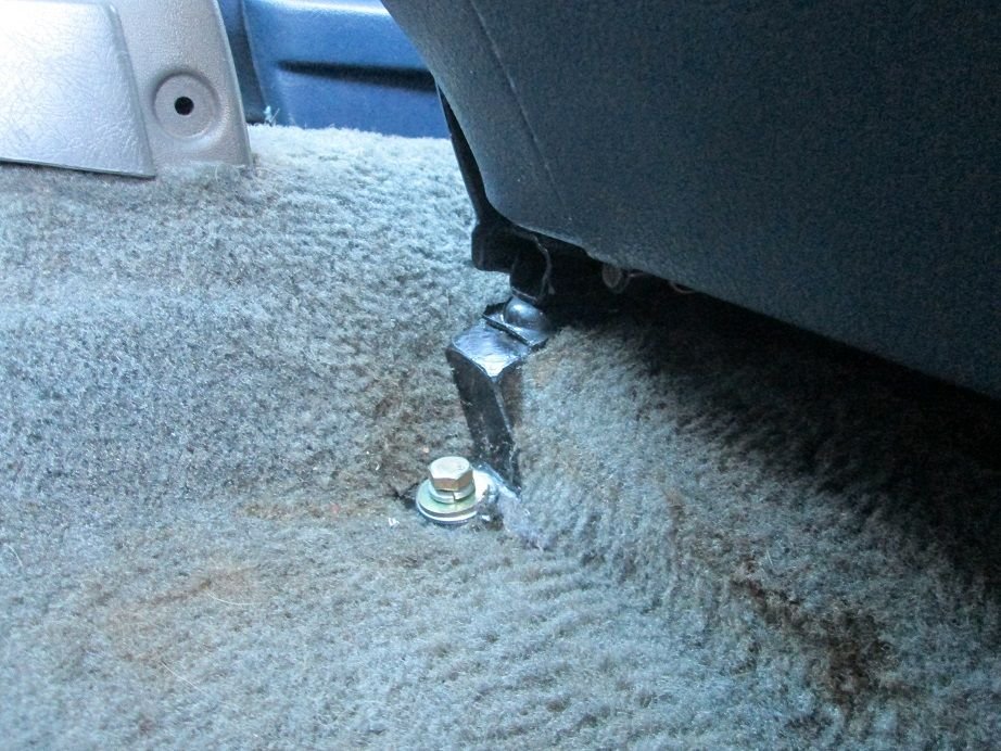

There was a big coffee stain on the carpet, so the next step is vacuming and scrubbing the stain out. 5 times. It was an old stain.
I had to grind out the outside front bolt hole a bit to get the bolt in.
Then I was able to drill through the floor for the inside front bracket. I used oversized washers underneath the truck to reinforce the floor when I bolted this bracket in place.

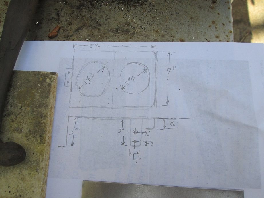

This is what I have used for the last ten years as my coffee mug platform. It looks like it could fall off of the shifter console after installing the bucket seats.
So, after making plans, I went to Home Depot for materials. Total cost under $10.00.
These are the plans for a basic cup holder that will also serve as a base for my coffee mug too.
