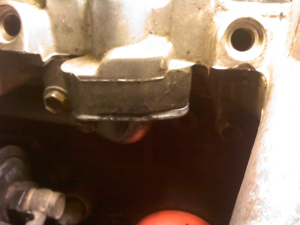

Question.
Is there a gasket that's suppose to fit here with the cooling pipe? I havea gasket that I haven't used yet and dunno where it's suppose to go. Not only that but I didn't see a gasket come off when I pulled my lower intake off.
Old Mar 31, 2011 | 12:12 PM
  #152
yotarob2005's Avatar
Joined: Jan 2010
Posts: 1,803
Likes: 14
From: Bryan Tx,
Yes there should be a gasket. I imagine that without one it would leak like pig.

Actually that takes an 0 ring...

yep...O-ring....yep....didn't have one....YEP....used lotsa RTV there

Second thought on that RTV because that pipe is hard to put back in place. It's unaligned so the bolts that need to go in wont go in straight and I don't have the fuel rail off or vice grips that will fit...
yep....that's the problem with that connection and the problem i exactly had. the vice grips were the only way i could get that aligned ......i would recommend getting some versus cross-threading.

Keep everything loose then put the pipe in, it'll go. I found an O-Ring at the local auto parts store. I don't have a size for ya thought...
