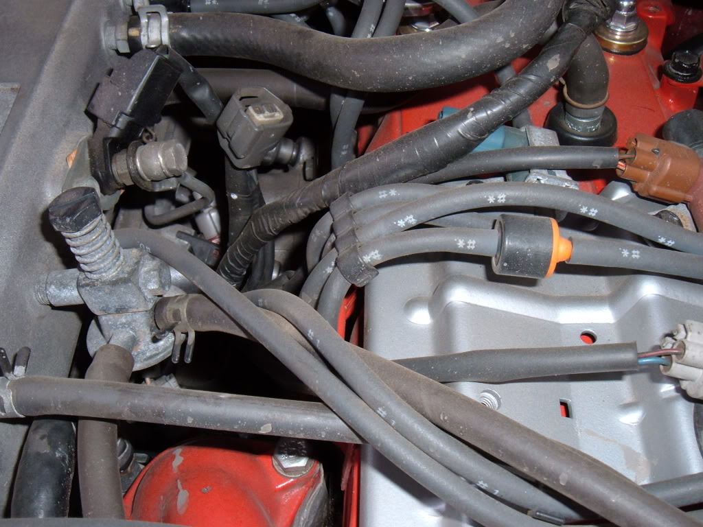

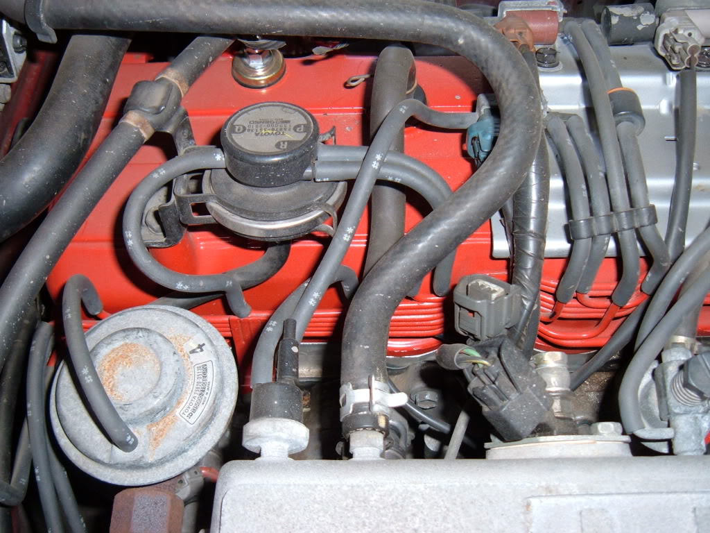

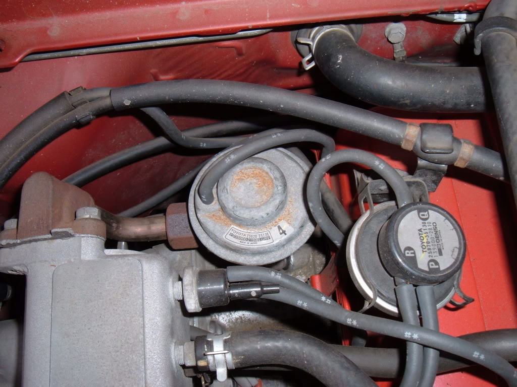

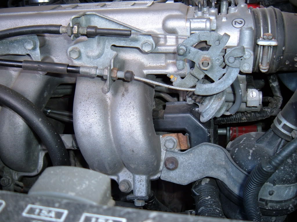

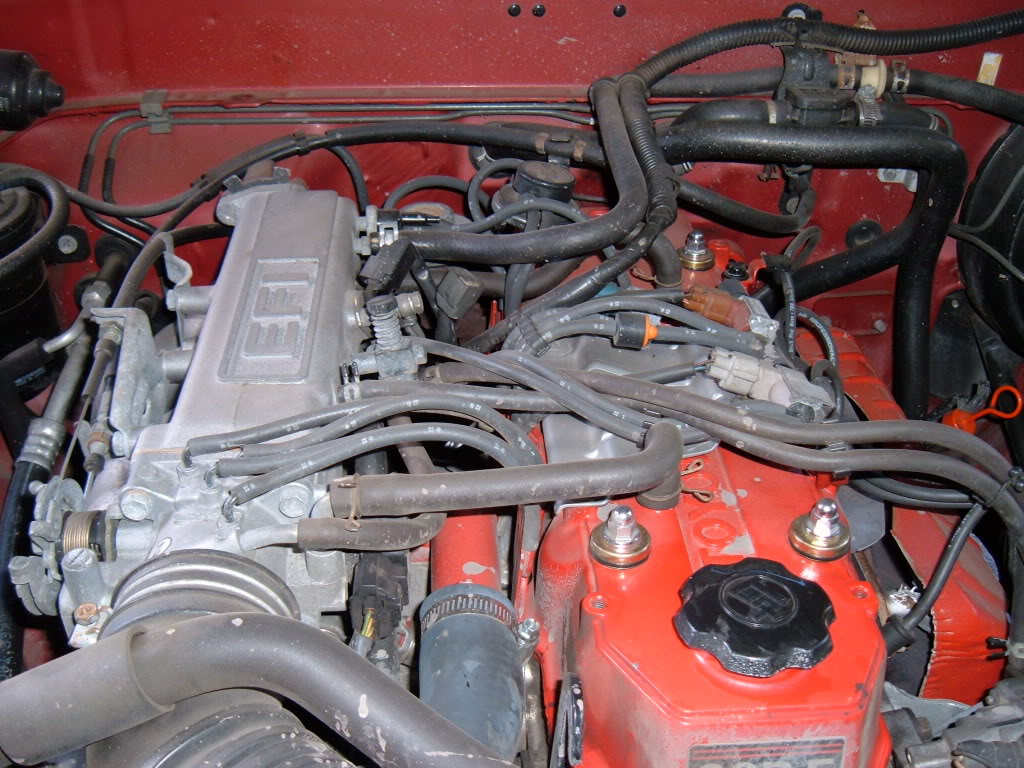

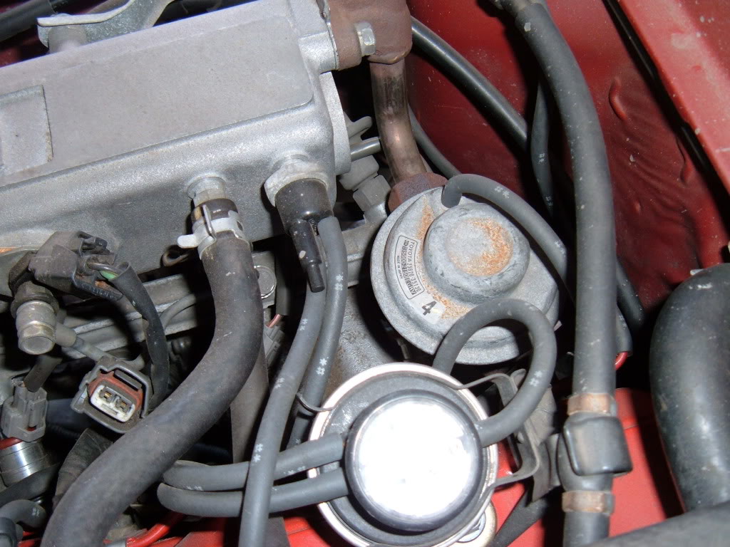

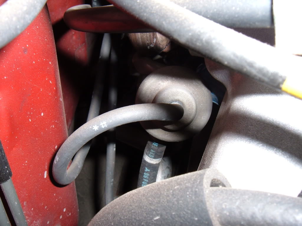

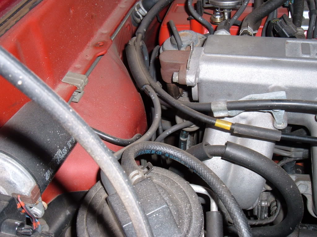

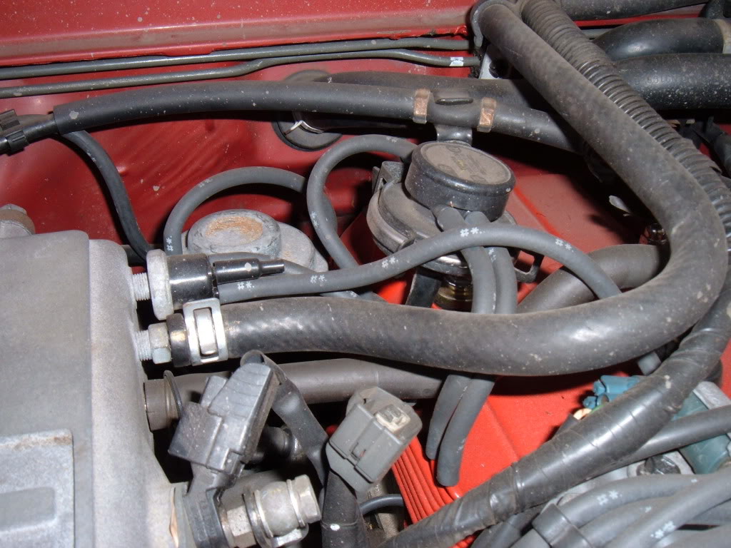

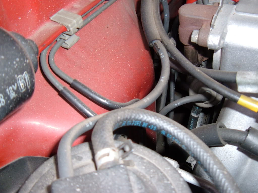

I got a request for pics of vac hose routing, so I figured I'd post them here for everyone to see and maybe help someone too.

I have plenty of pics and also it's as simple as I can go out and take a pic and post it up.

Originally Posted by toyospearo
DANG!!!
That engine looks great!
thanks man....those top pics are recent, some of the other ones are originally after the 1st start. motor is a little dusty and muddy...BUT NOT OILY (except at the back of the pan.....gotta work on that)
