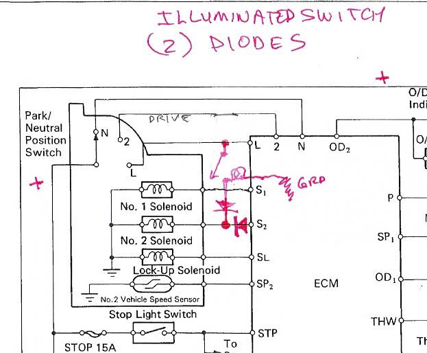

Ok here goes. This is not original but I have made it simpler and a bit different from the original.
Biggest problem w/ the tranny is no real control over 1st and 2nd. This mod lets you lock the tranny into 2nd gear. Great for coming down a hill, especially with curves. You've downshifted into L to control your speed and all is great. Then you come up to a curve and want to slow down a bit, but bam it slams into 1st. So you up shift back to D to get out of 1st, speed up and then down shift into L again to get back to 2nd. I always hated this tranny until I did this mod, and now I love it.
The key is to control tranny solenoid 2. The tranny gear is controlled by S1 and S2 as a matrix. S1 on, S2 off-1st gear. S1 on and S2 on-2nd gear. S1 off and S2 on- 3rd gear. Both S1 and S2 off, and OD on-4th gear. If you use page AT-63 out of the manual as a reference you can easily see what I'm doing. In the L position, only 1st and 2nd gear is possible. 1st gear is only possible if S2 if off. The solution is to keep S2 on, then you only have 2nd gear.
So basically all you have to do is provide 12v to S2 to keep it locked into 2nd gear. This is done by tying the 12v from L (12v when the shifter is in the L position) to S2 thru a switch and a diode. By using the 12v from L, it only has any effect if you are in the L position. Otherwise, if you use 12v from somewhere else and forget to turn it off, you couldn't shift into 4th when in the D position. (S2 must be off for 4th) The diode (in the direction from L to S2) is to keep S2 from back feeding L when your in D and forget to turn the switch off. Another diode is used at S2 to keep this 12v signal from back feeding the ECM.
It really works great and the only downside is if you forget to turn the switch off and your shifter is in L and come to a stop, you will be starting off in 2nd. Not a big deal.
Bob K
