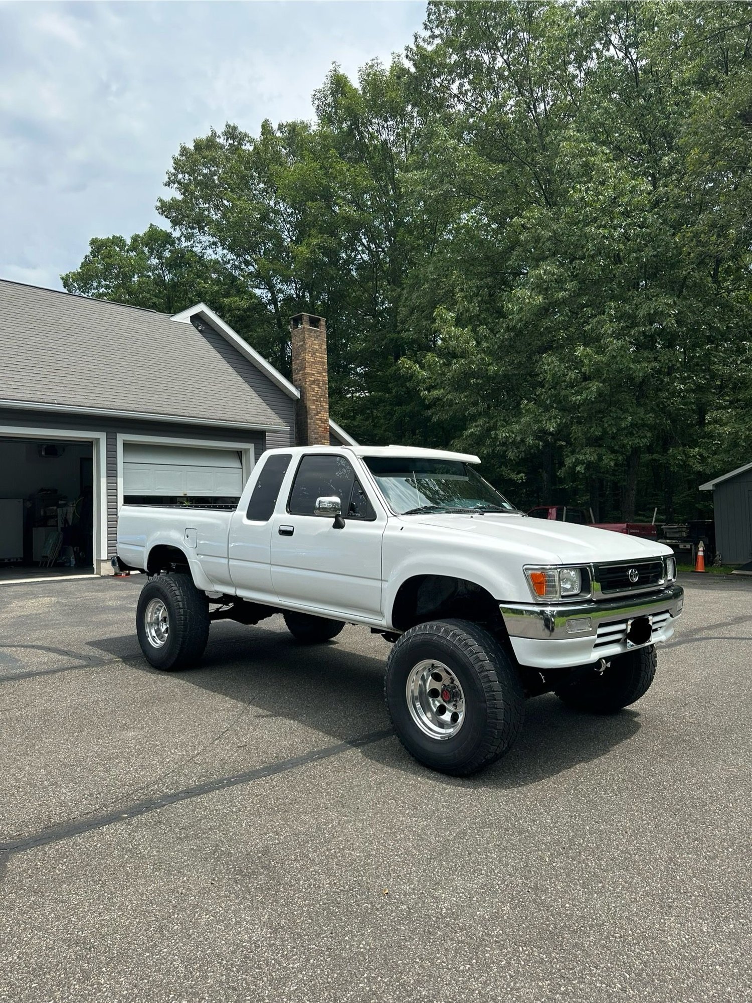

It looks too high. Can you let off the torsion bars enough to soften the ride and still have tire clearance? You can also pull a leaf from the rear packs. What load range are your tires? What pressure are you running in them?
It seems like you have too much spring and the shocks aren't causing it or going to solve it. Just my best "guess" based on experience on my old IFS Toyota trucks. Mine were the 84-88 models but my son had a 91 and a 93. We've had cranked stock torsion bars and aftermarket bars and the final solution for us was a straight axle swap. Mainly because we were going big tires and evolving into rock crawlers.
Softening up the rear leaf packs helped the overall ride. Load range C tires rode much better than E's that some tire shops pushed.
I don't like body lifts but it may be an option for you if you have tire clearance issues after letting off the torsion bars.
Nice looking truck. I hope you can get the ride dialed in the way you like. Please follow up with your solution.
Scott in AZ.

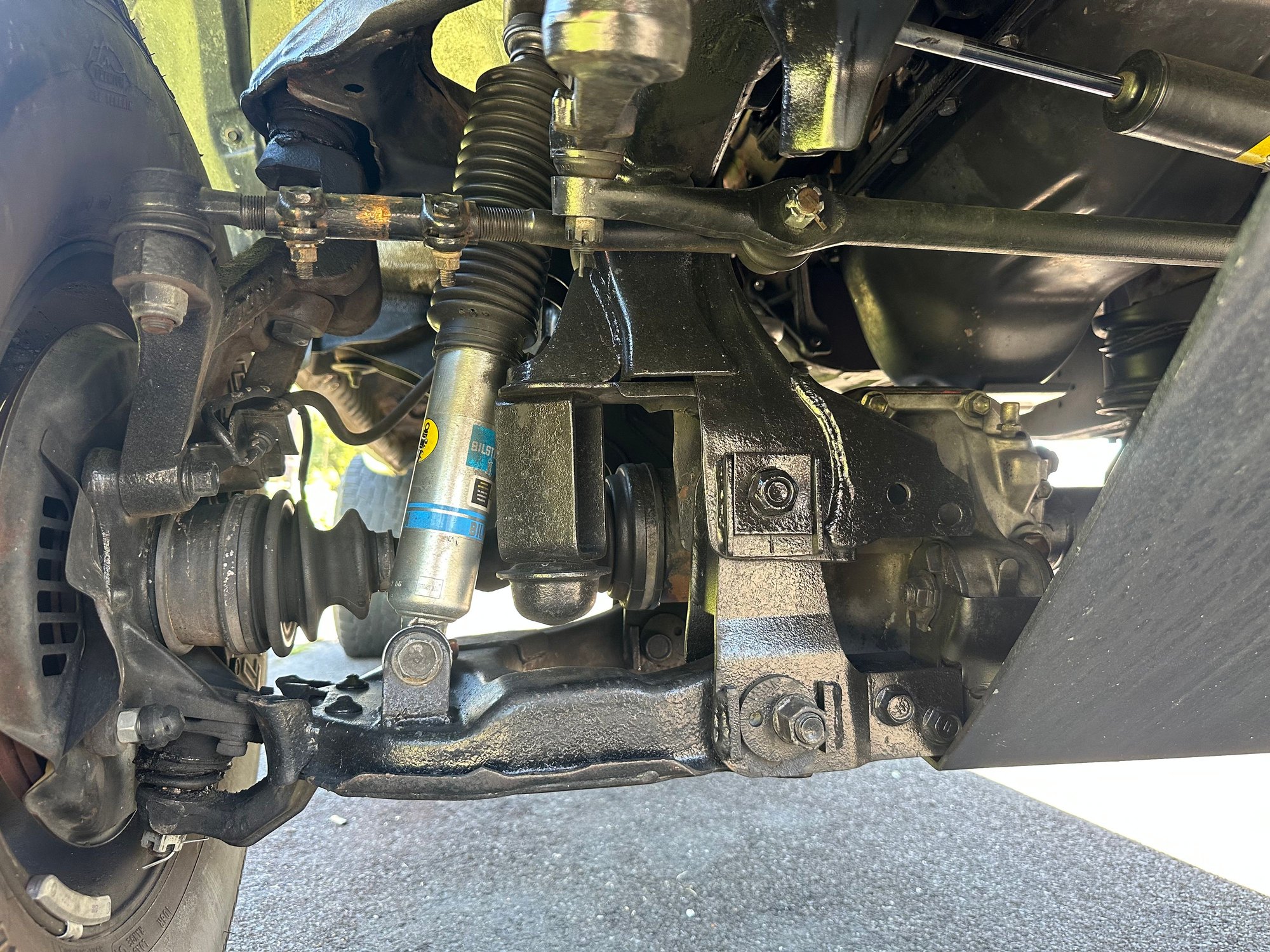

after lowering the bars a little more on each side it’s riding ALOT smoother but now I’m at 16.5” from rim lip to fender edge, I know asking these trucks to ride nice is like asking a newborn to feed itself.

Sounds like you're on the right track. Adjusting the torsion bars is pretty touchy. Especially since you put in new bushings as they will loosen up a little after some driving. It's tough to judge how much to adjust as you go too. Kind of the , little more , little more, dang it too much thing happens.
So try what you have for a few days and see how it goes. If you want more, try a little more. Repeat as needed. Stiffer shocks may end up helping out your softer spring setting??
Also, softening up the rear suspension helps the overall ride more than you would think. If you don't carry loads in the back and it's more of a cruiser, pull a leaf or two out of the pack and see how you like it. Not the most pleasant job dialing in your leaf packs but the results are worth it to me. Really the only way to do it though. I even polished my contact areas and had Teflon pads between the leaves. Rode NICE. I typically pulled two leaves.

after measuring lower control arm mount holes at 4” I assumed to add 4 inches to the OE ride height. I’ve read many different forums that range between 13 to 14 inch measuring from top of rim lip to fender edge. So my target was 17.5 inches and right now to get it at a comfortable ride I’m at 16 inches which to me would mean it’s “technically” riding an inch lower than factory height if you were to take the lift out…. Am I correct in thinking that?

is there any way to identify which brand of lift my truck has? They almost all look the same. Some say 4-5” life but others say 3-4”

Some springs have a part number and or brand painted on them. Typically on the top side. Are you looking for a bolt on kit? If you have a welder and can do some basic fab, there are plenty of U-bolt flip kits and spring swap kits to run Chevy, Ford or Jeep springs. I'm thinking since it's mainly your cruiser, you'd want something that fits what you have. Labor day and Black Friday on the way. Keep your eye's open for good sales.

im talking about the front suspension, after searching a part number I found on the knuckle I think this is an older rough country lift.

Gotcha, IDK about front stuff other than the PO of my 88 (My buddy) had put red aftermarket torsion bars on. No brackets or anything else.
