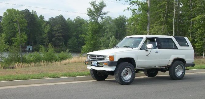

Here is a picture

Looks pretty clean.
Only thing is I bet that Grill guard wobbles like crazy and you will especially notice it at night with the lights on..

I believe he said he has taken the grill guard off. I would probably sell it anyways

check the rear fenders looks like he has fender flares on the back but not the front? It might be hiding some rust.
