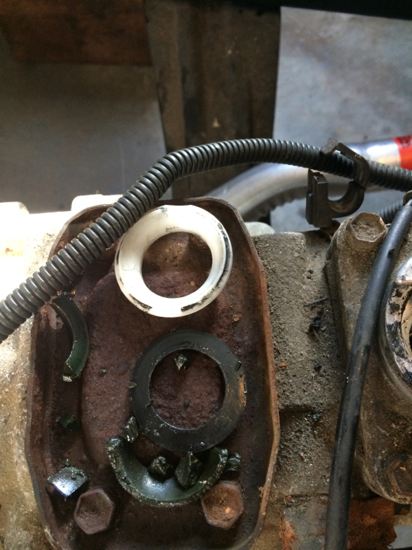

I have a 1994 22re 5spd 4wd pickup my shifter bushings are shot, does anyone know where I can get both tcase and trans bushing? Having trouble find tcase bushing.
94 p/u tcase/trans shifter bushings?-image-1245885122.jpg

Marlin crawler.

Yup, marlin.

Don't think there are any replaceable parts in the T-case shifter.
T.-case seat is steel and steel button on the T-case shifter directly contacts the T-case shifter rails.
Marlin tranny seat and bushing for sure!! I got 'em.

Marlin makes them for the transfer case too...
https://www.marlincrawler.com/transm...avy-duty-seats

Not all transfer cases use them though.
RF1A top shift cases like the one in my '87 4Runner do not, for sure.
