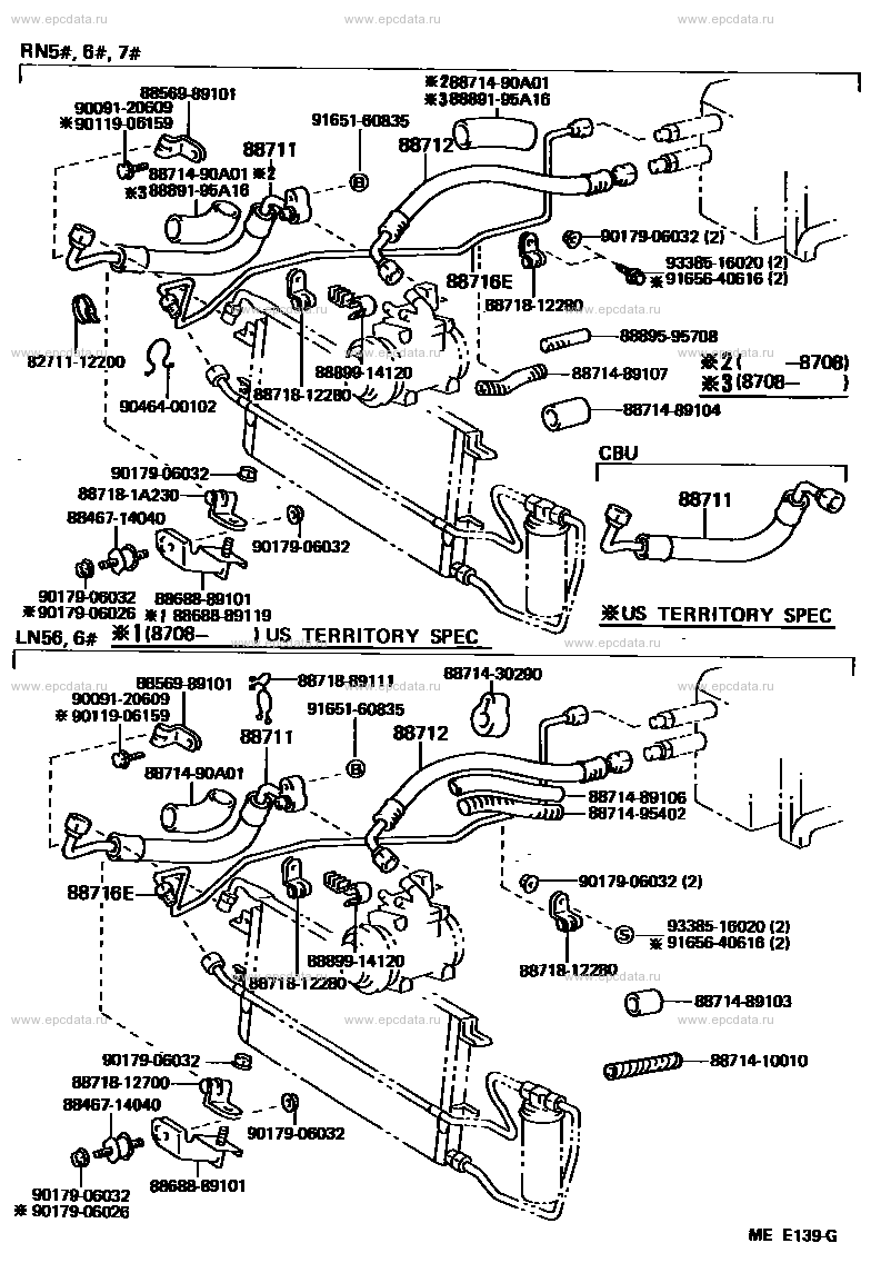

Looking for an A/C part number:
Its the 1st half of the line that runs from the evaporator to the dryer. It has a junction between the radiator and the grille. I'm looking for the line that runs from the firewall through the engine bay to that junction. I believe this is the High side line. Anyone know how I can find a part number for this? All my usual searches haven't helped.

88716E?

whoa! nailed it. Where are those diagrams from?
Thank you so much!

I was on Amayama. They use toyota epc data

got the part ordered at the dealer. I wanted to make sure I was getting the right one as far as dealer or factory installed ac, but turns out it would be the same part.
i had to show the parts counter guy the diagram you posted, so thanks again!
