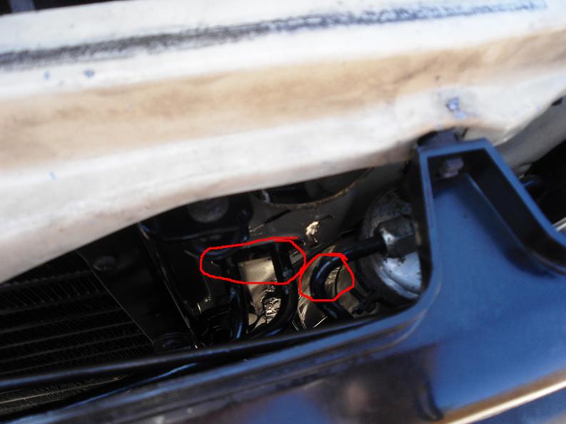

In the manual it refers to this line as the AC liquid Line tube.
While i was driving with my ac on, i see white smoke coming from under my hood. my temp was still in teh normal middle position. i pull off on a street and open the hood and the freon? is spewing out of the line, from a hole.
im thinking my power steering cooler may have melted it, its got a weird indent in the line that looks like it was rubbing on something, but nothing could do that, the ac condensor is hard mounted in between the grill.
where have you guys who fixed your ac bought lines from? vatozone couldnt find it on their comp, and 2 junkyards that i tried had yotas but didnt have ac systems in them.

It make have been damaged in a previous accident...

ac's never been moved from truck, no front end collision. only accident was me standign still at 0mph, and a nissan sentra hit my rear bumper(used to have huge steel one) at like 5, took out her headlight, grill and bumper, but just lifted my truck up.
i went to a bunch of parts store, ac repair shops, no1 could get one, one hsop wanted 100 to repair the pinhole
ordered it from the dealer for 25
