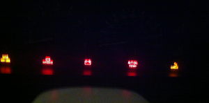

I was having a weak start problem with my 1995 4Runner 3L V6 2 weeks ago. I pulled the starter and replaced the contact points and plunger which seemed to fix the starting problem.
But, when I went to start her up 2 days ago I had the same weak start problem where I would have to hold the key for 3-8 seconds for it to get going. Then, later that day, it wouldn't start at all. It doesn't turn over. I can hear the starter spinning. I also noticed that when I try to start the radio and clock shut off. I get these warnings on the dashboard (the rear anti-lock light is always on though)'95 4Runner won't start, won't turn over-yeeof.png
The lights turn on, radio works, clock works, dash and interior lights come on. I used a multimeter to test my battery and got 12.49v .
Any ideas on how to proceed?

Put your voltmeter on the battery and turn the key; I'll bet it drops below 9v. Which is not enough to engage the starter (it's not even enough to keep the clock running!)
Your battery is really low. You could try charging it first. If that helps, put your voltmeter on the battery with it running. If less than 14v you're not charging.
But I'm guessing it's end-of-life for your battery.

Starter Spinning Means No Engagement with Flywheel
Originally Posted by GreenMachine954
...I can hear the starter spinning. I also noticed that when I try to start the radio and clock shut off. I get these warnings on the dashboard (the rear anti-lock light is always on though)
Accessories turning off and those indicator lights are normal when battery voltage drops during cranking, Surely check battery condition.
However, starter spinning means your starter is getting enough power to turn it, BUT mechanism that should make starter gear engage flywheel is not working, or gear and/or flywheel gear has worn out teeth. Checked those?
