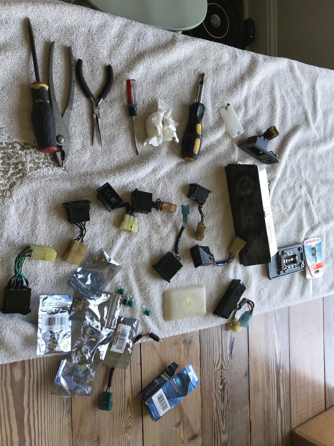

Cleaning small items and swapping in LEDs on all
interior switches and bulbs.

How did you order the bulbs? Do you have the number parts or the type of bulbs for every switch/interior light?
Old Jul 8, 2018 | 02:04 PM
  #68
Charles4x4's Avatar
Joined: Apr 2017
Posts: 488
Likes: 18
From: Birmingham, AL
Great question. I haven't mastered it just yet, but I'm getting there:
Dome: 3175
Doors/Cargo: 3021
Dash/Altimiter: T10 168
Small Stuff like Shifter Light: T4 Wedge 3528
Small Switches: T4 Twist Bulb
License Plate Bulb: 1156 (single bottom prong)
Brake Light Bulbs: 1156 (double bottom prong) - Haven't checked all of these though

Speaking of interior lights, does anyone know if there area actually bulbs in these:
- Rear Window Lock
- Rear Defrost Switch
- Rear Windshield Wiper
I believe they all light up, but cannot find a twist in bulb. I haven't opened them up yet as I was afraid I'd break them and it wouldn't make sense for them to have bulbs inside when all the others have twist type bulbs on the outside...
UPDATE:
There are bulbs in these, but I'm afraid of breaking the switch to swap them out. I did see an OEM Toyota Replacement bulb at the dealership - but my LEDs don't have long enough wiring to fit anyway.

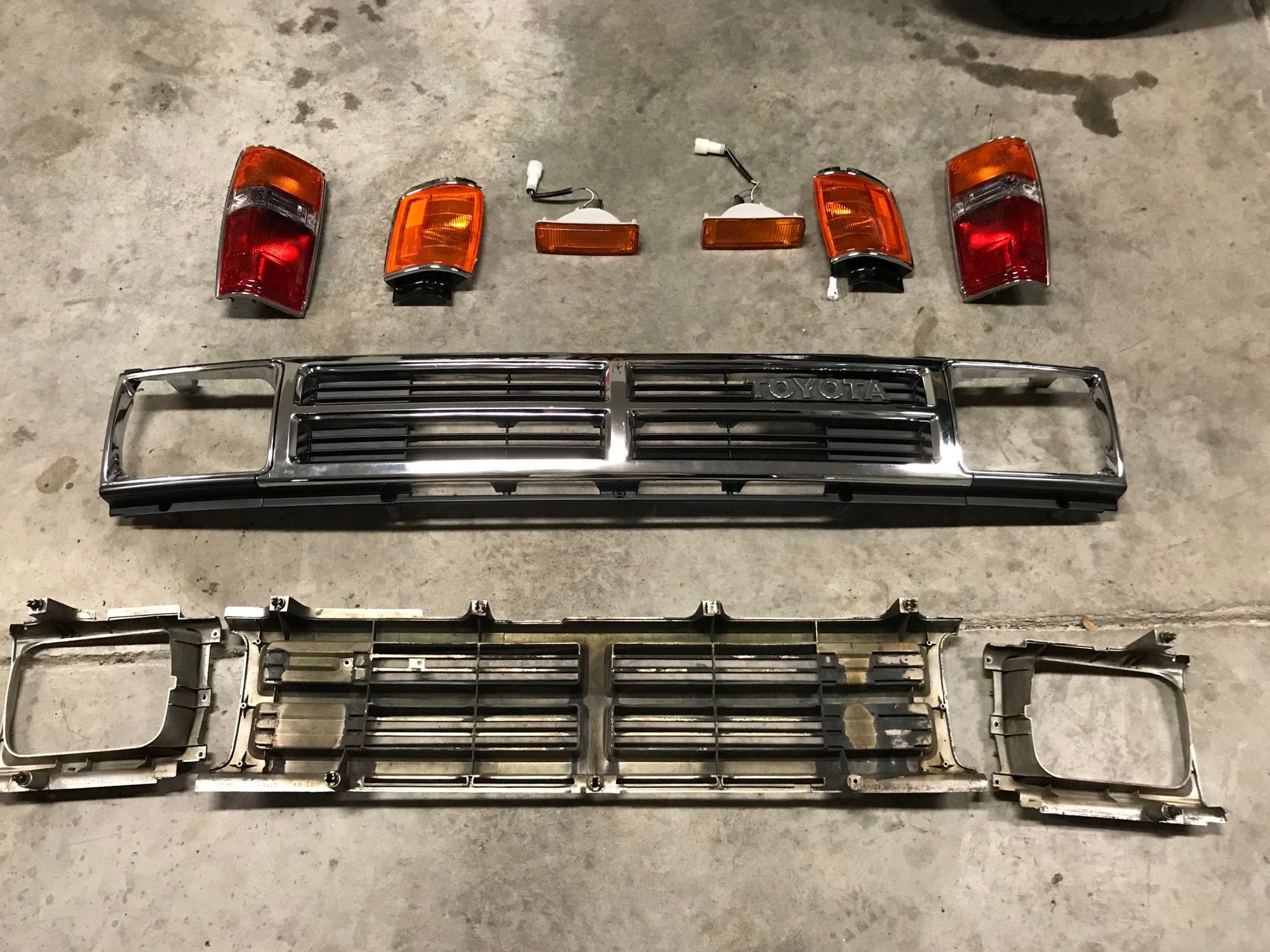

Getting front end ready for install once the truck is back from paint. All brand new!
