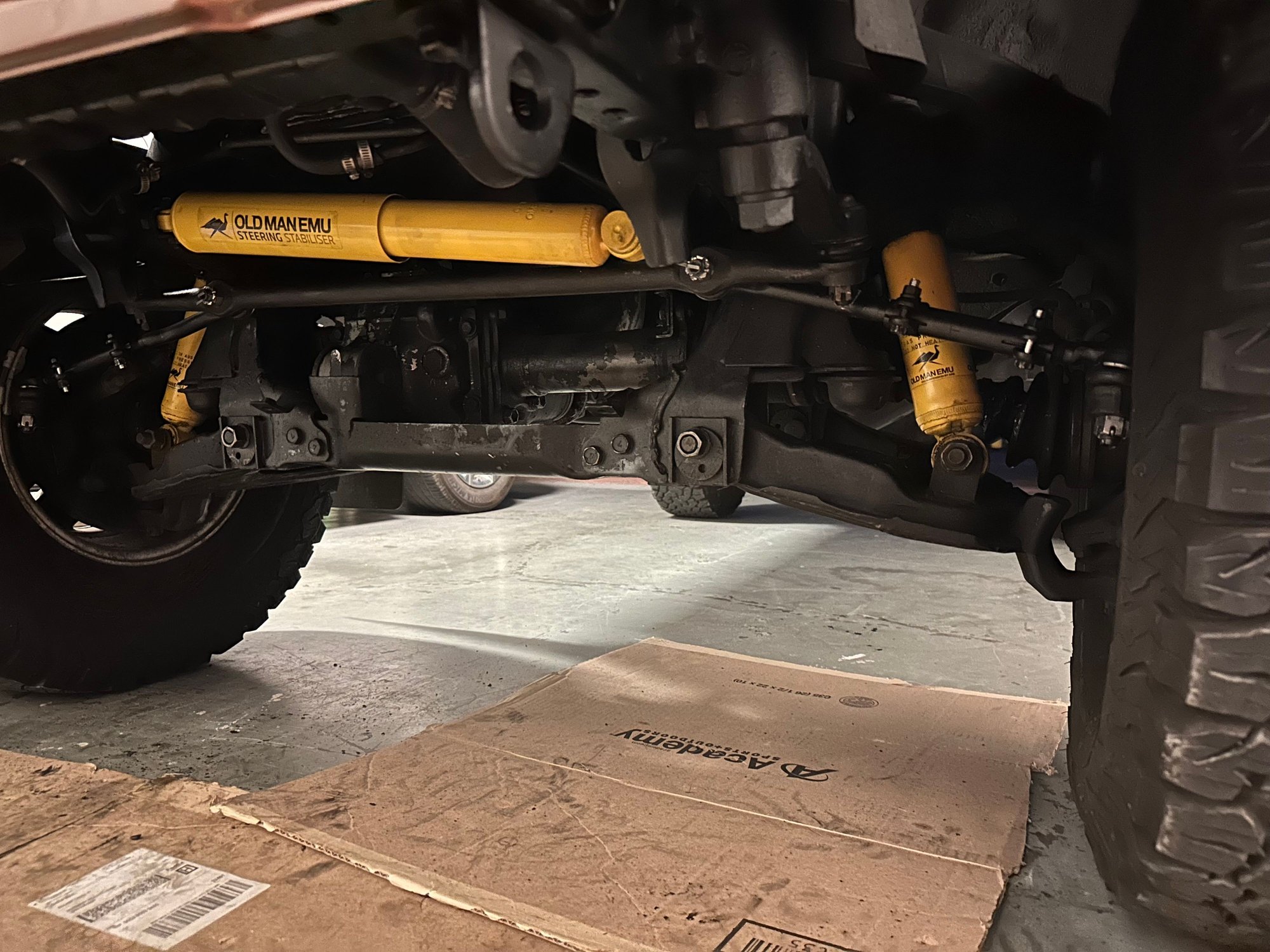

Update:
Everything with the 87 Turbo has been great the past few years. Just regular maintenance and it’s been a blast to drive! I think we had one minor coolant leak that we repaired and that’s literally it.
However, over past few months the steering had gotten looser and looser and finally I pulled the skid plate off, jacked it up, and found the problem. After 30+ years, the tie rod ends had finally worn out. So, I got brand new tie rod end assemblies from Toyota (new outers, adjustment sleeves, inners, and even hardware) and pulled out the OME Steering Stabilizer I hadn’t ever installed during the build and got to work.
Took a few hours and ruined a few tie rod end pullers, but it’s done. Steering is super tight again and the new OME steering stabilizer certainly seems to be more solid.
Hopefully it all lasts another 30+ years. 😃
