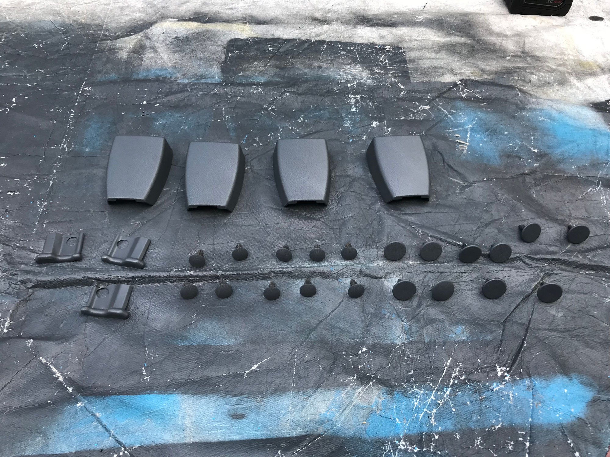

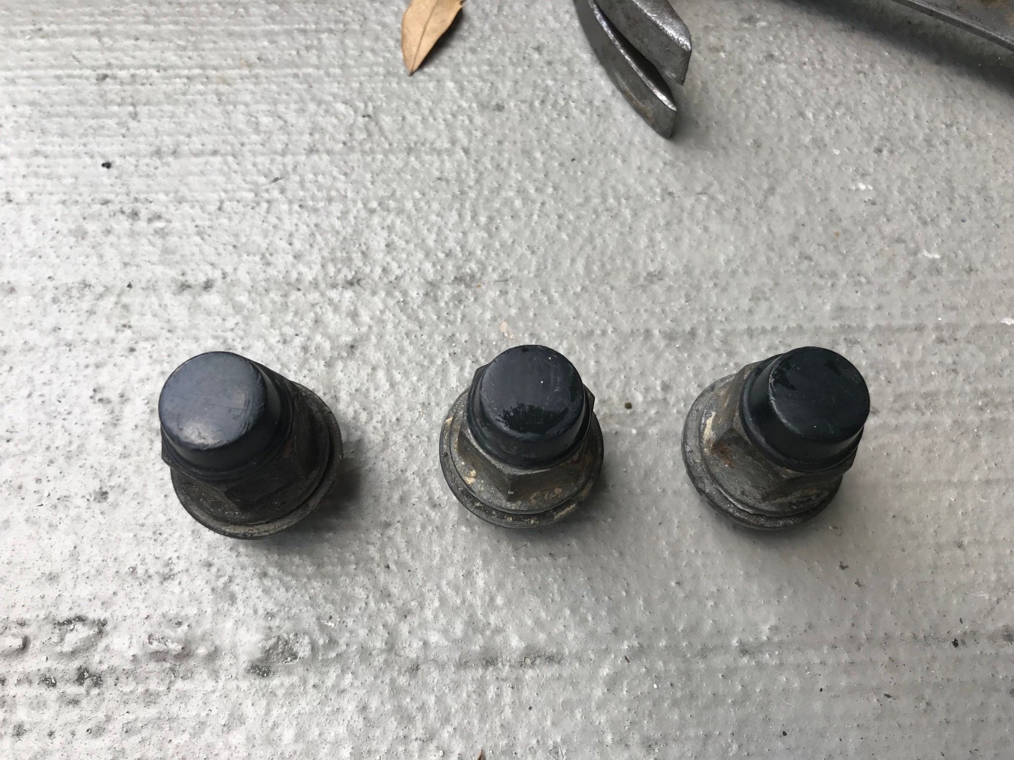

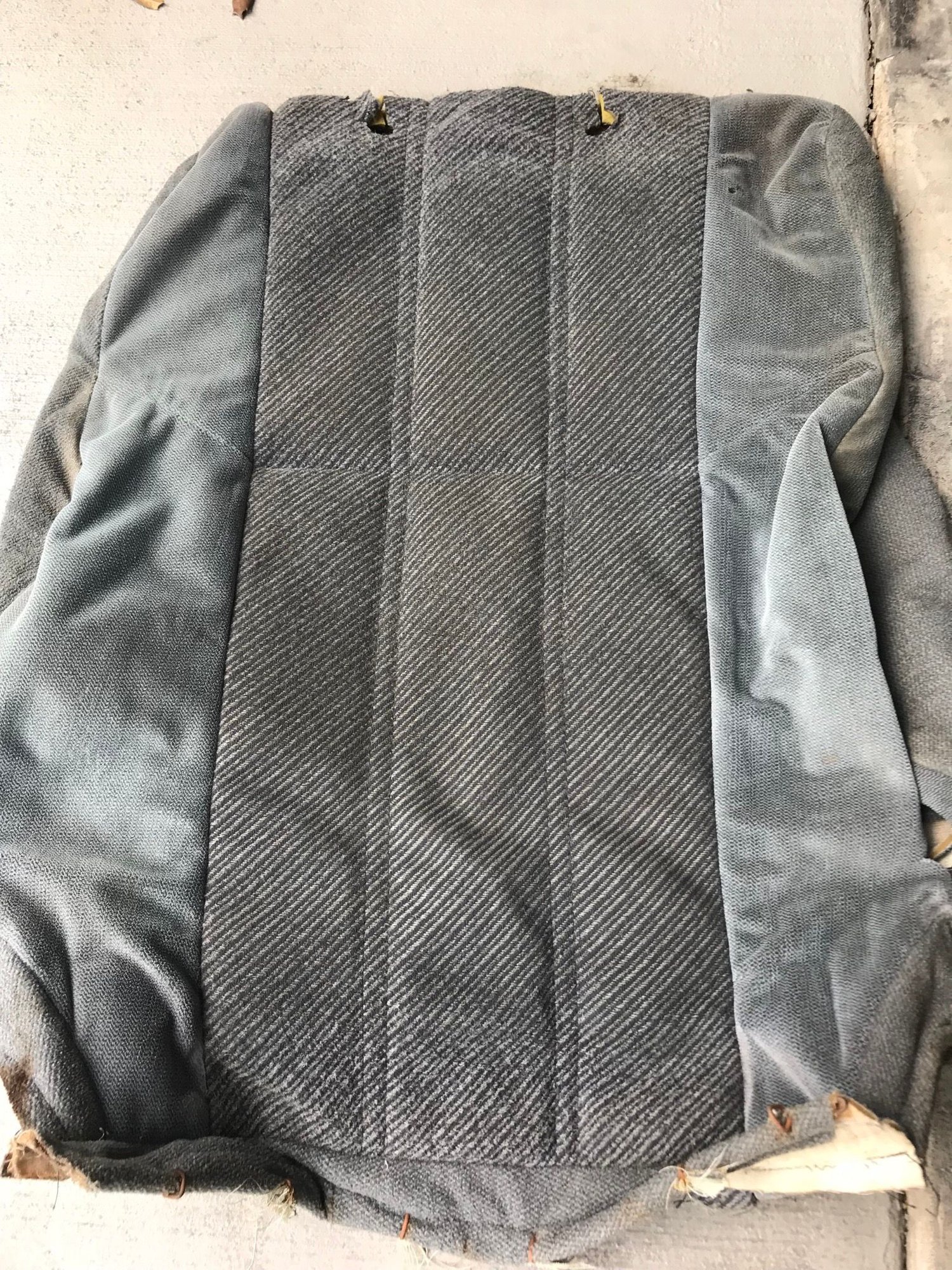

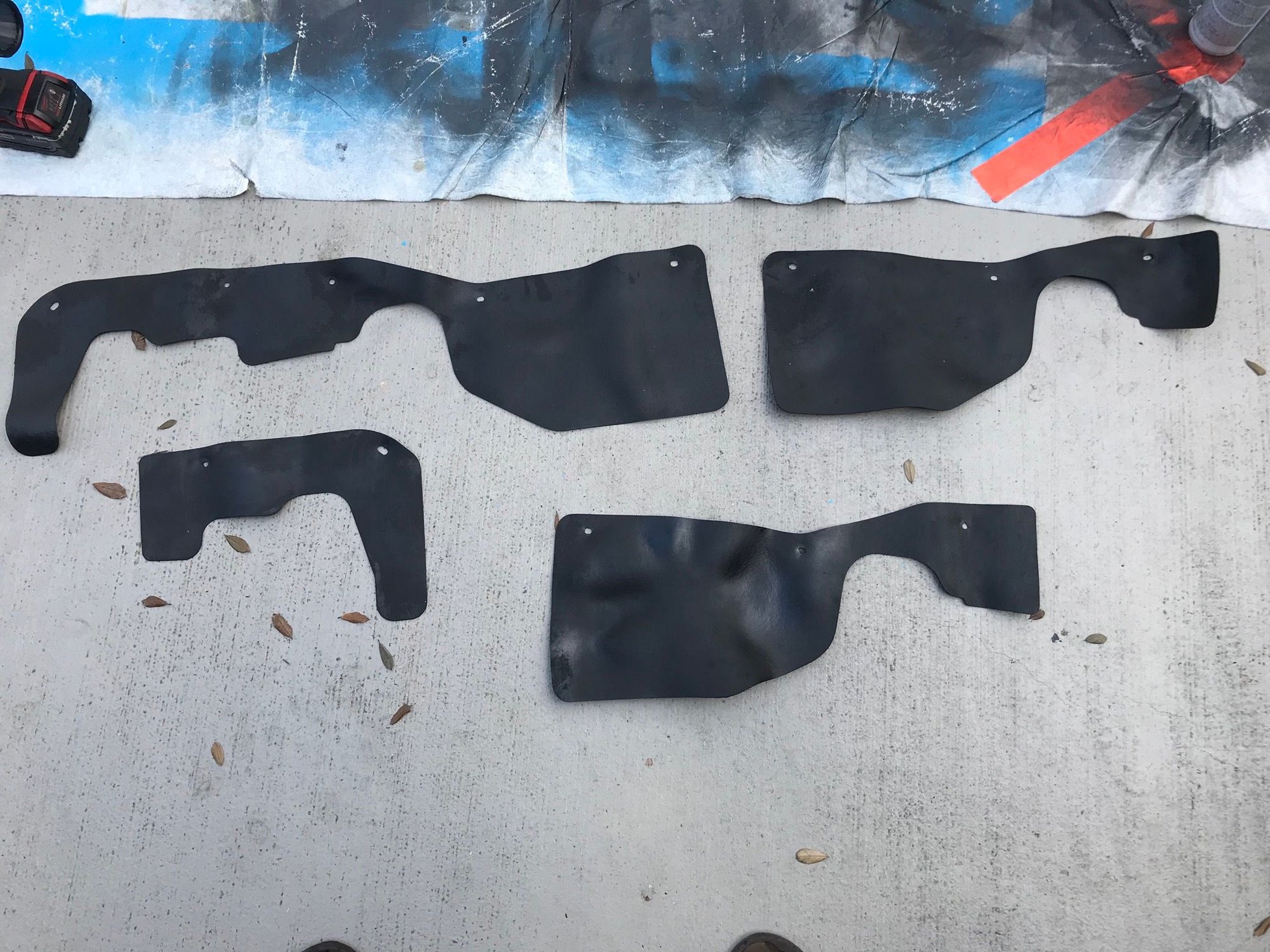

Wrapping up small stuff. Sourced the 4 rear seat hinge covers, rear seat cargo carpet trim end cap, 3 OEM lug nuts with caps, engine bay splash guards, and passenger seat upper fabric (will sub in for my drivers seat town bottom fabric).
All came from a nice guy in IN with 3 first gen 4Runners in his barn! Barn Find.

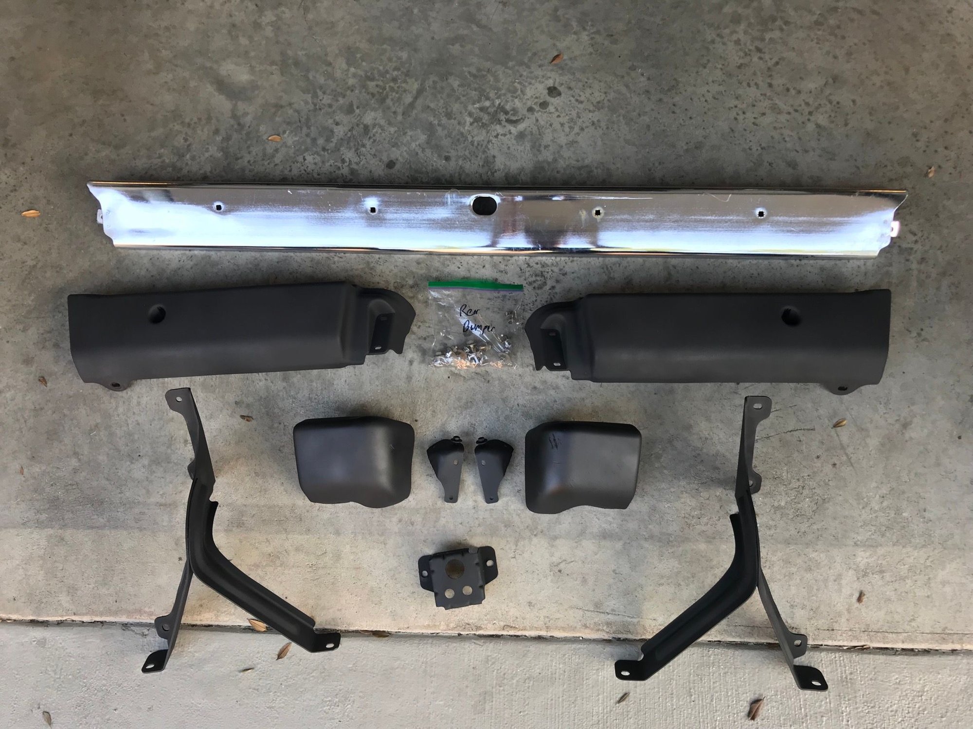

Contacted all the 1st gen sellers on Ebay and after 3 weeks convinced one to sell me a rear non-step bumper, brackets, corners, and all hardware (I’m not a fan of the step version or aftermarket options).
This was a big one to check off the list!

Originally Posted by Charles4x4
Contacted all the 1st gen sellers on Ebay and after 31 weeks convinces one to sell me a rear non-step bumper, brackets, corners, and hardware (I’m not a fan of the step version or aftermarket options).
Nice score!
OEM examples are hard to find, and almost impossible to find one that has not rusted through or bent beyond reasonable repair.
You got extra lucky with all of the brackets and hardware!

Originally Posted by old87yota
Nice score!
Thanks! Took a 2-month nightly search for the bumper! Of course, the day after I purchased it, another one popped up on CraigsList but it didn’t have brackets or hardware.

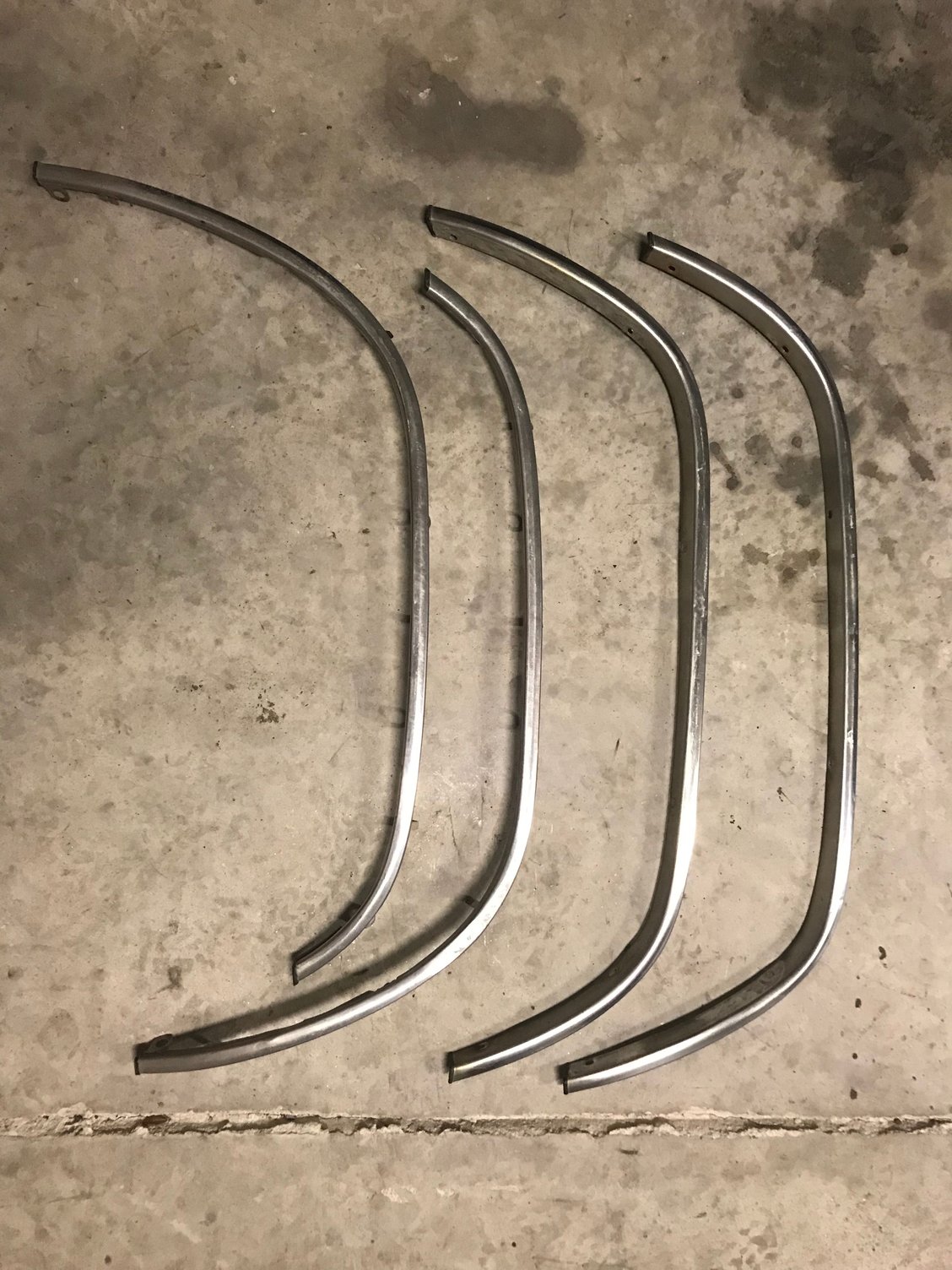

Cleaned and hammered out imperfections in the chrome wheel well trim tonight.
Rear ones are original to this truck. Front ones were damaged too much for me to repair so I picked up alternates off eBay a few weeks back.

Originally Posted by Melrose 4r
Any pointers on this process? I have to do all mine.
I held a razor blade flat to get stuck-on gunk off (don't let it get vertical as it'll scratch of course). I used a big allen wrench that I could lay down in side the track and hammered it against the garage floor to get out small dents. Then just bend some of the areas back into position.
I'm guessing I'll have to rework some of the sections a little more when I install, but I think the big allen wrench laid down inside the track is the best tip I can give - it made short work of small dents and imperfections while keeping the material flat. Mine aren't perfect, but they are much better than they were.
