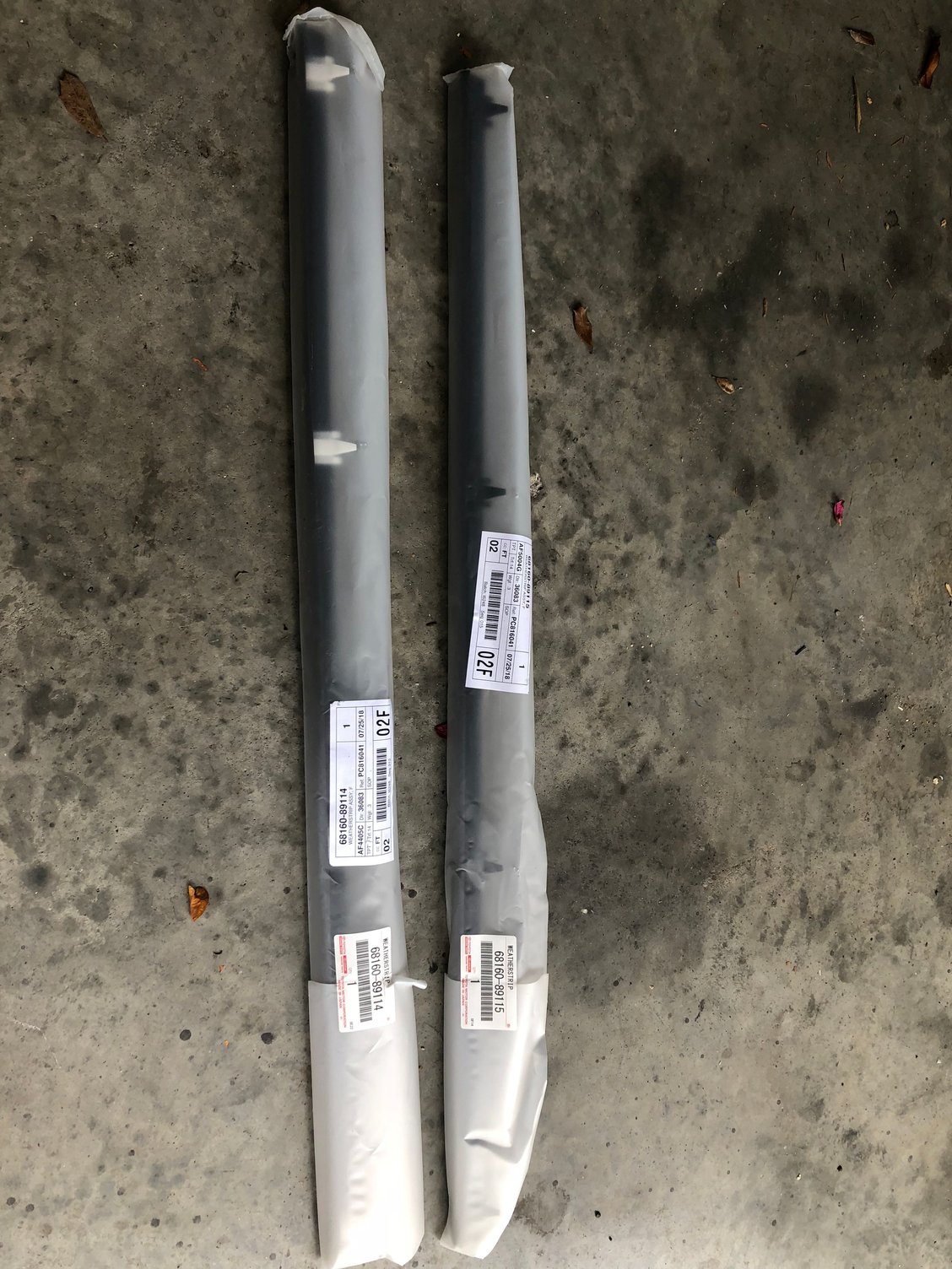

New OEM Driver and Passenger weatherstripping.

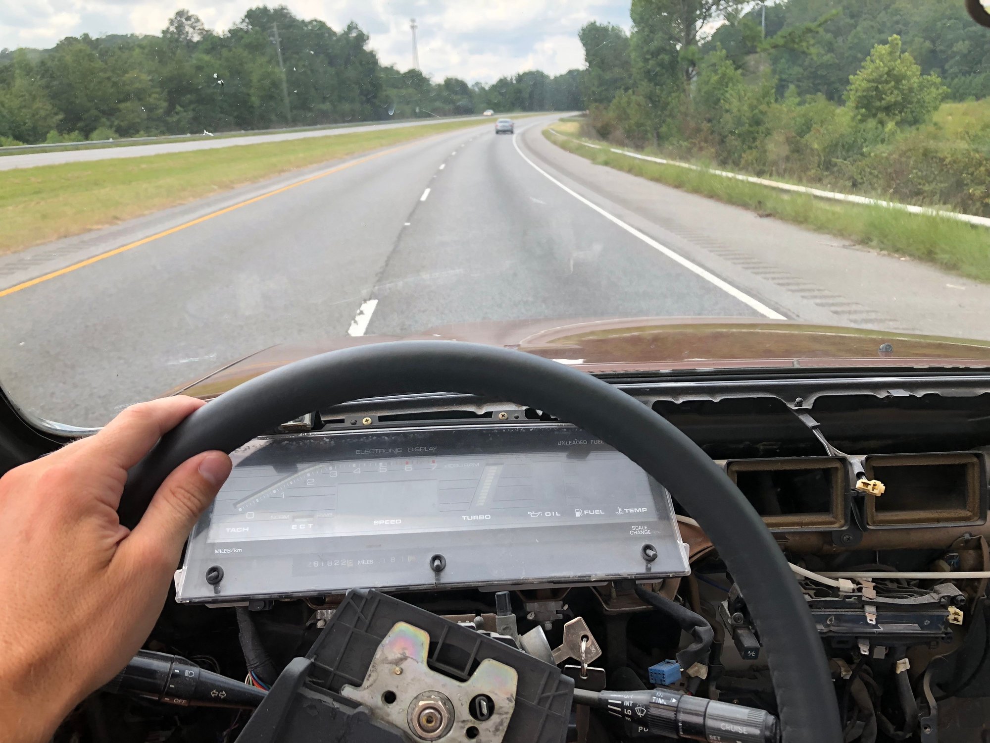

No description required. This drive home was an adventure!

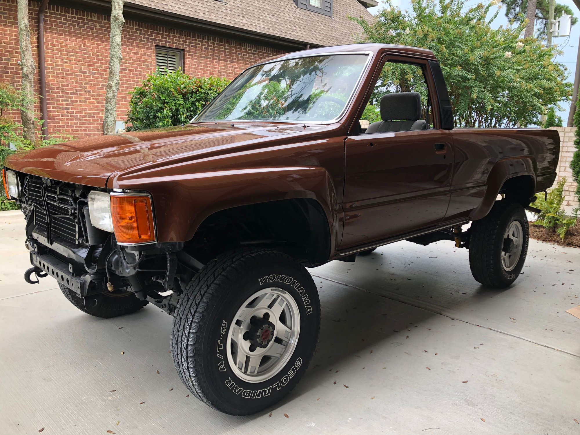

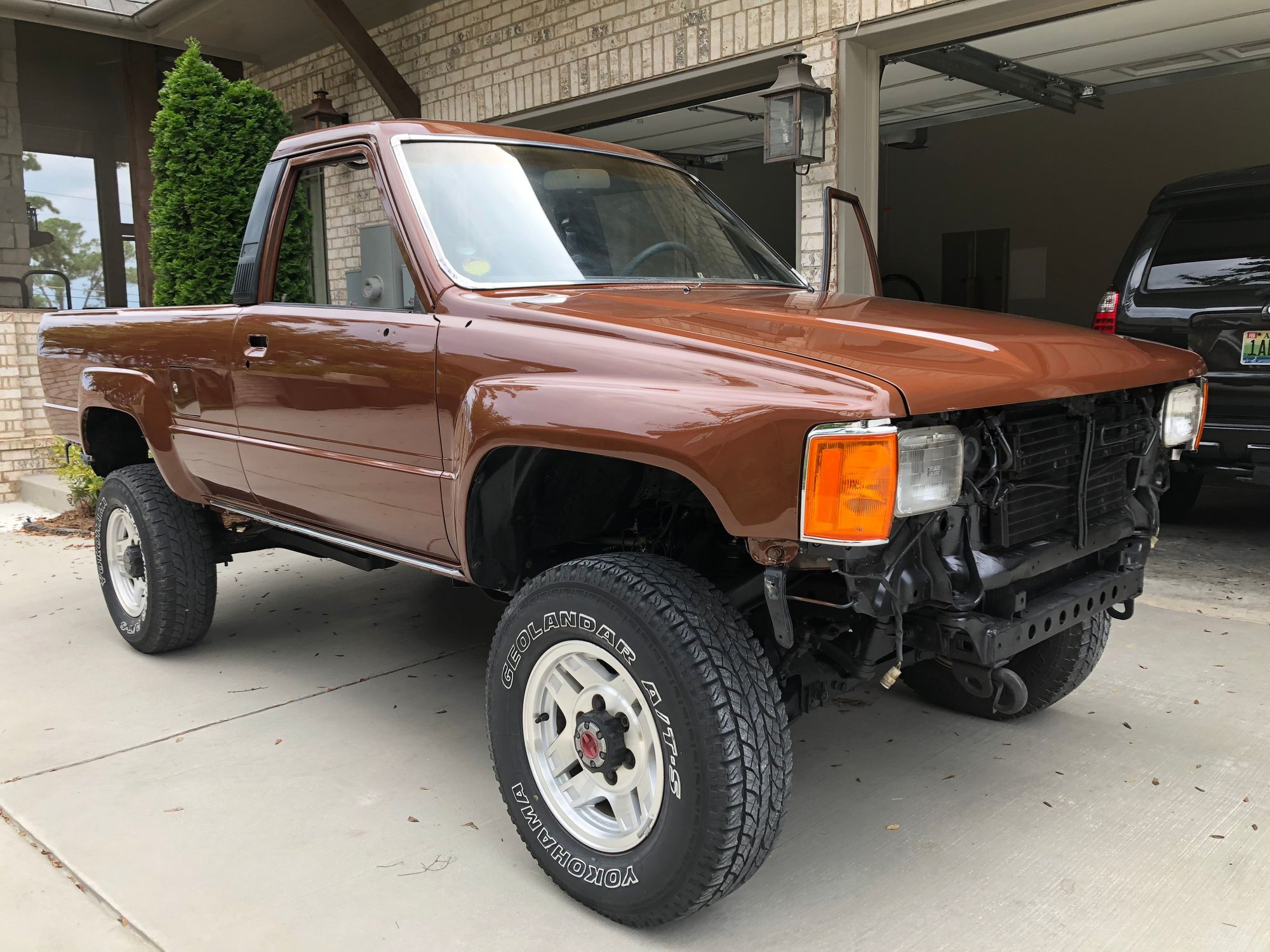

WOW!
The new paint looks fantastic!

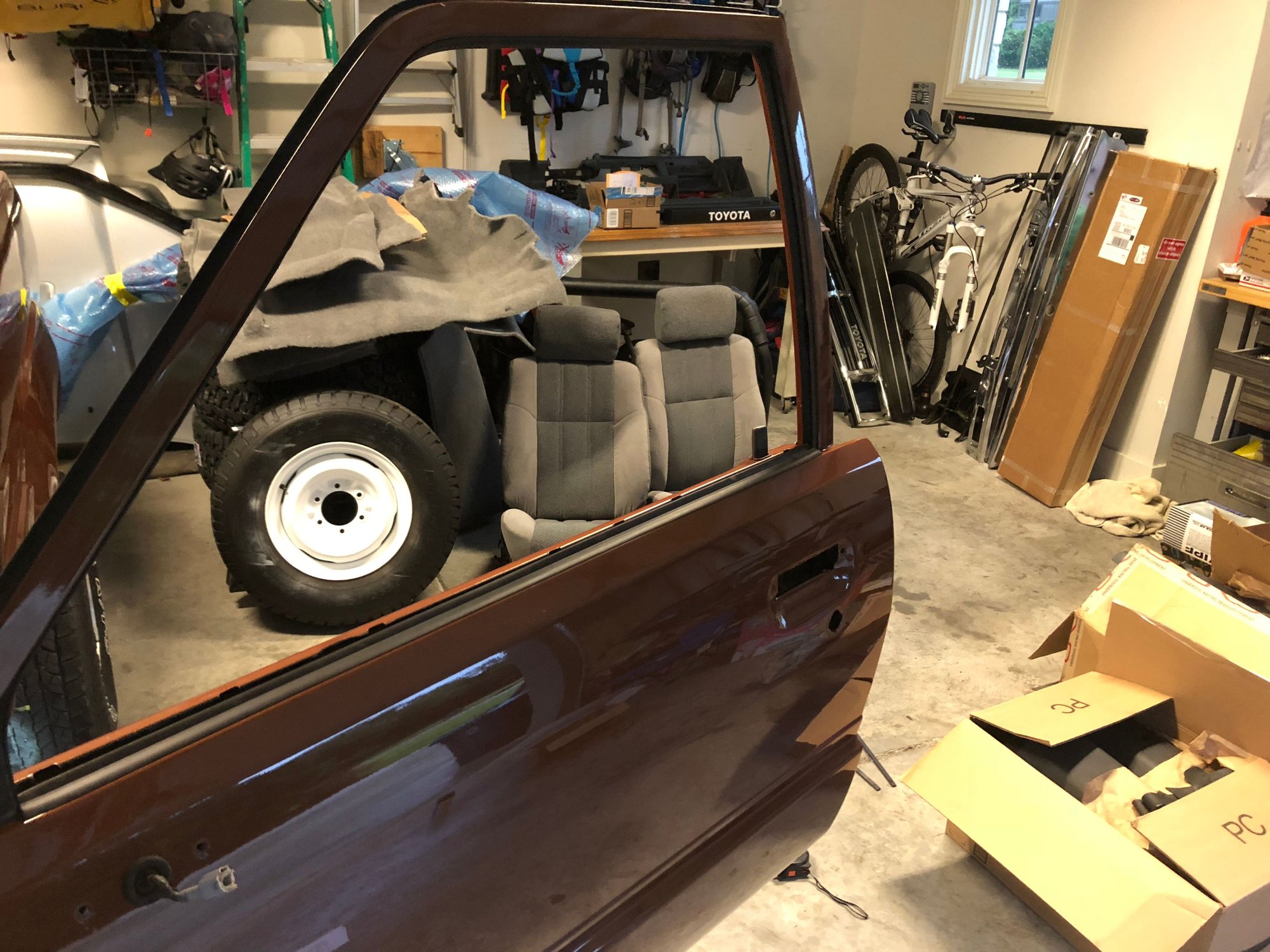

From: Birmingham, AL

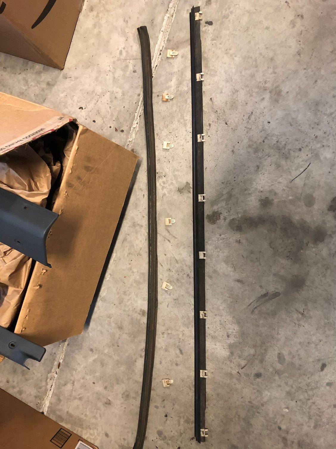

New OEM window runs

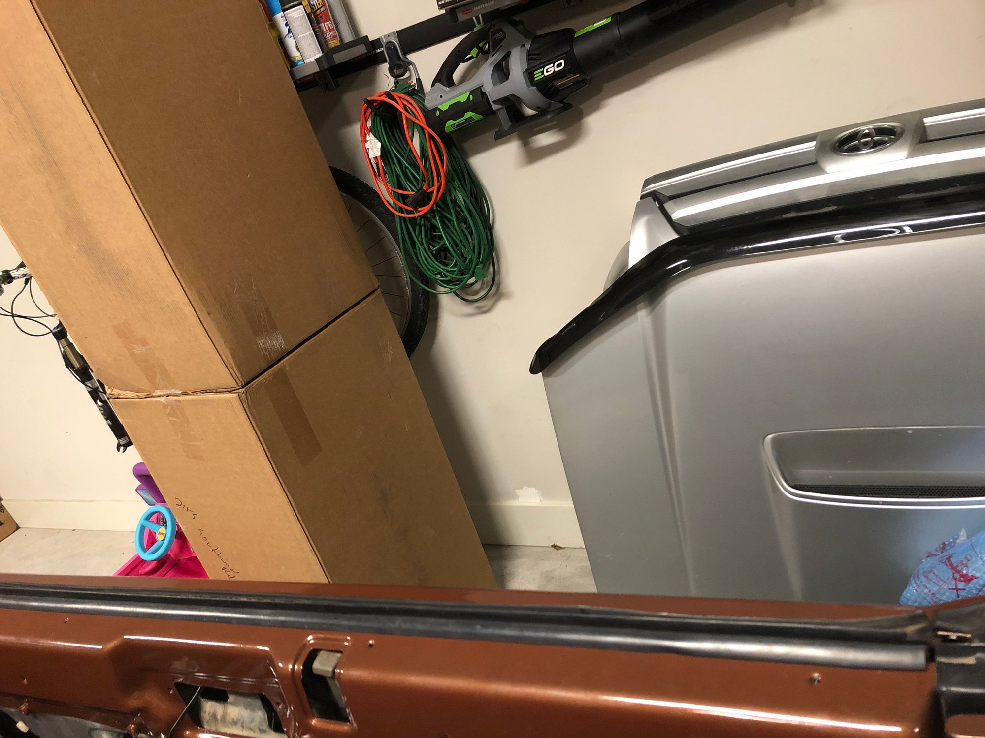

Windows done

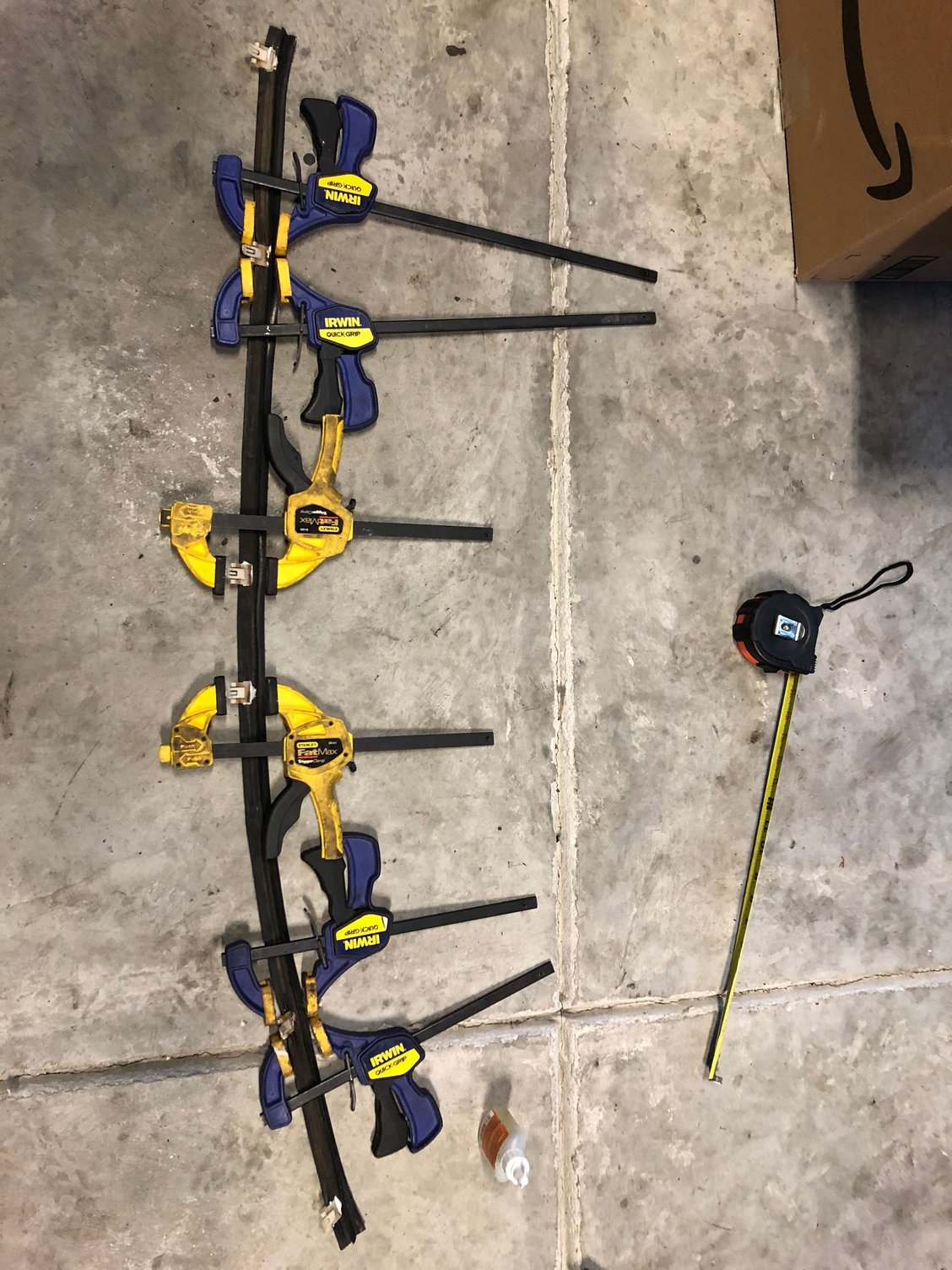

This should hold the clips on well.

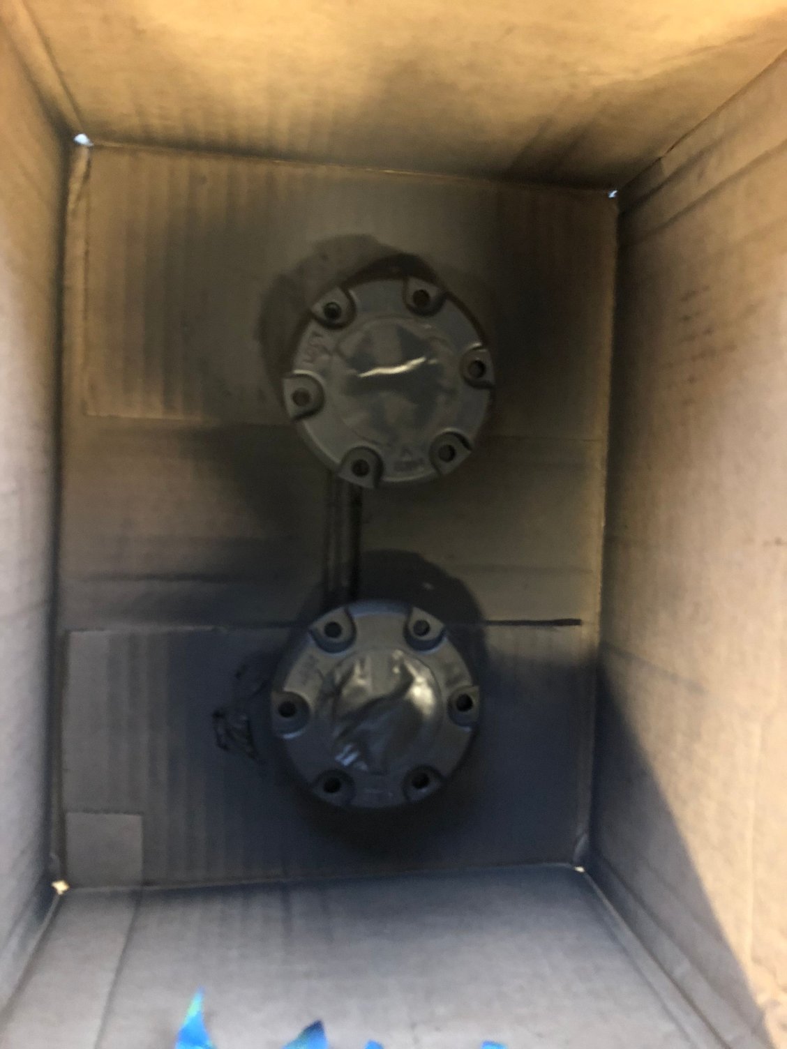

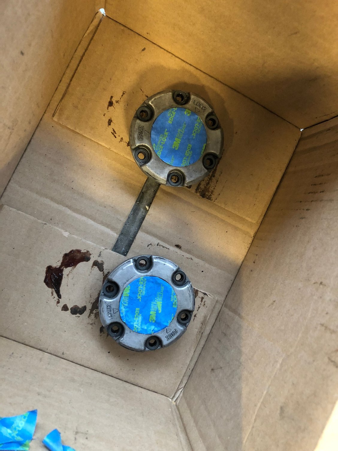

I think the hub face plate is supposed to be black, not silver!

My repairs to the clips worked great. Tailgate weatherstripping done!

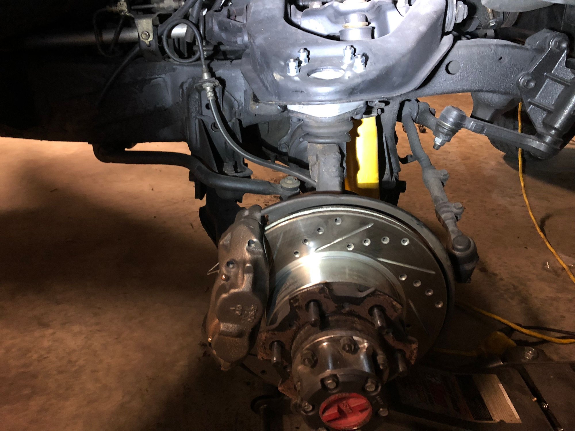

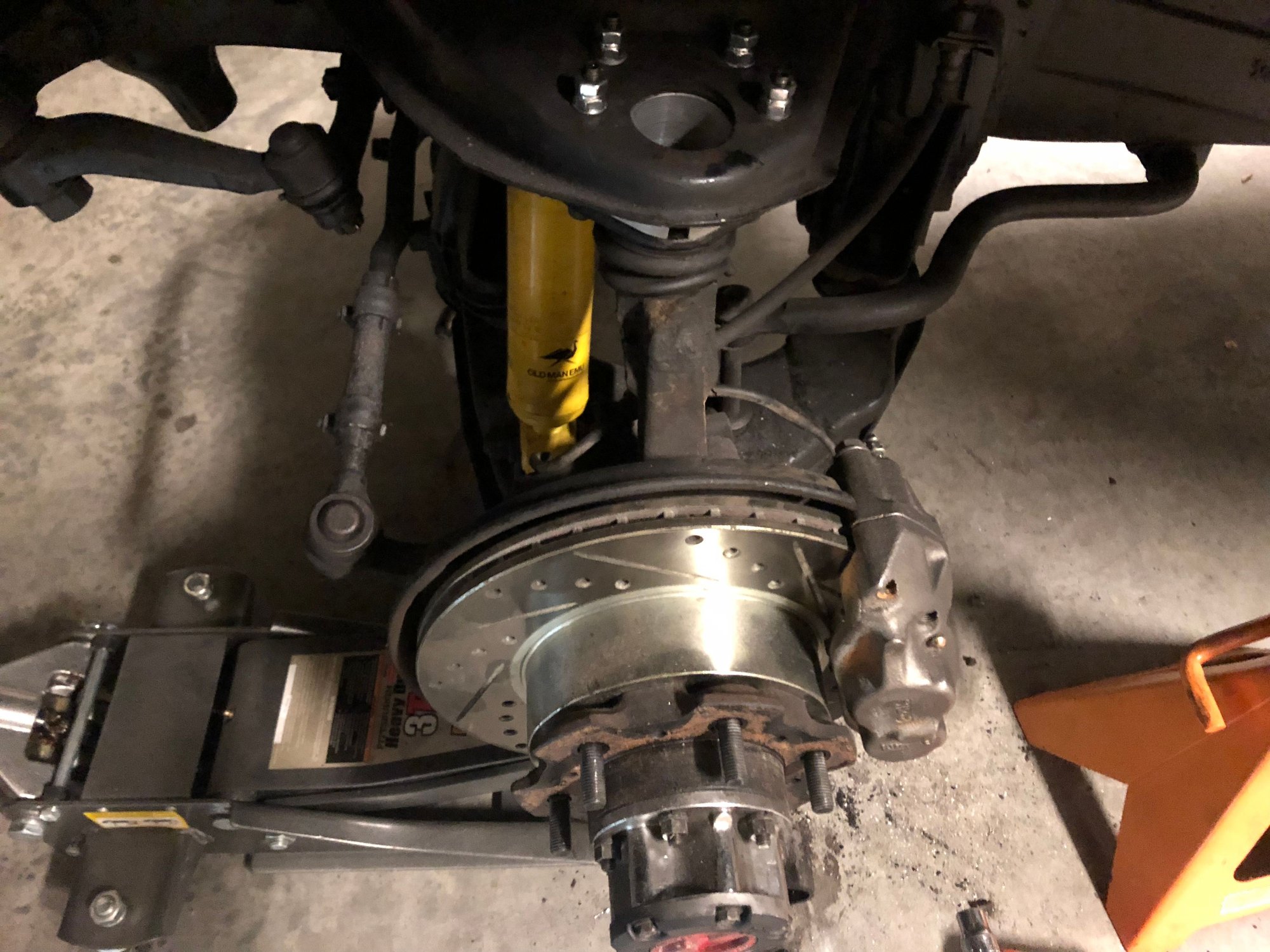

Didn’t like how much I had to crank the OME Torsion Bars, so I decided to install 4Cralwer 1.5” Ball Joint spacers and take the load off the T-Bars. Should have been a simple project, but one of my Ball Joint presses in bolts was seized and I had to drill it out.
One side down!
Old Jul 31, 2018 | 07:13 PM
  #155
Charles4x4's Avatar
Joined: Apr 2017
Posts: 488
Likes: 18
If anyone is considering the 1.5” BJ spacers, here is a tip. Pound the BJ bolts out before you drop the Bj out of the upper control arm.
Maybe obvious to everyone else, but I didn’t on the 1st side and it saved me 30-Mins the 2nd side!

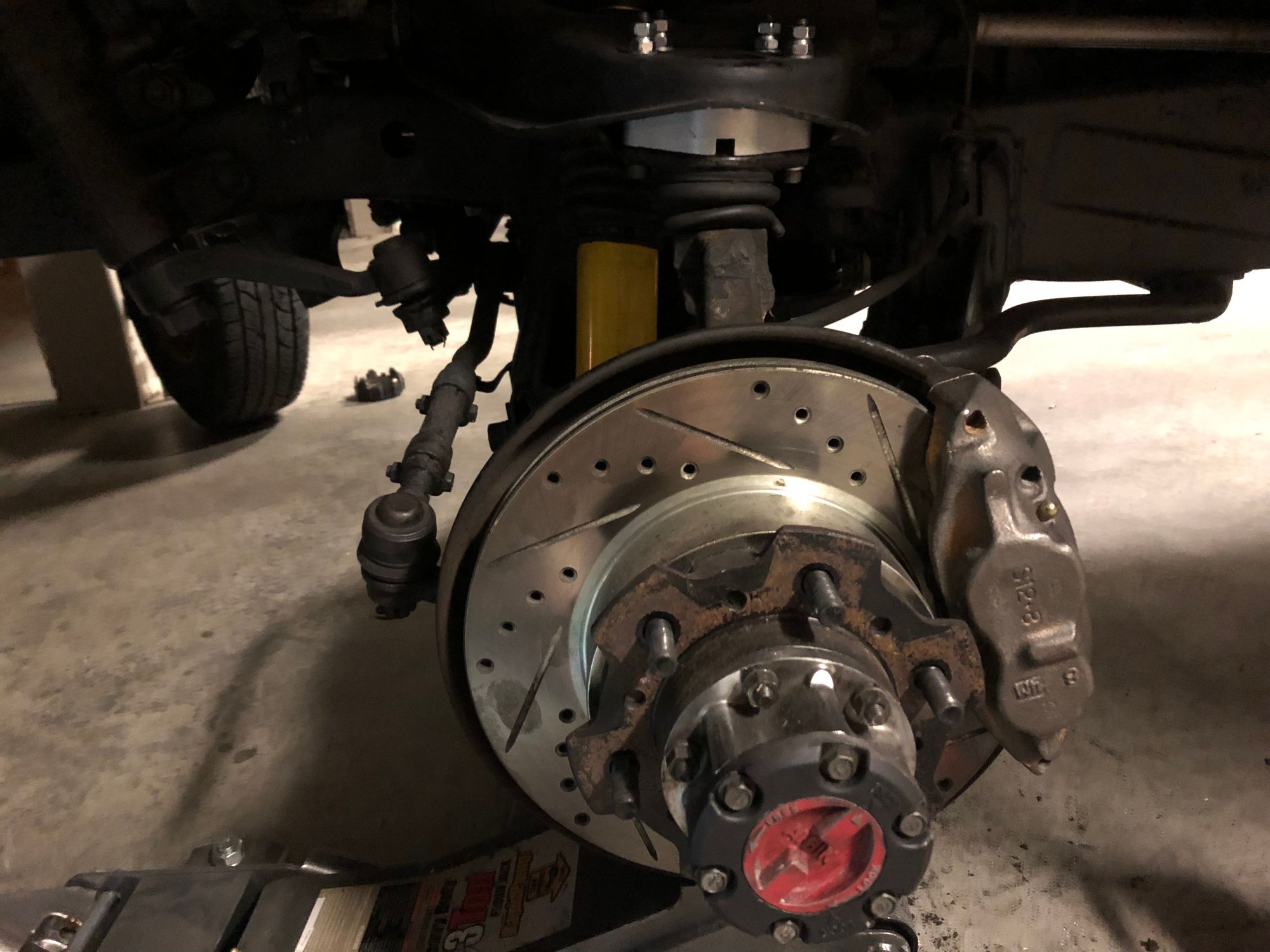

Passenger side done! I noticed I forgot to put the notch at the bottom to let water out, so it all came back apart and is now done (for the 2nd time)!

The spacers worked great. I have -0.25” of thread now showing on the t-bar screws and am at 16” from lip of the wheel to bottom of the fender on both sides. Looks perfect Front to Back.
