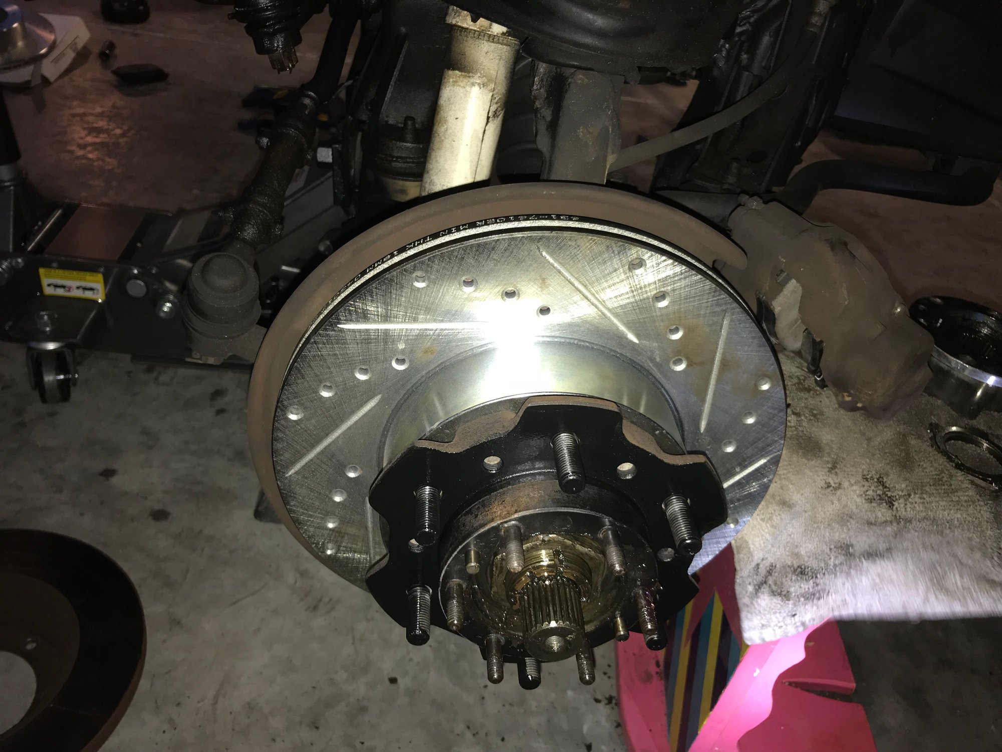

Installed new slotted and drilled rotors and ceramic pads. Unfortunately one of the calipers is siezed, so have to get new ones of those too.

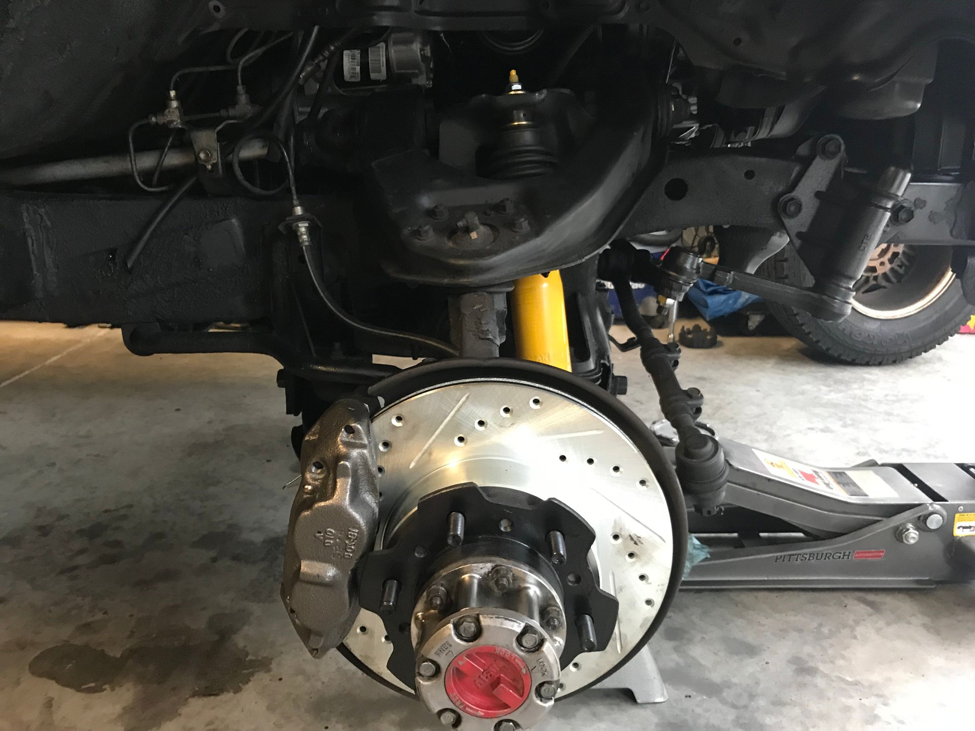

New calipers installed.

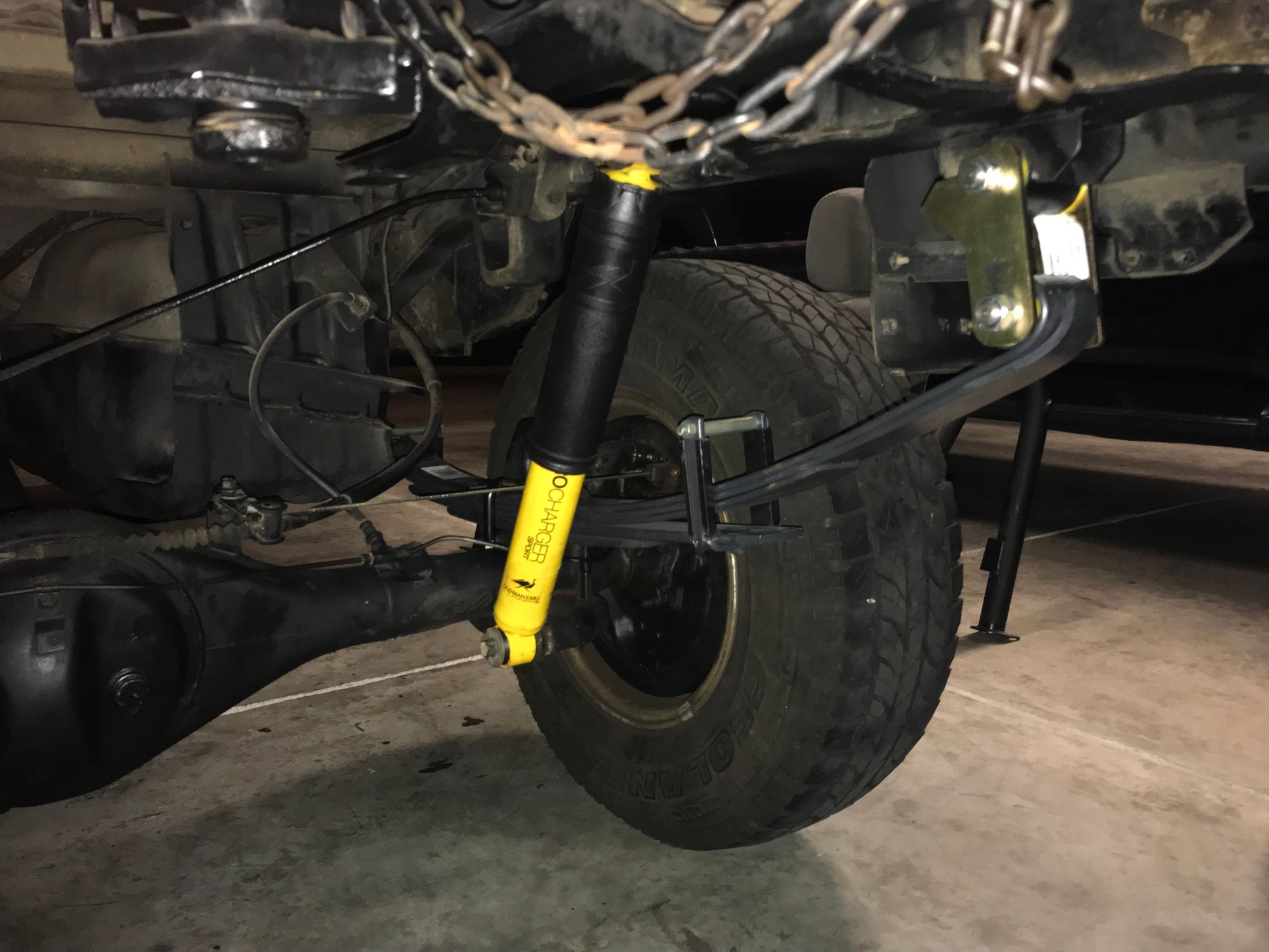

OME Dakar’s were way too stiff, bouncy, and high (even not broken in), so I removed the 3rd leaf down - per instructions from ARB on another thread on here. Fingers crossed these are now perfect.

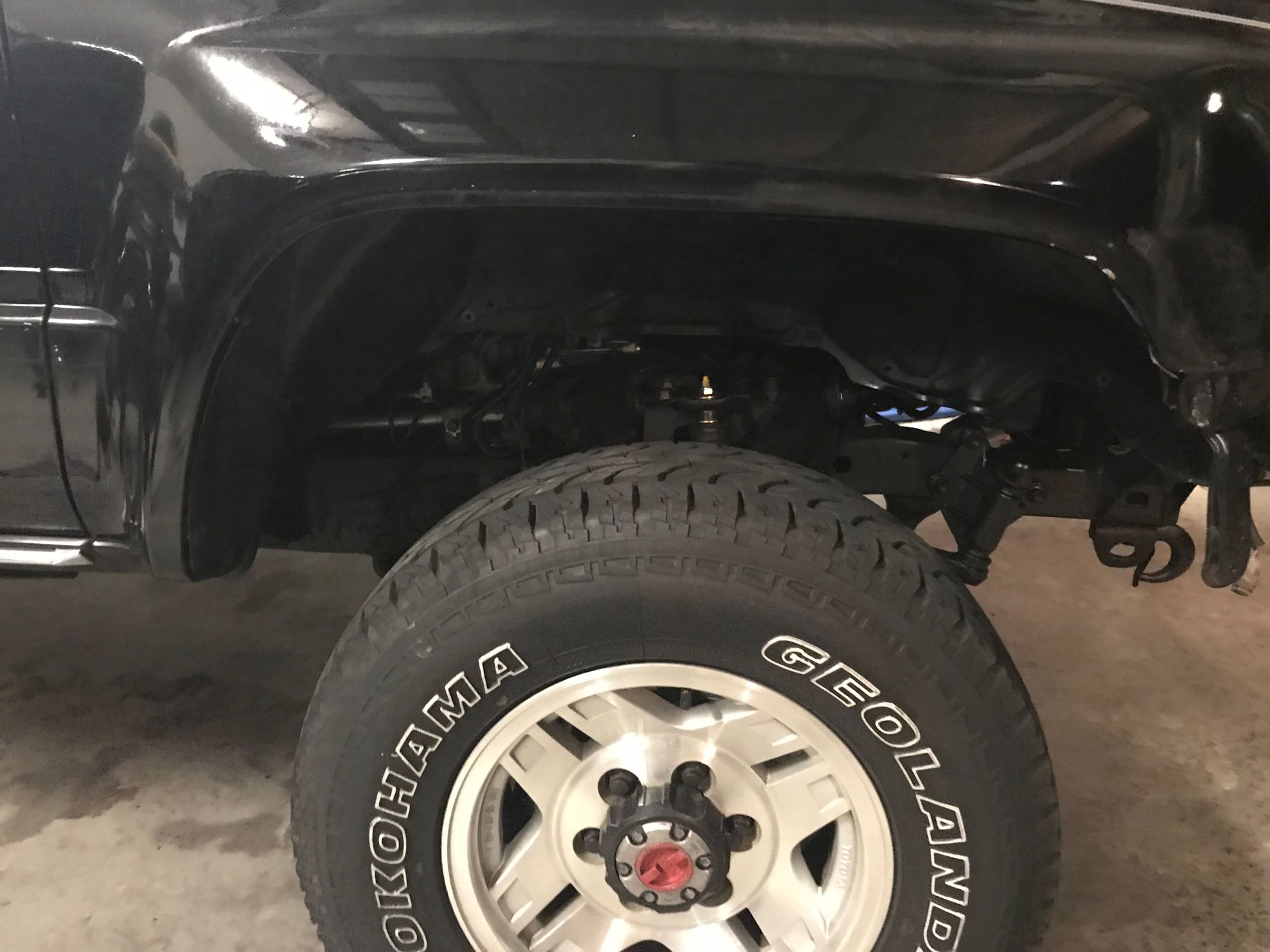

Torsion bars cranked to 1.5” of thread above the bolt in the front on both sides. OME Dakar with 3rd leaf removed in the rear. Sitting 0.75-1.0” higher in the Front Tire Top to Wheel Wheel Bottom. Should go a little higher in the front as the rear settles. And I can always crank down the front if it settles more.
Rear shackle angle looks about perfect now.

Photos with the lift and new tires, please.
The 4r looks perfectly leveled, rear and front.
What did you do to the rims (or the PO)? Are they polished?
Underneath looks very good, do you know what the PO used to paint it?

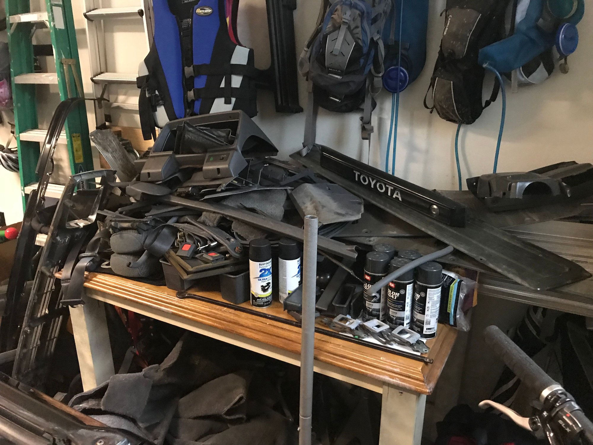

Final trim pieces removed. A lot of Ziploc baggies!
Only items I couldn’t remove were the windshield wipers (stuck even after 24-hrs of PB Blaster) and the window seals (I think i’ll break them if I pull them out).
Ready to drive to the paint shop on Min!
