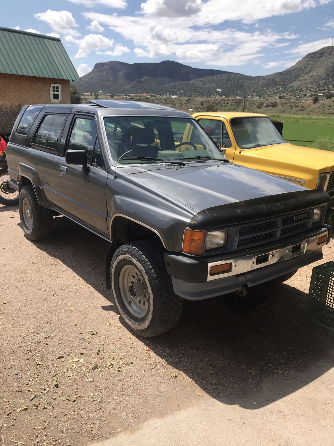

Alright,
ive seen this problem posted probably 30 times and investigated all that applied to me with no resolution.
Things I’ve done/checked:
New fuel pump
new distributor, cap, rotor, plugs, coil
checked timing 15 times (even 0 degrees and 5 degrees for efi)
Checked all fuses including under fuse block on fender
new fuel filter
new starter
jumped with multiple batteries
bypassed by jumping fp and +B
checked neutral switch
checked grounds and ensured good contact
New AFM (won’t start with unplugged either)
Igniter seems fine (cleaned with electrical cleaner)
Pulled oil pump to make sure the chain didn’t jump time (marks and silver link line up)
New air filter
It threw 2 codes once - egr and afm
wouldnt start with egr did a delete and no start.
Im basically out of ideas and money. I’m one foot from pulling it out into the desert and setting it on fire.
Any help welcome.
