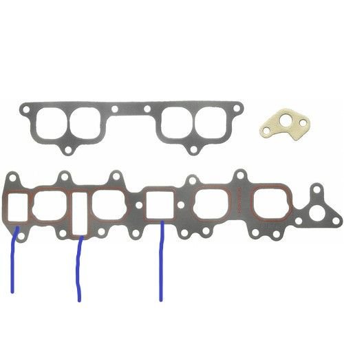

Bad lower intake gasket can cause coolant to enter the intake, and then out the exhaust.

Blue lines pointing at coolant ports on lower intake gasket.
