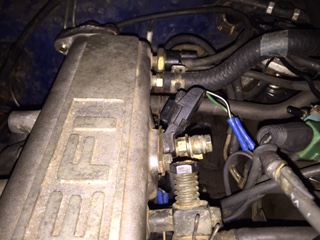

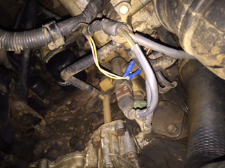

Next i looked into the cold start injector how ever i don't think this is what's making it not start because its started for awhile being hard to start but it might be. I pulled the CS injector out and tested it - no spray when cranking. so i hooked up a 12v supply to the injector and it sprays so the injector is fine. hooked the power through the wiring and injector works through there to. so that means the CS injector switch (brown two brown connection next to coolant temp sensor under intake) must not be working. I lost my mulimeter so tomorrow im getting a new one and checking the 30-40 volts between the switch.
My question is would the CS injector not working (switch) keep the truck from starting at all? outside temp only gets down to around 40 at night here in nor cal.

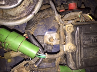

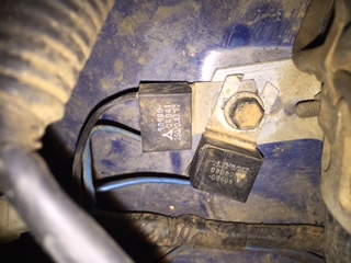

Also under the igniter and coil there are two black recistors bolted to one ground. one has two wires coming out of it and the other only has one. the one with one wire has snapped off. i have no idea what these are or know if they would keep the truck from starting. i can post pics of it if i figure out how to post them. (yes im a newbie)

CSI not spraying fuel would cause hard starting but should not prevent starting. (Some Info here)
