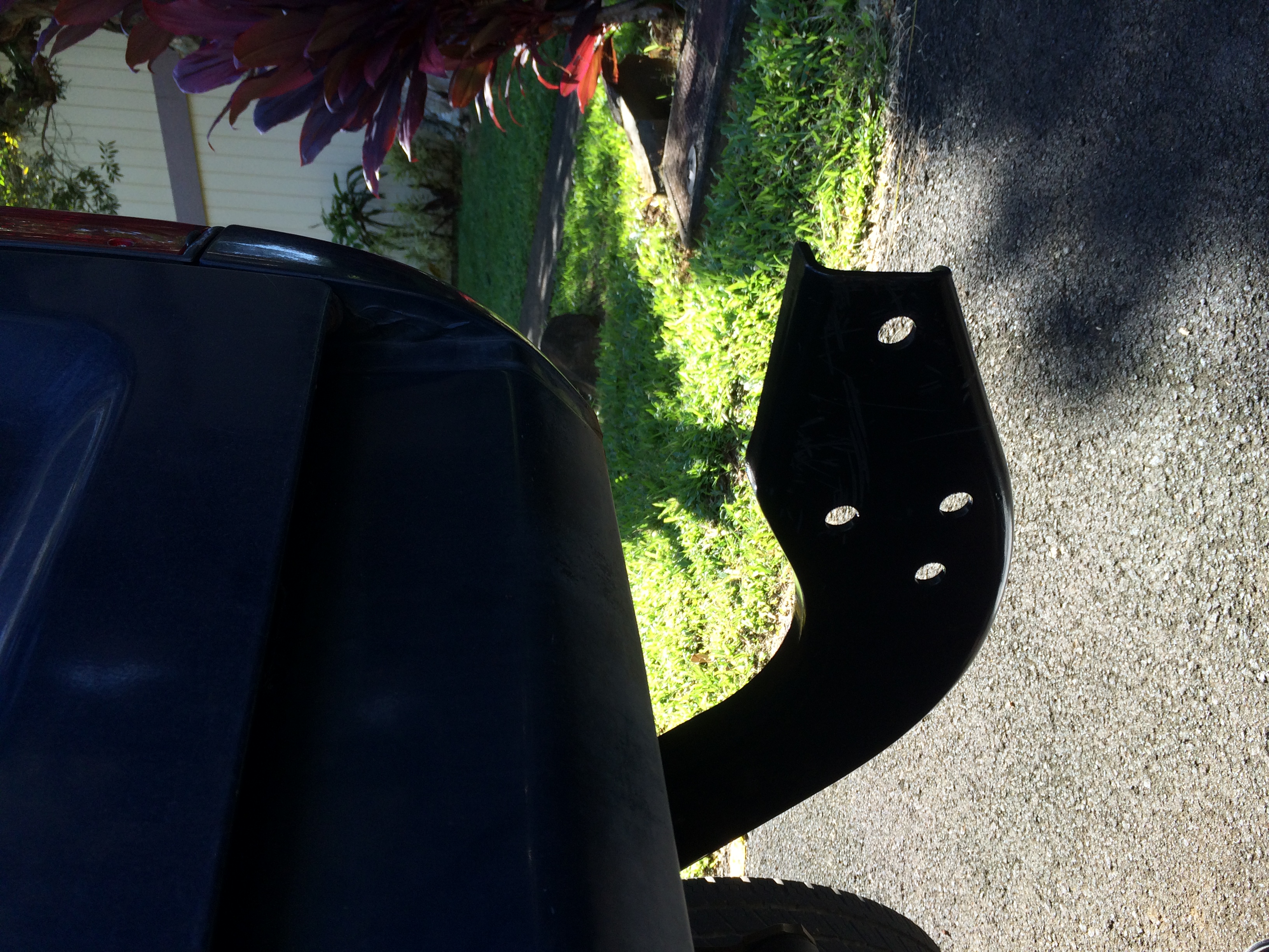

Hello all my first time posting and cannot find a solution. I purchased my pickup used 6 months ago and shipped it over to HI with me recently. The previous owner(s) installed a body lift kit and I am trying to determine the amount of lift. I am guessing 3" but would like to know exactly. What is the easiest way to do this? I am trying to install the rear bumper with standard bumper brackets (previous owner just did the body lift install and took out the stock bumper/mounting brackets). Due to the body lift I need to install the additional brackets to match the body lift. Thank you in advance for your help and I will post pictures of my truck tomorrow.

Easiest way on a BL to determine height is to measure the size of the spacer between the frame mount and body.

Edited: See pics below. Measured the two nylon spacers and they are 3". Bumper bracket that needs to be modded included.

Called Performance Accessories and asked about what they recommend for the 3" body kits they sell to get 3" lift on the rear bumper. The answer I got from the "R&D Guys" (sales people are wonderful) was this:
"This is a drill modification. You will need to drill the frame mount holes 1.5" above the original mounting holes for the bumper bracket and 1.5" on the bumper side of the bracket to account for the 3" lift."
Don't know what this guy was thinking but based on the width of the frame it appears there is not even close to enough space on the frame to drill those holes 1.5" above the original mounting hole location or to get the inside bolts/lock washers on. Going to see a welder today but anyone who has done this before that would like to chime in, or has ideas, please do so I would greatly appreciate it. Mahalo ke akua.

Regarding the rear bumper, if I recall correctly, you will need to fab something up your self to get the rear bumper to match the body lift. What ever you fab up it does not need to be strong as the bumper and brackets fold up like aluminum foil if the contact anything any way.
Bingo, ran to Kauai Welding today in Lihue and picked up a piece of 1/8" steel (6" x 19"). Ron Hadley in Kilauea (Uncle Ron master welder) will be cutting it down and drilling the 1/2" holes for the adapter plate. I should have pics tomorrow if it works. We decided on two 6" x 6" squares with 3.5" lift to bring the bumper up to 1" below the tailgate. Should work. Will make sure to post details for others to follow. Will be much easier to do this on the mainland for sure. Mahalos for the help guys.

Installed custom steel plates to raise the bumper the 3" needed. Not pretty but got me through safety for now. Will start researching how to properly lift my truck now.
