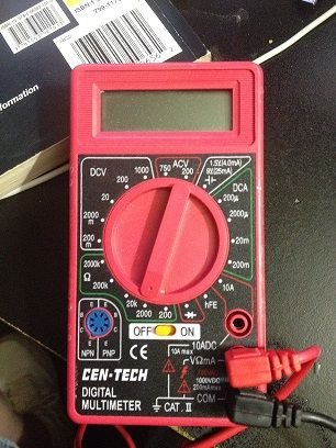

The picture of my meter is below, hopefully its the right kind, or at least will work. I will work on making sure the connections are good, should of thought of that, exhaustion is keeping the brain from firing on all cylinders... or that's my story and I'm sticking to it. After doing so I will post pics of the readings and we can go from there. It may be a couple of days before I get back to you. I work tomorrow and then the outlaws (in-laws) show up, joy.

For post 2, I don't know what settings to use. My options are different then the one shown in the post.

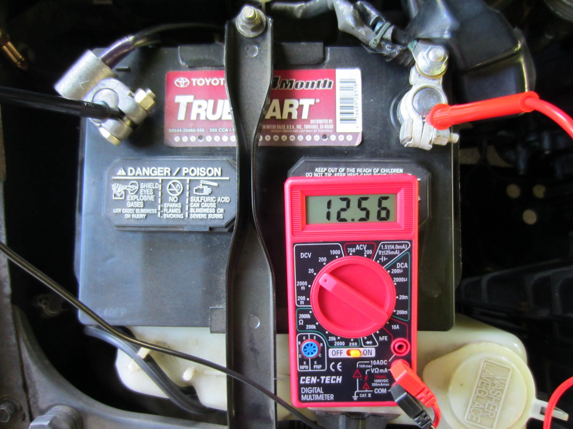

To test the battery voltage with your meter, set the big rotary switch to DCV 20 (Direct Current Voltage; on the 20 Volt scale). RAD4Runner has an auto-ranging multimeter so all he has to do is put the meter in DC volts.
Put the red lead on the positive side and the black lead on the negative side.
I have a few meters and happen to have picked up one like you have for free at Harbor Freight a while back with a coupon, so I took a picture of my battery with the meter:
To others reading this thread, please note that the picture below is an example of my battery and NOT of the Thread Starter/Original Poster.
Example of how to measure battery voltage. 12.56 volts on my battery.

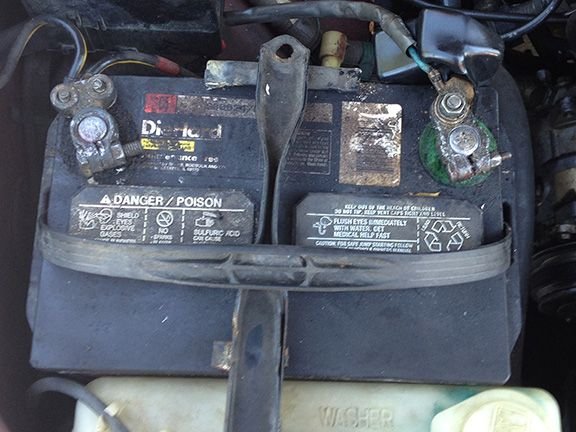

I put the meter on as shown in the picture. I get a reading of 12.43. I don't know if that is good or not.
Sorry Rad, in all the crap going on around here I missed your links. I'll do my best to follow your drawings/illustrations.
As for the pictures that someone asked for...
Battery, after cleaning posts and connectors...

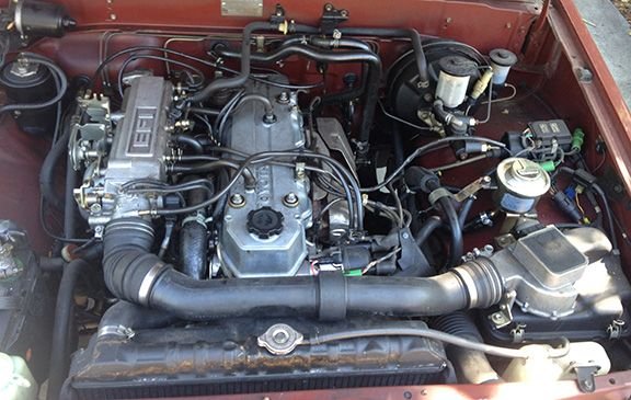

Probably useless, but for what its worth, here's a shot of the engine.

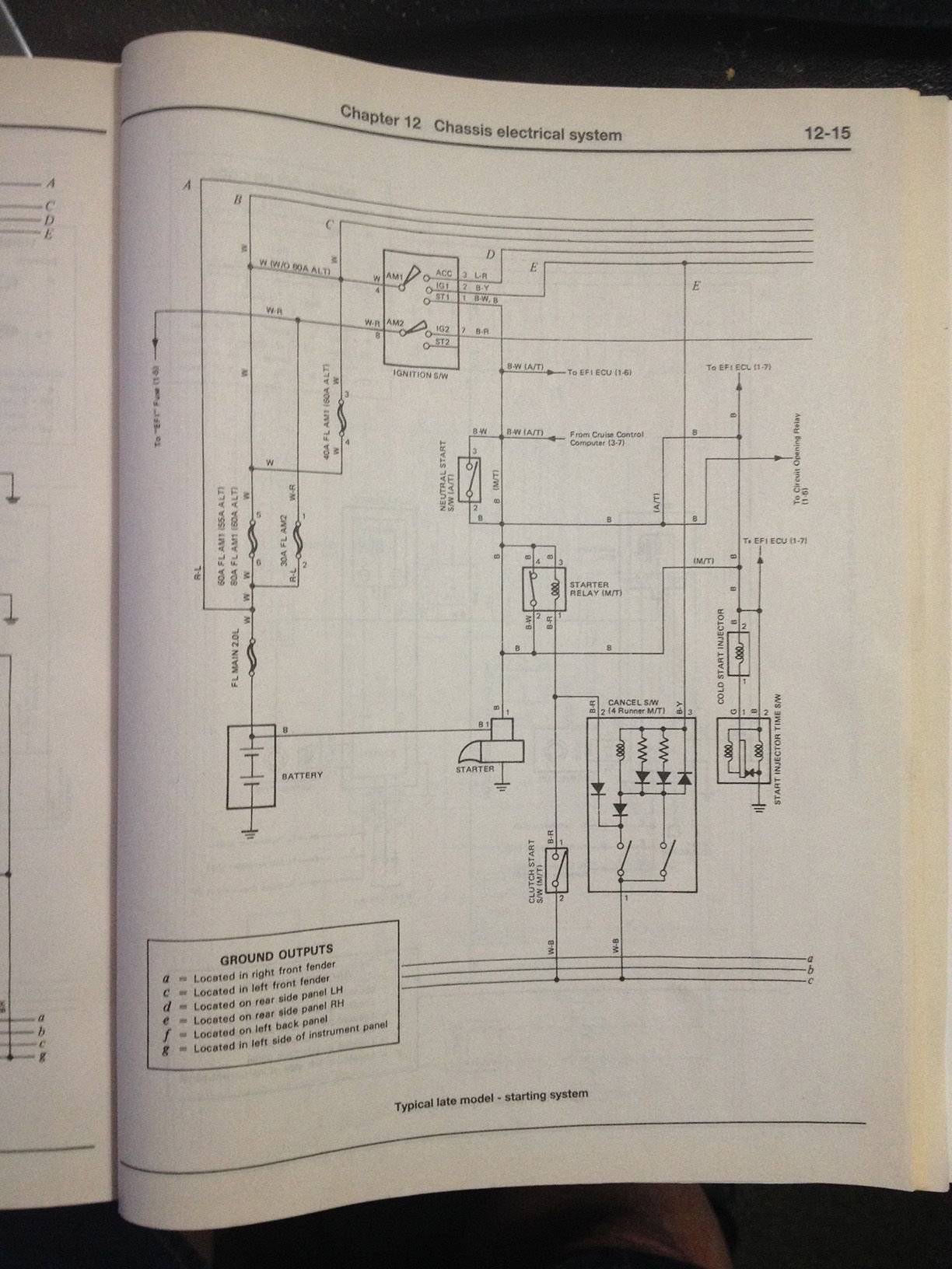

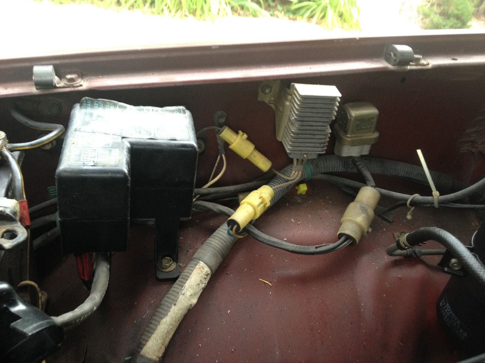

I found the starter relay, and the info in the Haynes manual about its wiring. See following pics.

In addition to the above post, can you tell me which side the starter solenoid will "likely" be on? This lame Haynes manual doesn't. Knowing if the damn thing in on the passenger side or the drivers will help save me some time.
