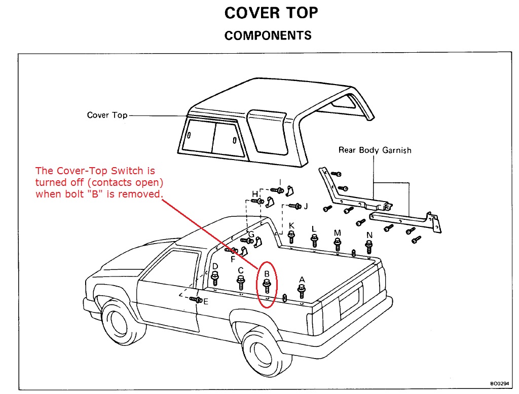

Straightforward to remove and replace the cap. Just don't forget to label the cover-off switch and its location here.

From RadRunners link so I can save it to my computer. Photobucket would not let me:
