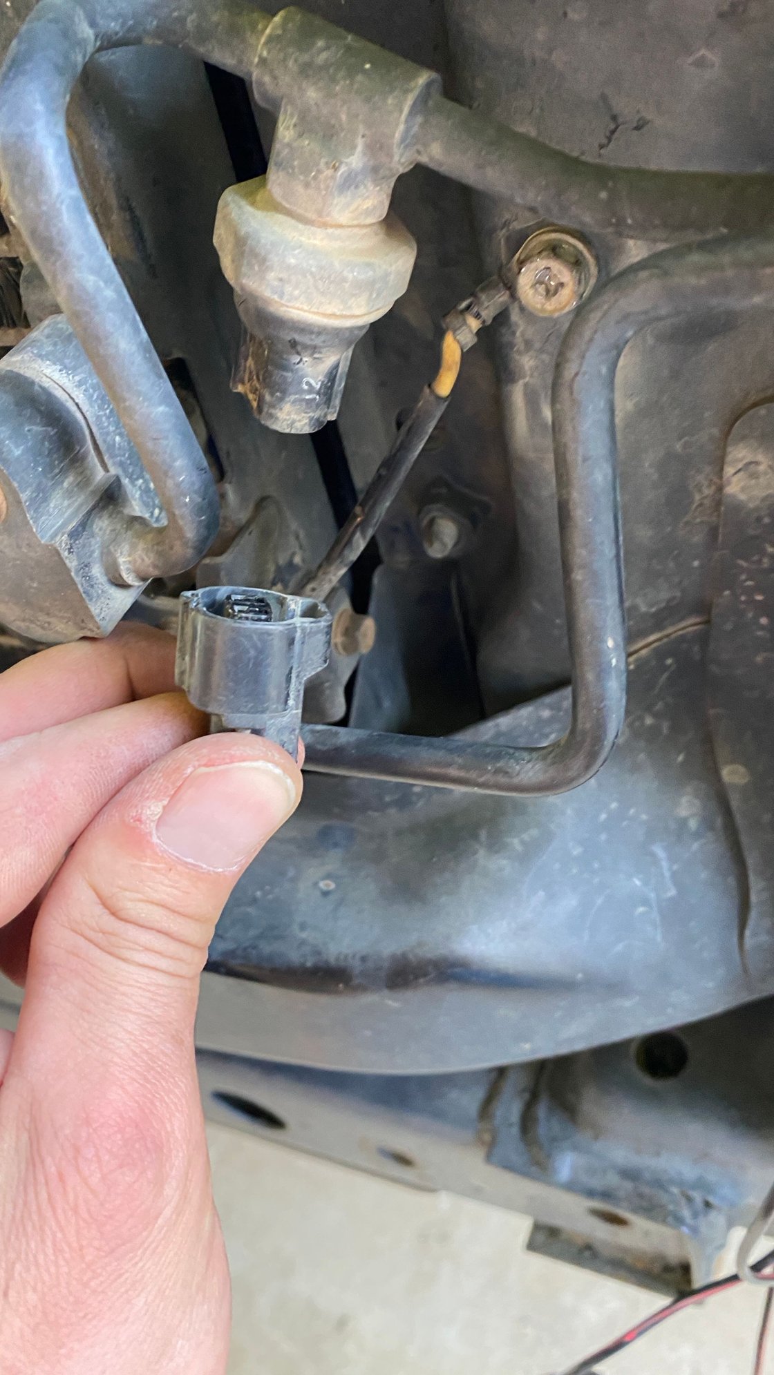

The clutch will always engage when I click the ac switch. Light turns on on the switch. Condenser fan runs when ac is engaged (I jumped the plug to make it always run when ac is on for slow crawling in the summer) so I think everything is getting power. I pulled the plug on what I think is the pressure switch and checked the voltage (13.8v) at the plug with ac clutch running at idle. The pressure switch (I think) says 15.0-ON 12.5-OFF so maybe this is my problem?
pic of plug and switch in question
