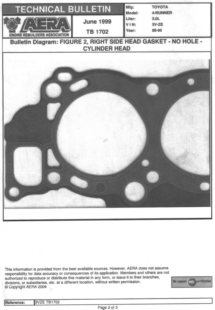

Originally Posted by fangz
hope you didnt use evergreen head gaskets , i hear they are upside down and block off a coolent passage between the head and block.
Upside down? Yes and no. Depends on who you ask. If you ask me, yes, they're upside down. But so are the latest OEM HGs.
Block off a coolant passage? Potentially, if you install them incorrectly. But that goes for any other brand of HG for this engine as well.
