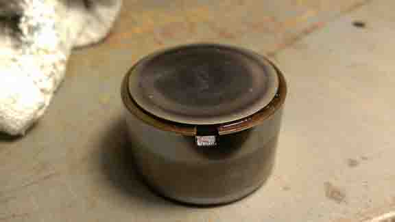

I had a pretty bad lifter tick for a while but lived with it figuring it was just the nature of this 3.slow. The other day i was on the freeway and all the sudden that tick turned into a hard knock. So bad, that i was sending the vibration through the pedals. Asking around, i was told that it could be the lifters. I have since removed the cam and will be replacing the lifters. My question is how do i remove the shim that is in the top of the lifter. I also noticed that the cam cap bearings were installed backwards and reverse sequence, should i reinstall those caps in the same reverse manner, or should i put them were they should go.

You pry them out. With whatever tool you've got, but a small flat head screwdriver works well. They fall out on their own when they're clean, and/or when there's no oil keeping them hydraulically "locked" to the lifters.

You can try pulling the shims out with a magnet (that's how I do it when adjusting the valves, with the cam in place), unless they're stuck. In your case, with the lifter already out, prying GENTLY with a small screwdriver as MudHippy suggests is probably easiest.

ok so i got the shims out. I really doubt these lifters are my problem. They looked good with no evidence of abnormal wear. I suspect this is a bigger problem than i'd like. Not sure i really want to spend the time and money into investigating it. Any places you guys might think i should start?
