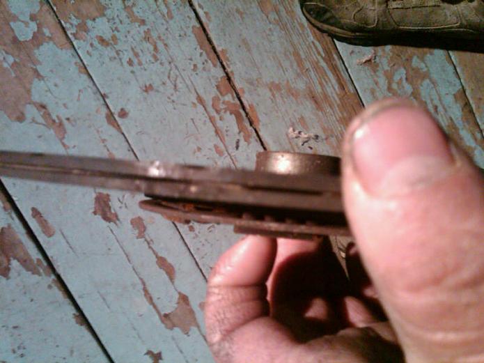

ok here is my clutch....is it good or what guys? this is the second one I have see in my life, the other was in worse condition.....

really need to see how thick the material is buddy, i'll take a pic of mine in just a minute to show ya.

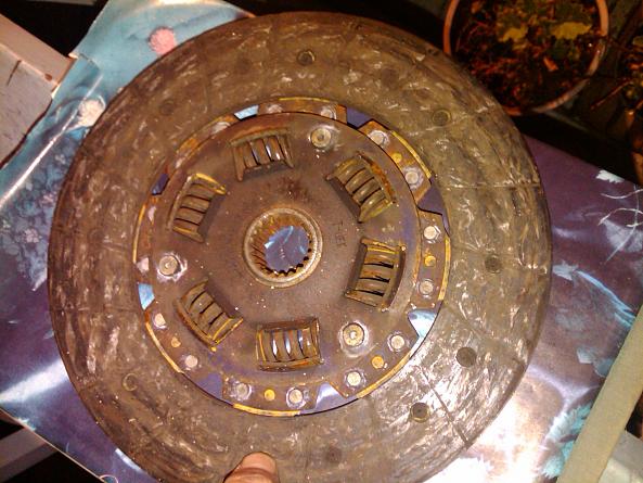

here is another one.

here's some pics guys
i'm about 99% sure that this truck blew the headgasket, then the previous owner had a top end rebuild..but didn't touch the bottom..then when it ate up the bearings because of the water left in the block, he decided to get rid of it.
the heads and water pump are all 3 BRAND SPANKIN NEW..i wanna just not replace the water pump...but i'm gonna do it right the first time...lol
i'm gonna talk with Southwestern and see if they will just look at the heads, i'm sure the heads are PERFECTLY fine..just need to be cleaned..i'm hoping it will knock off some of the price tag..$900 is cheap, but the less money i drop here, the more i can drop at other places for the rig (like some new tires )
well here's the pics lol
nice clutch huh
